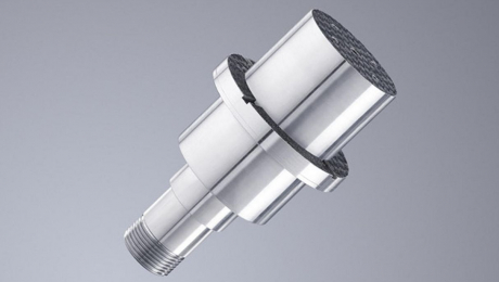

TRUMPF experts will be demonstrating how this works in practice using the example of a tool holder that attaches grinding discs in CNC grinding machines. This two-part component used to comprise several brazed cases – a potential weak point that negatively impacts service life. Now, a new additive manufacturing design strategy has eliminated this weak point: there is now a conventionally manufactured preform anchored in the tool holder, from which additive manufacturing is used to build up the top part, layer by layer, using powder deposition. Thanks to the design freedom afforded by the additive manufacturing technique, the component is lighter and can be produced using much less material. It also has geometrically optimized wall thickness for optimal distribution of pressure. By designing the component to suit additive manufacturing techniques, it does not require any support structures – which reduces post-processing time. This example goes to show that the challenge of additive techniques lies in thinking and designing with the technique in mind from the outset. In contrast to conventional techniques, it is not about observing limits that dictate the manufacturing process, but about overcoming the barriers in one’s own thinking. Now, form follows function. “With this new design freedom, users have to learn how best to complement their existing manufacturing processes, in the places where it makes sense. That’s where we come in,” says Grünauer.
