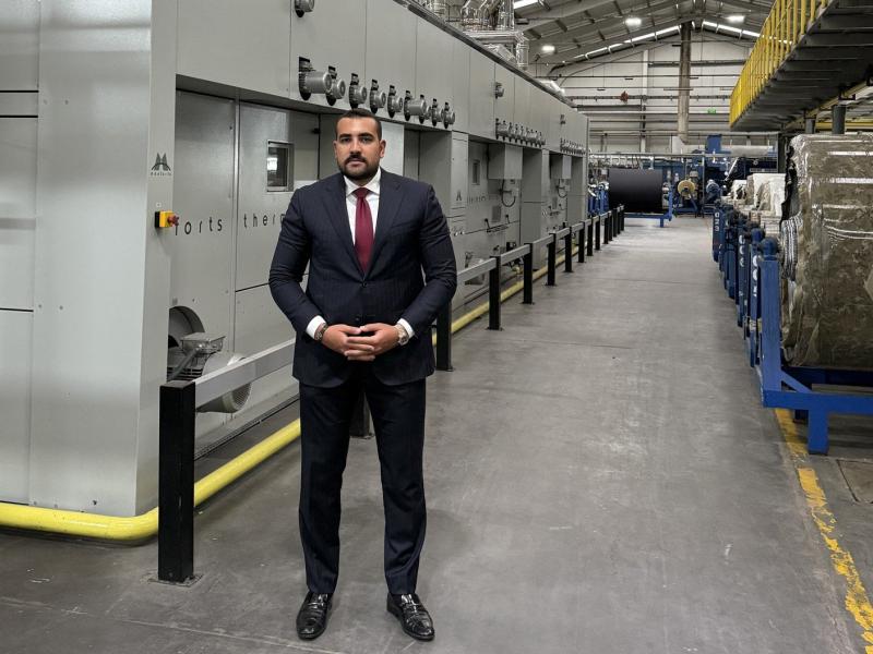

Altoteks owner Mehmet Ucar: “Monforts Thermex technology is one of the cornerstones of our expertise."
