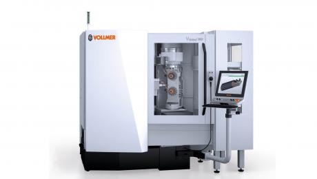

Tool manufacturers can now chose for greater momentum – that is to say higher speeds – when choosing the VOLLMER VGrind 360 grinding machine. The optional feature can increase the material removal rate in tool production. The sharpening specialist from Biberach has now integrated a simultaneous grinding wheel package and tool changes into the VGrind 360 and 340S to increase productivity and reduce non-productive times. VOLLMER continually applies its innovative strength to match sharpening machines to customer requirements in an even more targeted manner. In doing so, the company focuses on increasing productivity and precision for machining tools like drills, milling cutters and reamers.
VOLLMER increases speed by more than 40%
Sharpening specialist VOLLMER has increased the speed of the grinding spindle in the VGrind 360 tool grinding machine. The feature is available as an option for the bottom of the two vertically arranged spindles. Thanks to this unique vertical arrangement, the VGrind 360 is suitable for multi-level machining of different carbide tools like drills, milling cutters and reamers. And thanks to innovative ideas from VOLLMER's engineers, the speed of the bottom grinding spindle has been increased by more than 40%. This additional torque also makes it possible to significantly increase the material removal rate. Tool manufacturers will particularly benefit from the increased speed when it comes to grinding flutes in drills and milling cutters.
Simultaneous changes of grinding wheel and tool
Another optimization achieved by VOLLMER is an automation solution for the VGrind 360 and 340S grinding machines in combination with the HP160 pallet magazine. Users can load up to 900 tools with this loading system. VOLLMER has developed a new option for this automation solution, which makes it possible to change the grinding wheel package and tool simultaneously during the loading process. This reduces the non-productive time by around ten seconds for each tool. The benefits of this function are particularly apparent when more than two grinding wheel packages are required to machine a tool or when cycle times are short.
