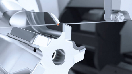

The beating heart of the new VPulse 500 is the VPulse EDM generator technology. This newly developed high-performance generator ensures higher stock removal rates or improved surface quality. As is the case for the previous QWD machines, the eroding wire for the VPulse 500 also functions as an electrode. The wire is guided close enough to the workpiece that a spark is generated between the electrode and the workpiece and removes the material from the PCD-tipped cutting edge. Thanks to the fine eroding wire, complex geometries and the smallest inner radii can be machined precisely – these structures are typical of multi-stage tools and bell-shaped tools.
