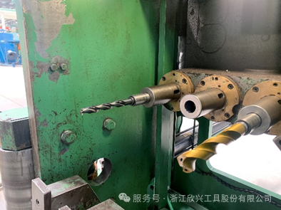

The processing equipment is PEDDINGHAUS three-dimensional multi-axis drill, model BDL1250/9B, CNC system: Siemens, spindle interface: MT4, cooling method: MQL oil mist cooling.

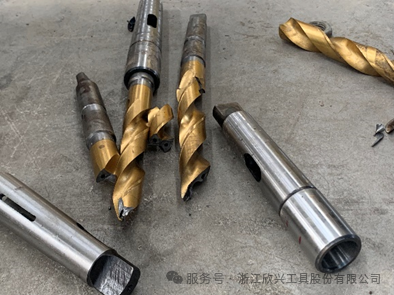

The tools currently used by the company are imported internally cooled twist drills, which have relatively high procurement costs, put a certain amount of pressure on the company's capital flow, and have a long supply cycle. In addition, in the actual processing process, drill bit breakage often occurs, which not only increases the tool loss cost, but also disrupts the continuity of the production process, causing a lot of trouble for the overall production efficiency and product quality control.
5    6
Don’t worry, CHTOOLS taper shank spiral groove Speed drill (S10 - GMT4 - 2605 - B) is here to help!
7    8
Processing data
Application
Original tool used
Imported internal cooling twist drill
Current products
CHTOOLS Taper Shank Speed Drill
Diameter
22
Diameter
22
Speed
270r/min
Speed
485r/min
Feed
87mm/min
Feed
122mm/min
Single hole time
14s
Single hole time
10s
Hole roughness
Hole roughness
Ra6.3
Hole size tolerance
Hole size tolerance
0.05mm
Number of holes
Short lifespan, frequent blade breakage
Number of holes
After 400 holes, it is still in use. The customer approves and stops testing.
Taking the Φ22 specification as an example, compared with imported twist drills, the rotation speed is increased from 270r/min to 485r/min, the feed is increased from 87mm/min to 122mm/min, the time for a single hole is sharply reduced from 14 seconds to 10 seconds, the hole roughness reaches Ra6.3, and the hole diameter tolerance is controlled at +0.05mm. The most amazing thing is the number of holes drilled. Imported twist drills break frequently, but the new S drill is still in use with 400 holes. The customer approved it and asked us to stop the test.
