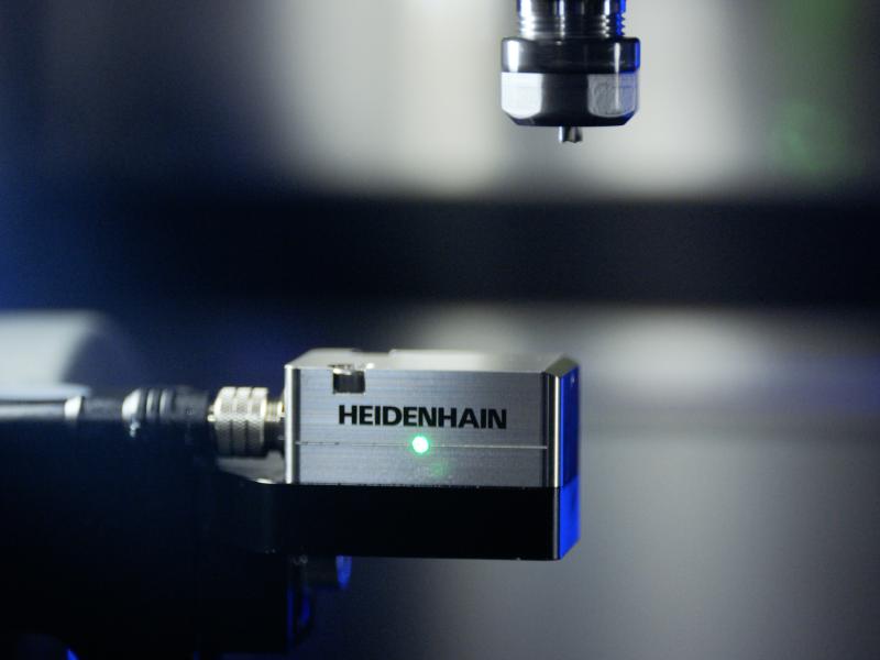

The TD 110 tool breakage detector from HEIDENHAIN: convenient in-process tool inspection
Automatically detect broken tools in automated processes and prevent damage during subsequent machining operations. The TD 110 increases process reliability without interrupting machining by detecting broken tools passing by on their way to or from the tool magazine, thereby preventing them from being used in the first place. This compact and robust sensor can be added to the workspace of any machine tool in close proximity to the machining table. Its signals are sent to the control via the touch-probe interface. The control then triggers a machine message, NC stop or a reaction defined by the user, such as a message to StateMonitor.
The TD 110 tool breakage detector inspects tools with a diameter of at least 0.4 mm and performs non-contact breakage detection starting with a length change of 2 mm. This happens inside the machine envelope with the spindle rotating at its operating speed. This considerably increases the process reliability and shaves up to six seconds off of every inspection compared with conventional laser systems. The time and cost benefits during tool changes are considerable. And because the TD 110 operates without compressed air, its carbon footprint is small. Installation is also easy thanks to the omission of air hoses and filter systems. All that’s needed instead is a single cable carrying both power and communication. And thanks to its inductive measurement technology, the TD 110 is maintenance-free.
