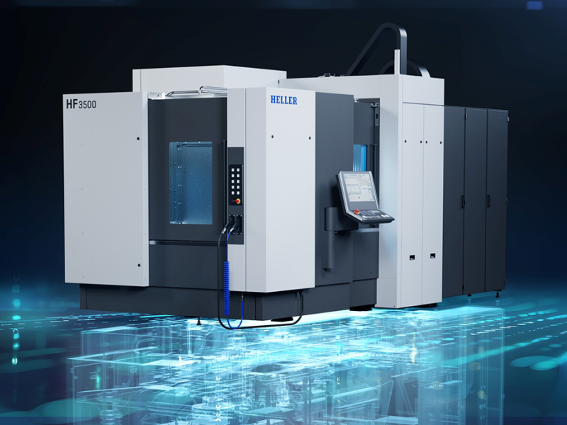

In addition to the digital highlights, HELLER will showcase its extensive engineering expertise at EMO 2025 with two 5-axis machining centres. The HF 3500 stands out thanks to its table kinematics featuring counter bearings as standard, as well as its high dynamics and short non-productive times. The PRO version of the machine on display at the trade fair stand features a Z-axis driven on both sides and comes equipped with all the necessary functions for perfect simultaneous machining. The high acceleration rates of 10 m/s2, axis speeds of 90 m/min and extremely short chip-to-chip times are also advantageous. HELLER’s high-performance spindle, featuring the proven zero-spindle system, ensures maximum productivity. Its combination of high torque and speed makes it ideal for a wide variety of applications.
