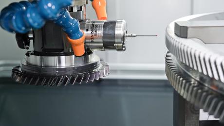

Measuring probe improves positional accuracy
A newly developed measuring probe now allows Liebherr-Verzahntechnik GmbH the possibility of precise corrective measurement in the gear shaping machine. The measuring probe sits directly on the tool spindle and is therefore in the same coordinate system as the pinion type cutter itself. This reduces inaccuracies which might arise due to a tool change or turning a workpiece, and leads to considerably higher quality and process reliability. In combination with the NC-controlled axes of the shaping machine, a measuring accuracy of a few micrometers is achieved. At the same time, the time and handling work when aligning the two gears to each other are reduced. User-friendly software guides you through all the process steps of the application.

Process steps
  • Shaping the upper gear
  • Cutter exchange and installation of the measuring probe
  • Measuring the position of gear and tooth space
  • Removal of the measuring probe and roughing the lower gear
  • Re-installation of the measuring probe and checking the positioning, with correction if necessary
  • Removal of the measuring probe and finishing the lower gear to the finish dimension
