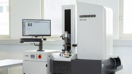

The Chinese Haoneng Group, a leading manufacturer in the field of vehicle transmission synchronization, is operating four WGT series inspection machines from Liebherr-Verzahntechnik GmbH. These ensure the quality of the components providing accurate and smooth gear shifting in vehicles.
Kempten (Germany), 07/2022 - Synchronizer rings are key components in manual, automatic and dual clutch transmissions. They help to align the different speeds of the gears to enable accurate and smooth gear shifting. The synchronization system has a significant effect on the efficiency and noise generation of the gearbox. For the gearboxes to be efficient, quiet and as smooth as possible, accurate and reliable measuring systems must ensure the manufacturing quality.
The Haoneng Group
One of the world’s leading manufacturers of components for the synchronization of vehicle transmissions is the Chinese Haoneng Group. The listed parent company Chengdu Haoneng Technology Co., Ltd., and its subsidiary companies together cover the entire manufacturing process of gearbox and synchronization systems. The four companies manufacture in the Chengdu, Chongqing and Luzhou sites in the Central Chinese province of Sichuan and are suppliers to well-known European automobile manufacturers and OEMs.
Chongqing Haoneng Xingfu Synchronizer Co., Ltd. specializes in synchronization systems for vehicles of the mid-range and luxury classes. The company had initially approached Liebherr regarding a high-quality inspection machine for the quality assurance of its products in 2014. Successful test series at the Liebherr site in Shanghai then convinced the customer to invest in a WGT 280 from Liebherr.
Highly accurate inspection machines from the WGT series
Liebherr's WGT series boasts impressive accuracy, user-friendliness and longevity. Lapped granite guides, air bearings, precision rotary tables and Renishaw probe systems ensure the mechanical precision of the machine. The Liebherr WGT measures any type of gear, gear cutting tools and other rotation-symmetrical workpieces – individually configured by Liebherr according to requirements. Each model fulfills the accuracy class of Group 1 according to VDI/VDE 2612/2613 and measures gears from a module of > 0.12 mm. The software LHInspect enables automatic correction of setting data. It supports the manufacturer neutral GDE interface for the exchange of geometric and measurement data between gear inspection machine and gear cutting machines and opens up the possibility of transferring further production and measurement data within the open manufacturing landscape LHOpenConnect by Liebherr.
