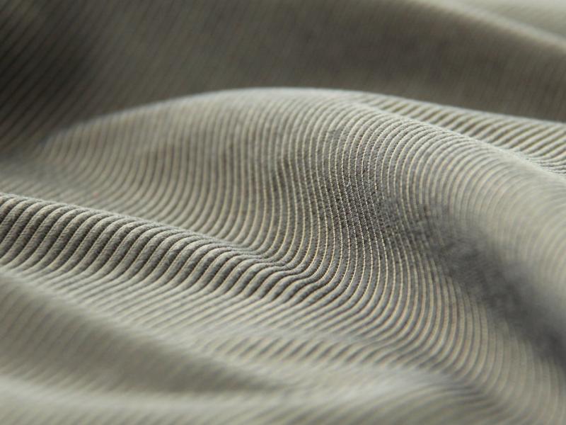

Corduroy reinvented: from classic stripes to turtle velvet
Warp knitted corduroy innovations are particularly exciting for home textile manufacturers. The distinctive ribbed structures are making a comeback – not only in fashion, but also in cushions, blankets and furniture covers. They are created by the interplay of threading and equal-length underlaps, which are cut and brushed after warp knitting.
This allows classic striped corduroy to be produced, as well as variants with different rib widths – through different threadings and underlap lengths – or faux fur effects for cosy blankets – through particularly long underlaps. The design of the underlap areas also offers scope for creativity, for example for corduroy patterns in turtle velvet style. For this design, reminiscent of a turtle shell, the underlaps are formed into square segments and arranged offset from each other along the sides.
The HKS 3-M is particularly suitable for the flexible and efficient production of these corduroy articles. This high-performance warp knitting machine is one of the most flexible in the KARL MAYER product portfolio. It also produces velour and cuddly blankets, terry toweling and cleaning articles, as well as textiles for automotive interiors, sports and outerwear, mosquito nets, shoe fabrics and coating carriers.
