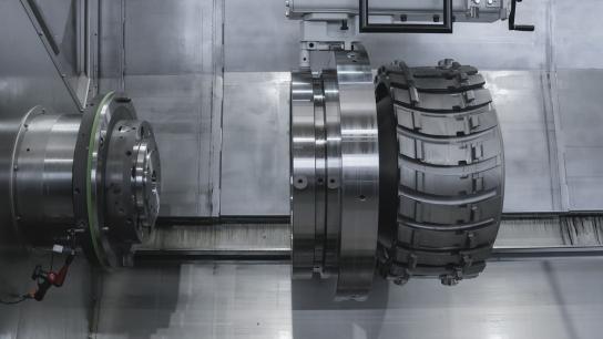

The innovative WFL solution for the horizontal complete machining of chuck parts
Based on a high-precision, rigid and fully variable clamping system. Clamping devices such as workpiece-specific pallets, power chucks, clamping mandrels and collet chucks can be manually or automatically changed as required. With this solution, the workpiece is clamped and aligned on the clamping pallet on a vertical external clamping table or setup station. The setup station is equipped with exactly the same interface as the headstock in the form of a stable short taper mounting with a high degree of repeat accuracy. The clamping device including the workpiece can be changed automatically. Alternatively, when using power chucks, the workpieces can be changed directly into the chuck by the robot and the workpieces can also be transferred to the counter spindle, thus enabling full 6-sided machining.
This automation solution from WFL enables extremely stable clamping with a high degree of repeat accuracy. This concept also practically eliminates the need for clamping device setup times in the machine.
The benefits are clear – quick and, above all, precise changing of the equipment including the workpiece in the machine.
The advantages of the horizontal machining of power chucks at a glance
- Simple and efficient clamping of workpieces
- Higher efficiency thanks to setup in parallel to machining time
- Maximum flexibility thanks to optimum preparation outside the machine (parts can be prepared in parallel to machining time and stored in temporary storage)
- Optimum chip flow thanks to horizontal machining
- Higher productivity thanks to 4-axis machining with a turning-boring-milling unit and tool turret or a single tool holder on the lower system
- When the chuck parts are transferred to the counter spindle, machining is possible on the rear
- Flexible change between pallets and hydraulic power chucks
- Option to use the prismatic tool system on virtually all WFL machines, e.g. when using special tools or heavy internal machining tools
Depending on the machine model, additional tool carriers such as turrets are used in addition to the turning-drilling-milling unit. This second processing unit is located on the lower system. Machining can therefore take place simultaneously on both turning spindles or 4-axis on one spindle at a time. A special feature of all WFL machines is the integrated measuring probe, which is used for both horizontal and vertical machining and ensures advantages in the quality of the components.
The special characteristic of the M20 MILLTURN when it comes to machining chuck parts
With the new M20 MILLTURN, the lower system also features a turning-machining unit with B-axis and automatic tool change. Particularly when metal-cutting demanding materials (stainless steel, titanium, HRSA, etc.) with a high degree of tool wear, it is therefore possible to work fully automatically without interruption for very long periods of time. Thanks to the external tool magazine, a larger tool stock is available. The unproductive downtime required in order to retrofit the turret tools is completely eliminated.
A production increase of up to 80% can thereby be achieved during turning. The combination of these advantages results in a significant increase in productivity when machining chuck parts. External setup and alignment of the workpieces on the setup station, automatic change of clamping devices and workpieces by robot, significant reduction in machining time thanks to the second single tool holder and no downtimes for setting up the workpieces or tools (EWT) below.
