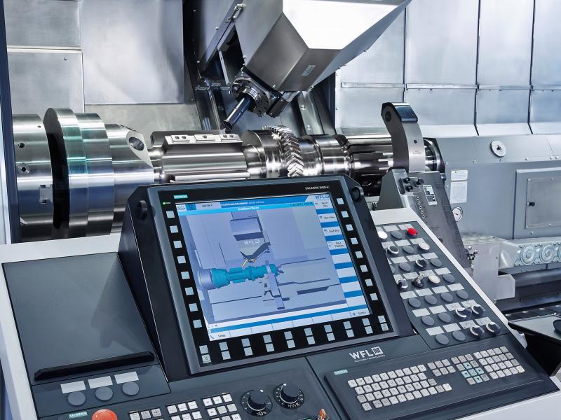

By optimising the machining process and ensuring faults are corrected early, users can expect a significant reduction in the risk of collisions and rejects, while also minimising unproductive downtimes. This unlocks new potential and offers clear competitive advantages.
CrashGuard Studio is being continuously developed. The customers themselves have an important role to play here, as their feedback enables the programmers to optimise and further develop the software. Our customers' experiences, ideas and suggestions are sometimes the key that allows us to continuously improve the software and match it precisely to their needs. Product feedback can be sent as long as a valid maintenance service contract is in place. If problems arise, users will receive rapid assistance. As well as updates based on customer feedback, the software is also adapted to new technological conditions in order to keep pace with technical developments.
