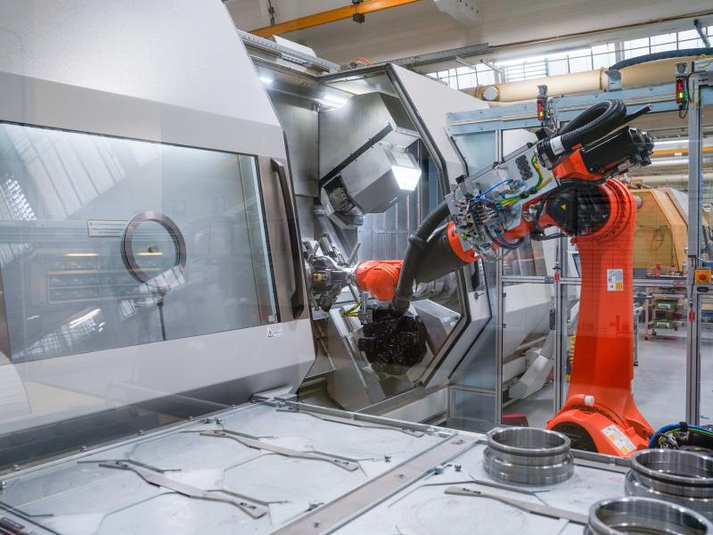

Schaeffler Aerospace has been using WFL MILLTURN machines to meet these requirements since 2006. Prior to the purchase of these machines, many machining steps were carried out separately on classic 2-axis turning and 5-axis milling machines. Thanks to the MILLTURN, the company was able to achieve process-integrated complete machining for the first time. Machining steps such as turning, milling, drilling or measuring are now carried out on a single system, which reduces set-up times, prevents reclamping errors and improves the machining quality. In the case of average batch sizes between 15 and 50 pieces, the number of set-up processes plays a decisive role. "One of the particular advantages of the MILLTURN machines is the integrated B-axis. Thanks to swivelling tool positioning, complex component geometries can be created with a small number of tools in just one clamping operation," explains Thomas Memmel, Head of Technology Development at Schaeffler Aerospace.

The process reliability is supported by state-of-the-art measurement technology within the M50 MILLTURN, such as integrated scanning measuring probes, which enable exact process monitoring during machining. The tolerances required are in the range of 20 µm for turning and up to 10 µm for milling – values which can only be achieved with consistent process control.

The company is also making headway in regard to automation. Thanks to robot-assisted loading and a largely unmanned third shift – including at the weekend – the company is able to compensate for shortages in skilled workers and reduce costs. The challenge lies in the sensitivity and high quality of the components; loading errors must be reliably detected and prevented. This requires intelligent process monitoring using sophisticated sensor systems, which have been developed by WFL itself.
