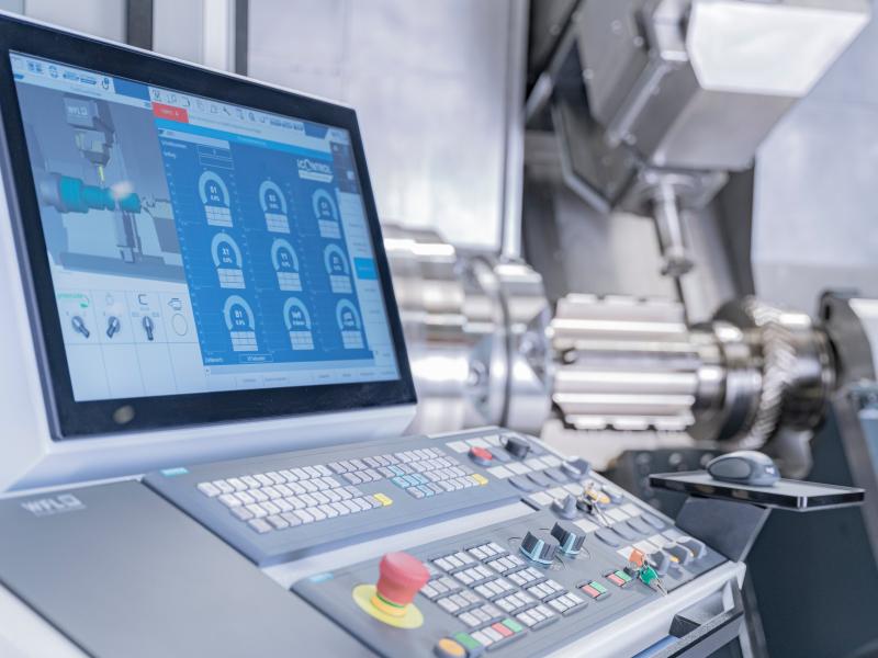

Thanks to innovative in-process measurements, complex measuring tasks can be mastered with simple programming. This enables maximum manufacturing precision to also be achieved with the tightest dimensional and positional tolerances. Analyses can be carried out and measuring protocols can be created at any time.
Another key advantage can be found in regard to the coolant pressure. Thanks to targeted chip breakage optimisation and the use of high-pressure coolant (HPC) of up to 150 bar, the machining costs can be noticeably reduced. What's more, ultra-high pressure coolant (UHPC) ensures even greater efficiency, lower tool costs and improved process reliability during machining.
Workpiece transfer is also optimal with the M70-G MILLTURN counter spindle machine. The counter spindle with tailstock and synchronous spindle function combined with the powerful motor spindle and a drive ensure reliable machining processes and maximum machining performance.
Intelligent tool management makes operation even easier. It offers convenient software functions, straightforward and logical menu navigation along with automatic tool correctors, which are automatically converted by the control system and ensure efficient operation.
