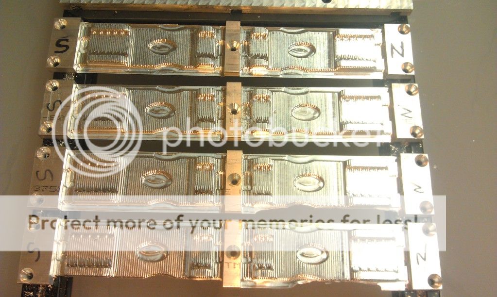

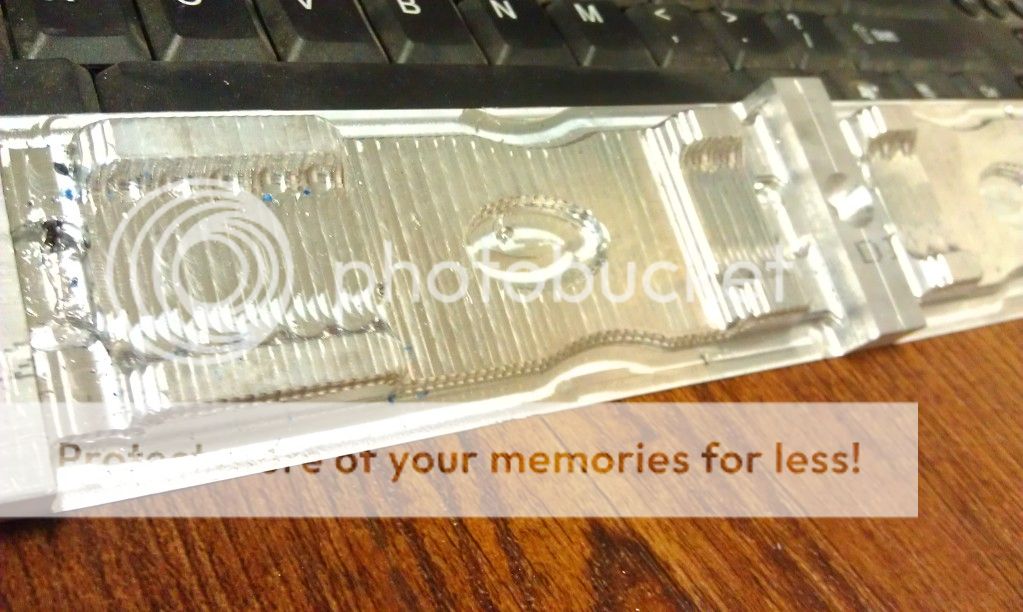

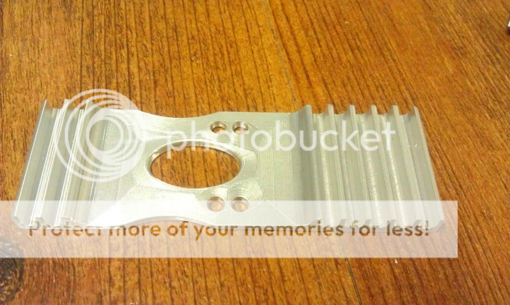

    Again if you have never owned one you don't know what they are capable of. All the aluminum in these pics were milled with my lowly TM 2x2. Now please if you have info on how to help me build the best Z axis I can I appreciate it very much. If you want to tell me my machine won't do what I want it to do keep it to yourself because it already has and it's the only one I have at this time. Like I said earlier I NEED this one to help me build my next one.

    Considering those parts have not had a finish path run yet and they are the first things I have ever milled they look pretty DAMN good. The Z axis IS the problem it's the biggest problem my machine has. I have not run a finish path on the parts because I need a need a NEW Z AXIS. Now kindly leave my thread alone unless you are going to help me build THE BEST Z AXIS I can.

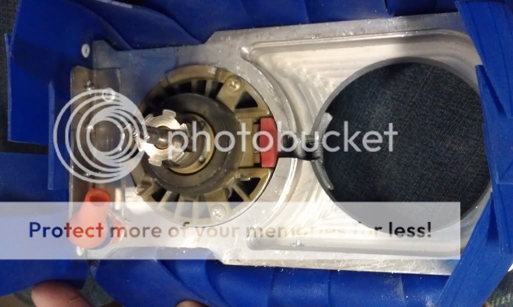

    Just for reference here is the Z axis I was using. There are no support bearings. It only has a teflon strip to keep it tight. The unit also uses fine thread screw not ball screw or acme thread. The unit is only capable of 15-18 ipm. It's a good item if your doing 2.5D cutting in wood. I am going to be doing 3d cuts in wood and aluminum. I will also be building the parts for my aluminum dedicated machine in my other thread in this section. I need the best unit I can get so I can erase that variable from my list. The way you talk makes it sound like I should just throw any old pos z axis on my machine because you wouldn't use it for routing anyway. I don't work that way. if I'm going to go through the trouble of building or changing something it's going to be the best I can do. Oh and FYI I'm in the process of building a 63"x61" table for my new 4' gantry. I'm going to be putting linear rails on this table along with a rack an pinion system to drive my new gantry and i'll be selling my 2' tm rails. Not only will I have a much better gantry but I will have a proper setup to route anything I want to so...............I need advice on how to build the BEST Z axis I can.
