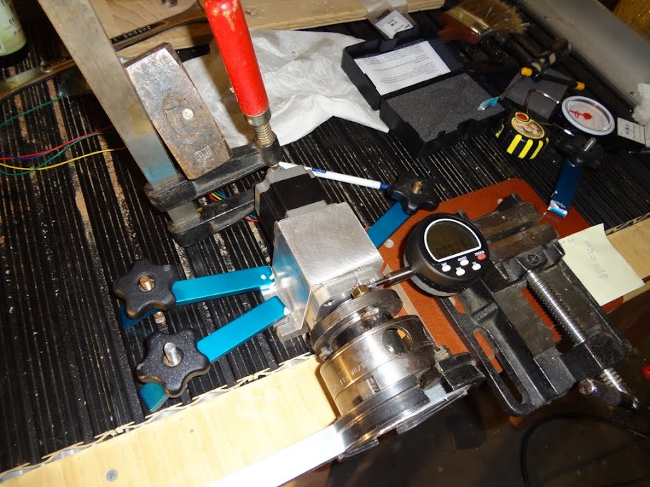

    In the meantime I received the Chinese harmonic drive clone (I picked 1:50) and started playing. Actually, it looks pretty nice, with a milled aluminum gearbox housing and a smaller (but likely very sufficient) NEMA23 stepper attached. It must be quite efficient, since it is not self-locking. Even with the stepper attached, it can be rotated from the chuck side. This would be impossible with a worm drive. Compared to the Sherline rotary table that I intended to use as 4th axis this gadget is easier to integrate (just need to strap onto the router table).
    First I removed the 3-jaw metalworking chuck that comes with it (Banduramaker told me later that the seller would ship without chuck for less money but I did no know or ask, duh) and attached a Oneway Talon 4-jaw chuck. Not trivial but possible with some welding and lathe work on the chuck adapter.
    I am in the process of fabricating a mounting base and a tailstock but in the meantime I did some rigidity measurements. This is quite interesting. Up to 2 or 3 ft-lbs of torque there is no backlash to speak of and the stiffness is approx. 0.045 degrees per ft/lbs of torque. As an example: For a work piece of 4" diameter and a machining force of 10 pounds circumferentially, the displacement would be about 2.5/1000". I think that is quite adequate for a wood router.
    I noticed when applying higher torque, there is a kind of "variable backlash" that may be related to the harmonic drives splines beginning to ride up on the internal gear. But I am not really familiar with harmonic drives to say and I suppose with our hobby equipment that load is unlikely.
    Here some pics. I will keep building the hardware and need to modify my electronics box but once I get it all going I will post again with results.

    I installed the harmonic drive and a tailstock and machined my first part (pic below). I can definitely say this drive does the job, has no backlash and (what I did not realize before) allows for easy zeroing of the bit to the rotation axis due to its square body. More pictures here. Obviously I don't know how durable this is, e.g. compared with a worm drive rotary table.
    What about when rotary stop, then there is force from top due to starting milling, the material will move down a bit. So machining is not precise! What you do? Can you show me pic of the harmonic drive. Will you put a brake mechanism on it to better lock, do you think so?

    Quote Originally Posted by asuratman View Post
    JerryBurks,
    Sorry if that was misleading...I meant the gearbox is not self locking while the stepper motor is not connected. When the machine is running and the stepper is under power it is impossible to turn the chuck. Therefore no brake is required.

    Quote Originally Posted by jobjiale205 View Post
    I've never used a 4th axis so I don't know how this works practically but, apparently the worry is that the backlash will cause the part to move depending on whether you're plunging, climb cutting, conventional cutting and whether or not you're using upcut or downcut bits etc. Because I'll be using this 4th primarily for indexing, a swing of .007" across the part would not be acceptable to what I'm doing.
    If you go back to the beginning of this thread, you see this concern was behind the thread starter's (BanduraMaker) interest in this gearbox. Worm drive rotaries have significant backlash and the question was if this gadget would be better.
    A few posts down you can see what I actually measured as backlash and I found when the machining forces are moderate (up to 3 ft-lbs torque on the chuck) the backlash is not really measurable. The equivalent force on my blanks (up to 6" wide) would be over 10 pounds which is a bit more than you normally will see in 3D mode with a 1/4" or 1/8" bit. If you exceed such forces I would not worry about accuracy but if the blank would rip out of the chuck and center or if protruding details will be snapped off.
    Now, if you have very large parts hanging out 12 inches from the axis and use a 1/2" bit at 200ipm that little gearbox would probably not be up to the job.
