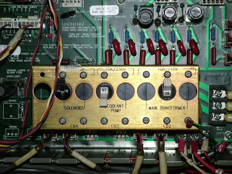

    Found the coolant plug on the i/o board which in turn runs to a 110 volt twist lock plug on the left of the electrical cabinet. When M8 is entered, LED coolant light is lit but no voltage at the coolant plug. When I turn the switch on this panel (see attached pic) there is constant voltage at the coolant plug-M9 or M8 have no effect.

    Well, there's part of your problem. That's not a switch, it's a circuit breaker and it's supposed to be on all the time.
    Turn that on and start tracing again. Did they use a relay on the older I/O boards?

    Just as Donkey says, that is a circuit breaker, and must be left on all the time.
    Also, the voltage will always be there on the output on the i/o pcb. Apparently when M8 is commanded, the voltage is switched to earth - which makes the pump run. I would suggest getting a pump and trying it.

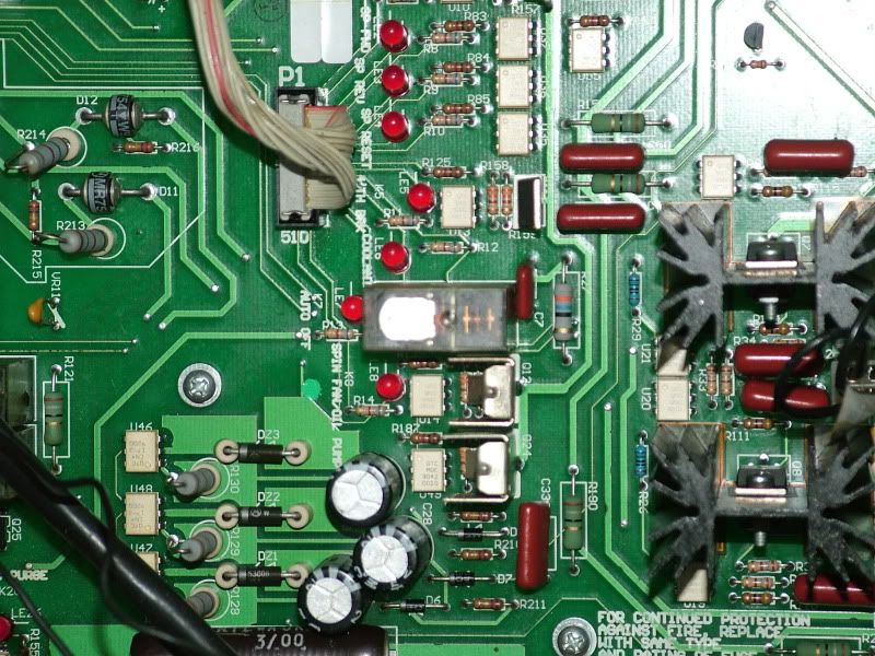

    DUHHH!! on the circuit breaker. Hooked a pump up but stays on all the time. Is the relay that is just below the LED to signal the pump is on; the relay for the coolant pump?

    the small relay just below the led switches a larger contactor (relay) on and off that handles the pump, I dont know about the older Haas boards but both the newer ones i have there are screw terminals present right above the relay , the contactor it switches will not be located on the circuit board but mounted in the cabinet.

    The only contactor I can find is the one for the spindle drive unless I am overlooking it which is quite possible. I have attached pics of the relay under the LED for the coolant pump as well as the pics of the cabinet.
