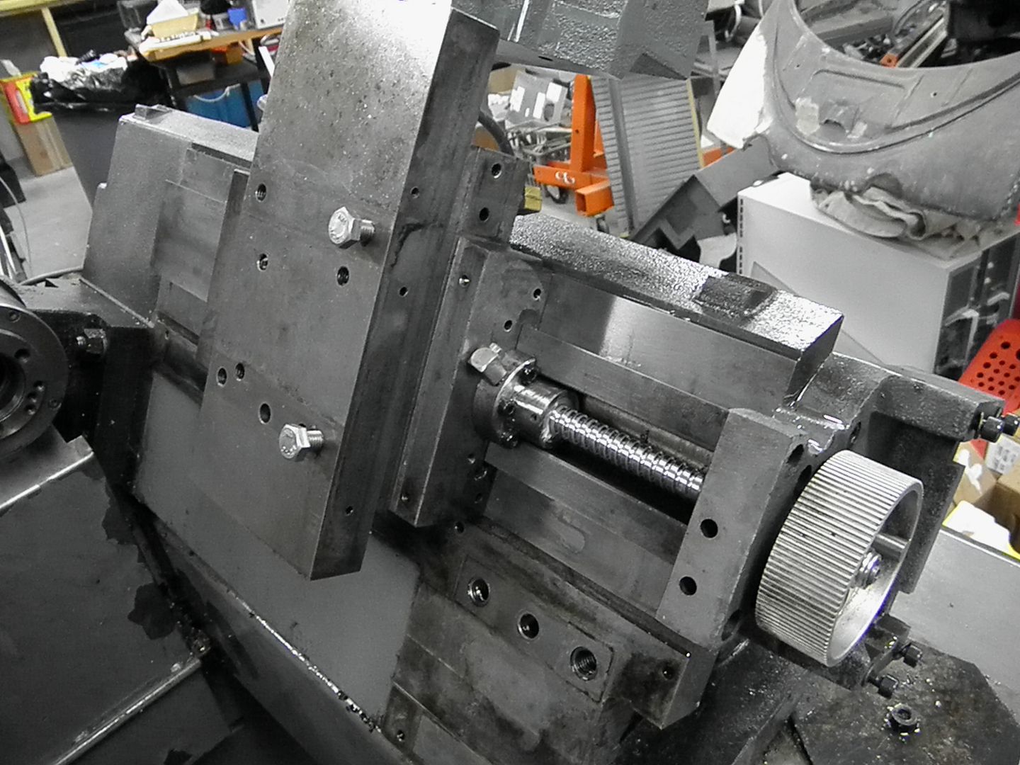

    Anyway, I took apart and cleaned both slides. I removed both ball screws and soaked them over night in carb clearner, then into an ultrasonic cleaner. Afterwards a new filling of grease. I also replaced the bearings at the end of the screw..by the pulley. These are 608Z bearings. I bought a pack of 10 bearings from a skateboard dealer on ebay for about $8.00 and they were ABEC-7 bearings
    Here's a pic of the slides re-installed.

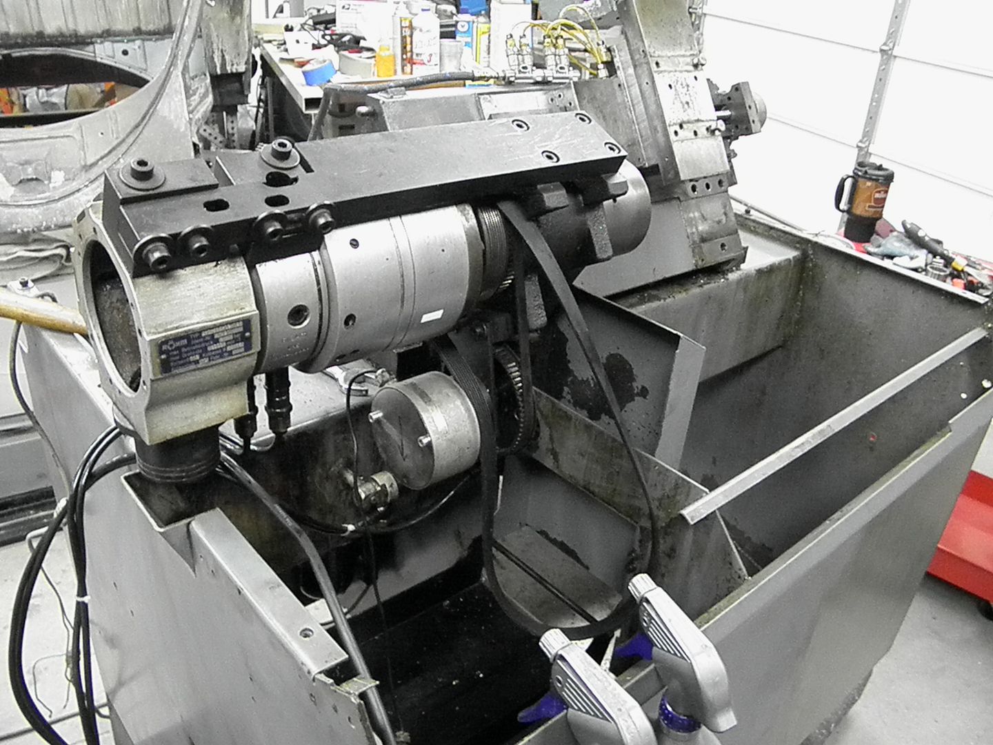

    One of the main reasons for getting this lathe, other that the great price, was the parts catcher and the through spindle...which the 120p doesn't have.
    Here's the parts catcher....
    and the spindle.... i might make some type of bar feeder for it

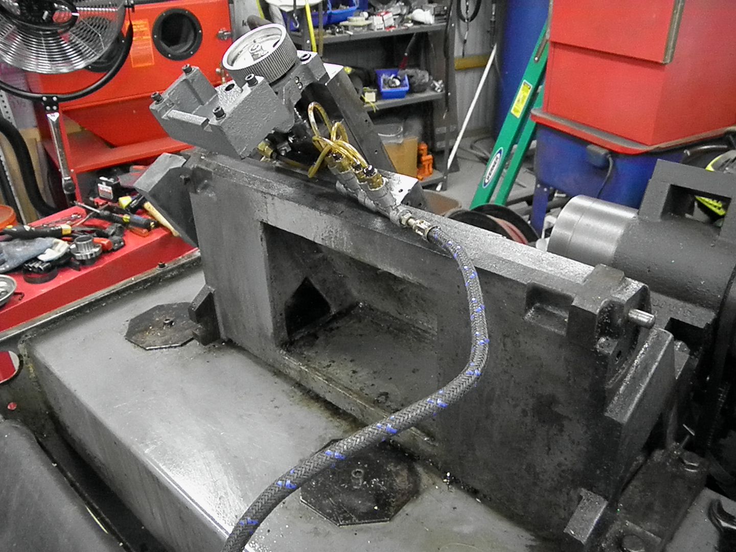

    Hello Folks, Things were a bit hectic at my day job, but, I found some time to work on the lathe. I tested the chuck, tail stock and parts catcher and all appear to working fine.
    I also mounted my limit switches. I'm only using two proximity switches for the X-Z limits and as well as for homing...to save on cost and the amount of wiring needed. I've done this to my other lathe and it worked out well.....Here are some pics of the setup.....

    The proximity switches will be powered by 24 volts, thus , I'll need something like a 25K ohm resistor in series at the input to the breakout board.
    I'm hoping to install the steppers, spindle motor and remaining wiring this week. Maybe, start installing the sheet metal next weekend

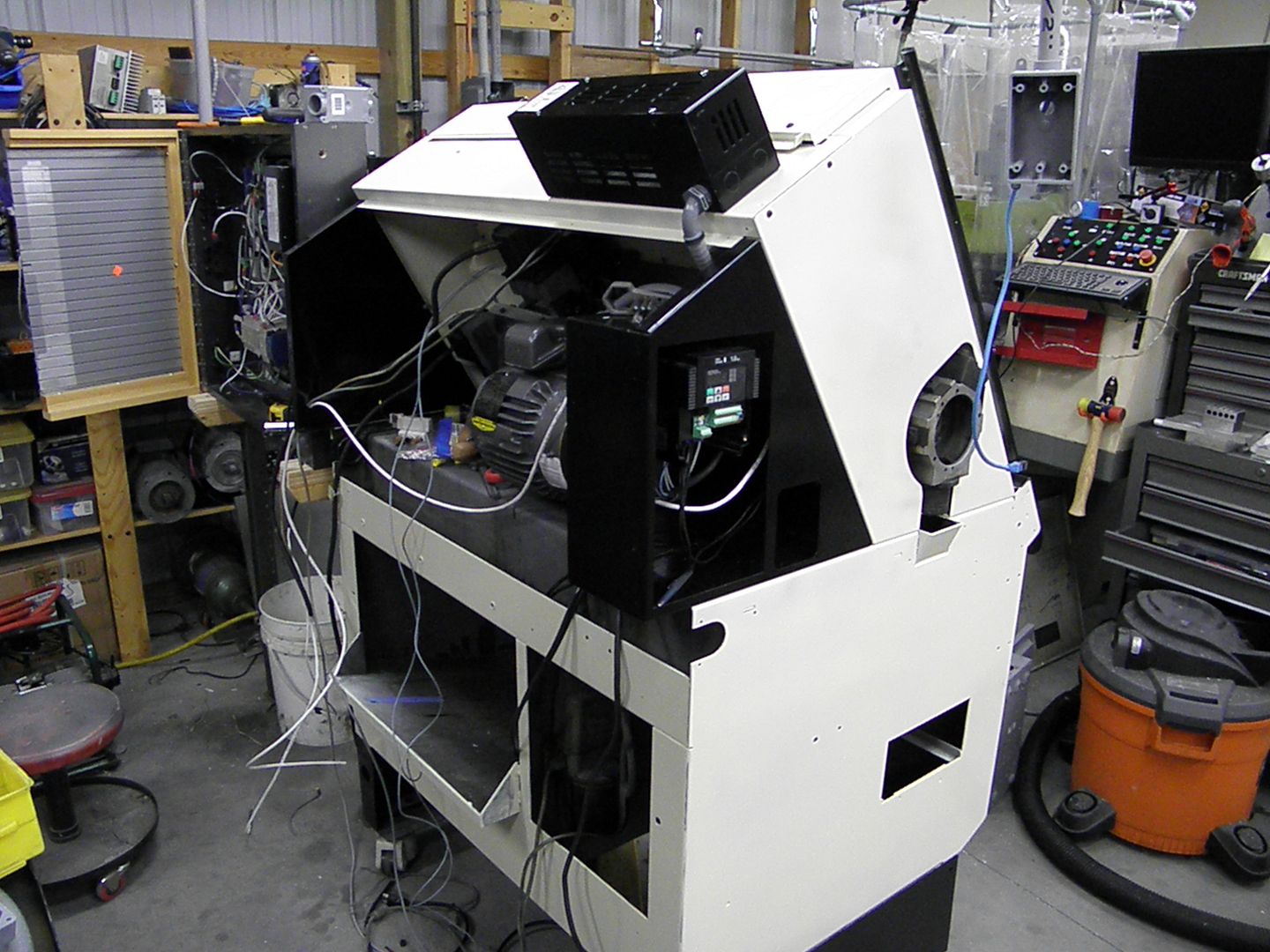

    Hello folks, here's the latest update on the Emco. I have cleaned and painted the lathe and installed all the electrical things I should have everything wired in the next couple days......... I'm hoping to make some chips by the weekend
    Here's what it looks like so far....

    I saw some kind of box above VFD, is that breaking resistor or pneumatic door closer, I did not get that with my machine. And why you removed tailstock?

    Hello Marko, That black box does hide a braking resistor As for the tailstock, I really don't use one with what I'm going to machine and figured it would be a chip collector
    I bought the wheels on Ebay and welded them on. I couldn't be happier with how they work...moving the lathe is so nice....makes cleaning under the machine easier.

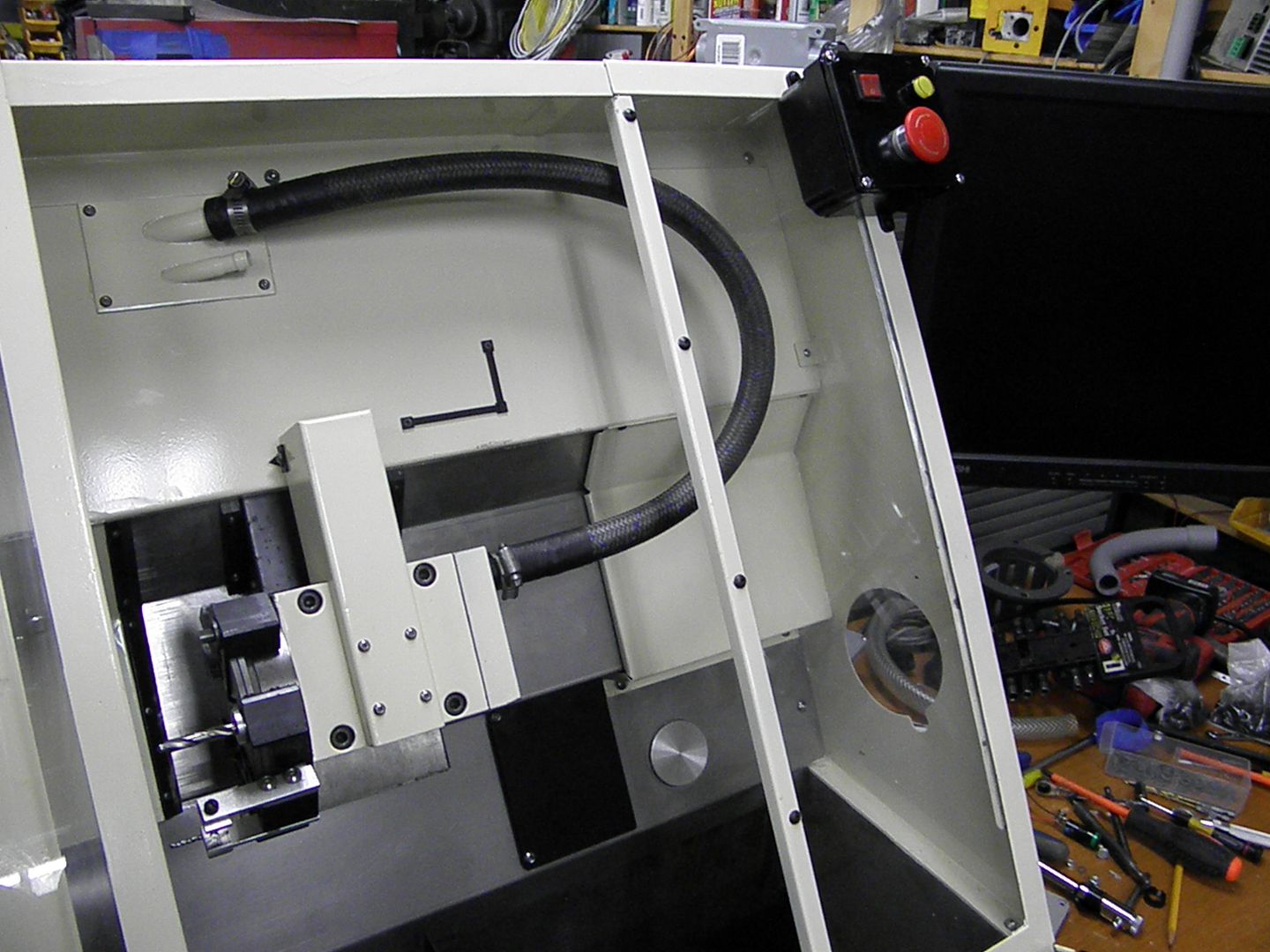

    Hello folks, I made some minor changes to the lathe...well not really the lathe. I re-mounted the monitor. I originally had it mounted to the control box, but, that limited the monitors movement. I re-positioned it to the side of the lathe. Btw, these wall mounts can be had on ebay for about $12.00. I also added a keyboard tray. Nothing fancy, just some scrap 1/2" thin wall and a couple pieces of 3/4" plywood.
    The tray is made up of two pieces of 3/4" plywood. The top piece is cutout to fit the keyboard. The bottom piece is attached with glue and short screws. Then the tray is painted to match the lathe The tray is attached to the thin wall using 1/2" clamps for thin-wall tubing...same as behind the monitor. Total cost was almost free... I had to buy the clamps, two bags of 4..about $1.80 plus tax
    I picked up the Storm 2200 keyboard on Ebay. These keyboards work really well on both my machines
    Here are some pics...
