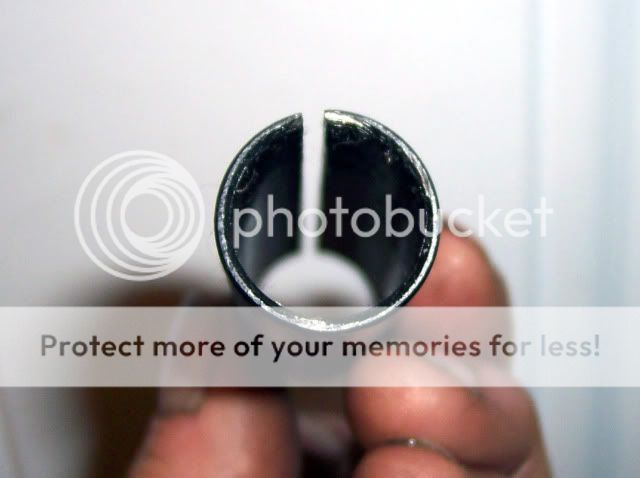

    Progress: Got all the electrical wiring done on the HMC stand.
    http://crevicereamer.com/Page_89.html
    CONNECTING THE Z AXIS:
    PROBLEM:
    The Helical coupler's 3/8 inch bore will not go over the threaded end of the Z screw. I could bore it out, but then it might mess up the threaded end.
    SOLUTION:
    Thread thecoupler to match. Turned out to be a 10M x 1.5 tap, which happened to be in my HF cheapo tap set:
    HF tap set $10. Having the right tap on hand when I needed it--Priceless! Gonna do the same thing for the X screw.

    A tip: If you have multiple Tormach-tooling drill chuck adapters for your mill:
    And a QC toolpost with several 5/8 straight bore holders:
    You can remove that 5/8" insert:
    This leaves a 3/4 inch bore that is perfect for inserting TTS holders:
    Of course, if you have a 3/4-1 inch straight bore holder, that will work WITHOUT removing the insert.
    This makes a pretty good QC Drill chuck system. If you are going to use it manually, you will need to turn a 60 degree point on some 3/4 inch stock--to center the tool post. For CNC though, it's just QC and go.
    You can also turn down the Irwin-socket wrench tap holders to fit this 3/4 inch bore.
