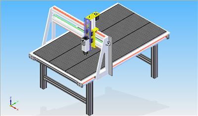

    that's not a drastic change, that's a CNC builders dream
    Your text says 4-axis, I guess you mean 5. Curious to know what you mean with 'really small', 5-axis machines tent to be fairly big compared to the size of the spindle. I would guess that for an MF70 size spindle the size of this machine will have a footprint between 60x60 to 80x80 cm.
    Still very small for such a machine. Have a look at my big monster (we now call it "Elanimal")
    The table is 200 x 120 cm and the height below the gantry is 37 cm. I have been thinking of building a swing the same style as used on the Hermle to be able to do some smaller (ahem) 5-axis work.
    But one of the problems is to get decent 5-axis CAM software. I am partly doing this as a job so all software has to have official licenses that are paid for ...
    The more I think about it, the more fun it becomes to buy a machine like an MF70 for a 5-axis project. The nice thing is that I can use standard angular contact bearings found at a local junk yard: Just a few weeks ago I saw some bearing in the size of 20-or-so cm and was wondering where these big bearings are used. Perfect for a 2-axis tilt/rotation table.
    Keep us posted. I can't want to see the SolidWorks drawings.
    I have some questions about the design of the tilting control: are you planning to use a gear style drive as on the Hermle or will you use a belt?
    What is a proper resolution of the angular movement? With 1.8 deg. steppers and a 1::3 ratio you get a 0.6 deg resolution (or 0.0375 deg when using 16 microstep drivers). At 5 cm away from the centre this is a 0.5 mm (or 0.03 mm) movement. My current 4th axis uses a standard rotary table with worm drive giving me 800 steps per degree - this is a bit of an overkill and it means the system is a bit slow (29 deg/second).

    The initial plans are to not build the fifth axis at this stage but just have a belt driven 4th axis rotary table on one wall driven with a large stepper or a servo if I find some cheap ones. To start with I will be running turbocnc which doesn't support a fifth axis, until I start figuring out how EMC works. There are some nifty five axis projects running on EMC and code is available for a poor student like myself.
    The point in moving the linear slides up on top of the frame is getting as large an area for the total movement with as small total machine dimensions as possible. I will be needing just an extra 45mm + the max radius of the mill bits to be used (I believe 5mm is the largest ER 8 collet available.. or at least the largest I own) around the initial maximum travel area as the spindle package will have the x-y dimensions 90x90mm.
    I've been thinking about sizing it to be mounted in a sturdy 19" aluminium rack similar to a server rack cabinet - to give an idea of the size of the machine.. a travel area the size of an A5 piece of paper would be enough for my purposes.
    I just got my first 3 litre epoxy kit too so i can get started testing various mixtures. I've ordered a few different other brands too.
    I could throw in a picture of my first 5 minute sketch from a few weeks ago which had some design features poorly suited for my needs:
    (the spindle mount is around 160mm offset from the Y-axis slides even if it looks like it was just next to the back wall)
    Just imagine the X-axis linear slides on top of the sides on the frames and the Y-axis column bolted to the X-axis' carriages.. also notice the colouring
    The angular resolution needed will be determined by the size of the maximum size of the raw material to be machined which is still to be figured out while I search for cheapo, usually second hand, parts.

    I've also bought a compaq rack server to control the thing running on Ubuntu and EMC now. It's a nifty old computer with hardware RAID, SCSI harddrives and stuff so it should be quite perfect for this kind of operation.
    I've also gotten my dial indicator and other measuring equipment so I can start lining up linear slide packages for the concrete casting.
    Drawings are still on their way
