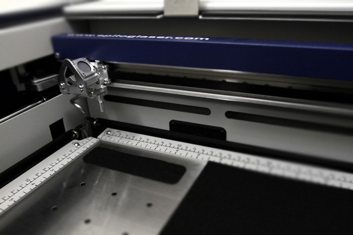

    Ended up with a cnc laser and thinking about picking up the lathe too. The laser is awesome and have used it to engrave & cut wood pieces. Under a 45x scope the detail is extremely fine and very happy with the purchase. Husain here's a few shots of the laser cutting felt & bamboo.

    Brand of the cnc laser?

    Its a Epilog.. I have one from Full Spectrum Laser which I am very happy with.
