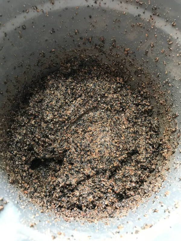

    Aggregates:
    I mixed 50-50% of the two washed gravel
    The process was done the same for the 3 tests.

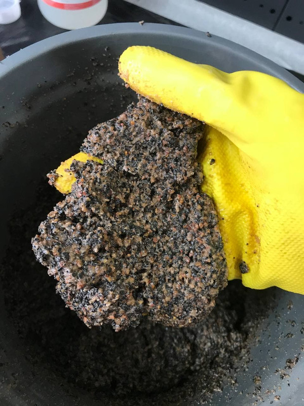

    I separated sand and gravel, mixed it in a bucket, mixed epoxy A and B in another bucket, and then put the epoxy in the bucket where it was sand and gravel.

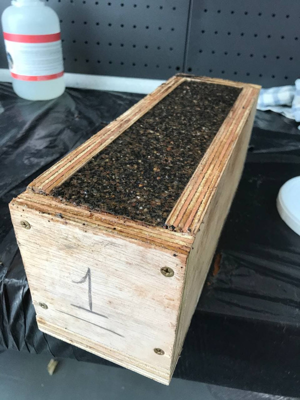

    These photos are from test 1 (12% epoxy):
    Mold after (left) and before (right) wax applied:
    I made the mold in fusion360 and the volume was 0.001822m³ , following these recommendations (found here on the forum):
    "Measure volume of mold convert to mass using 2200kg/m3 epoxy granite"
    I found the approximate mass of my test: 4kg
    The tests were divided as follows:
    Test 1
    Epoxy 12%
    Sand 30%
    Gravel 58%
    Test 2
    Epoxy 10%
    Sand 30%
    Gravel 60%
    Test 3
    Epoxy 8%
    Sand 30%
    Gravel 62%
    And the results were:

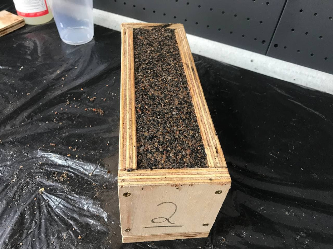

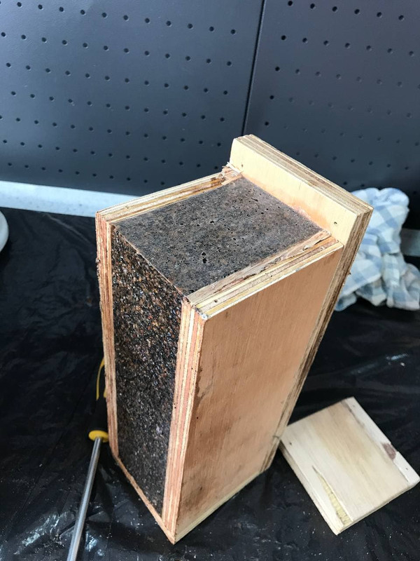

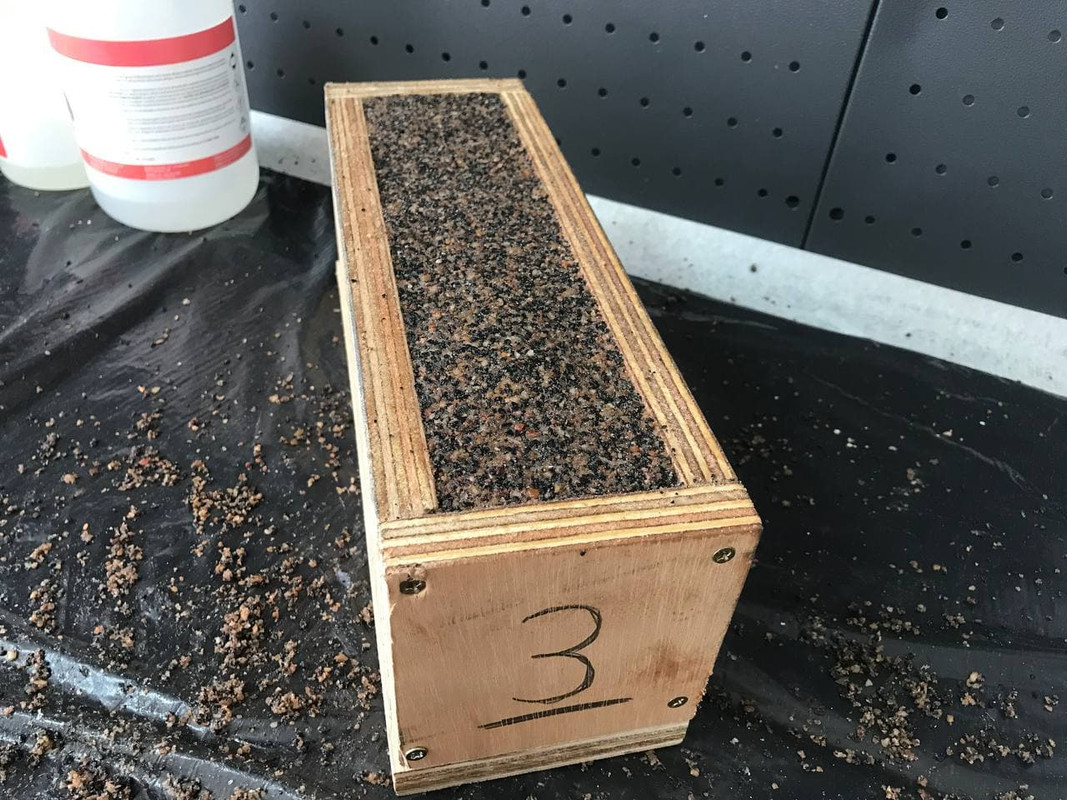

    Picture taken right after filling the mold (epoxy granite still wet)
    the release wax worked very well and it was very simple to disassemble the wooden mold:

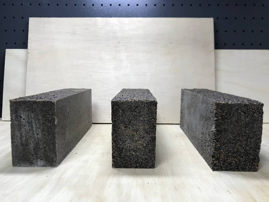

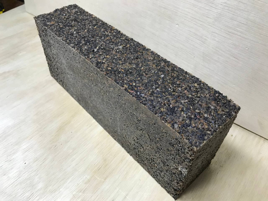

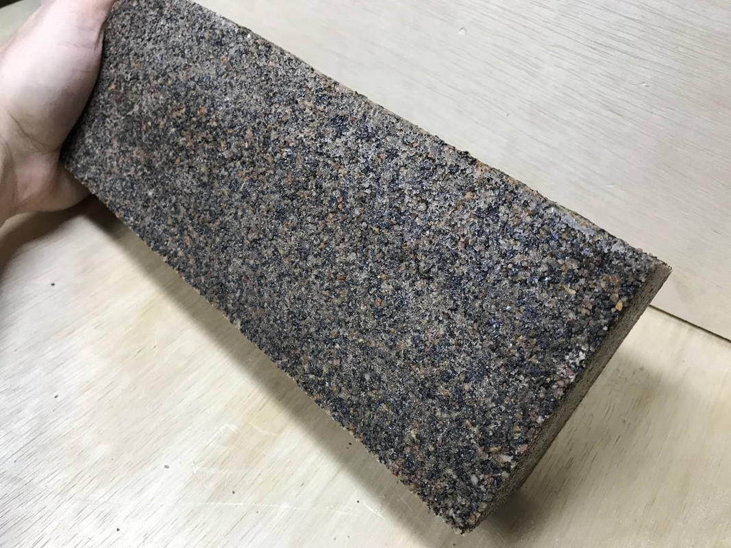

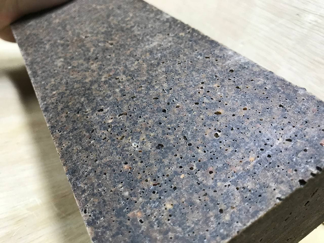

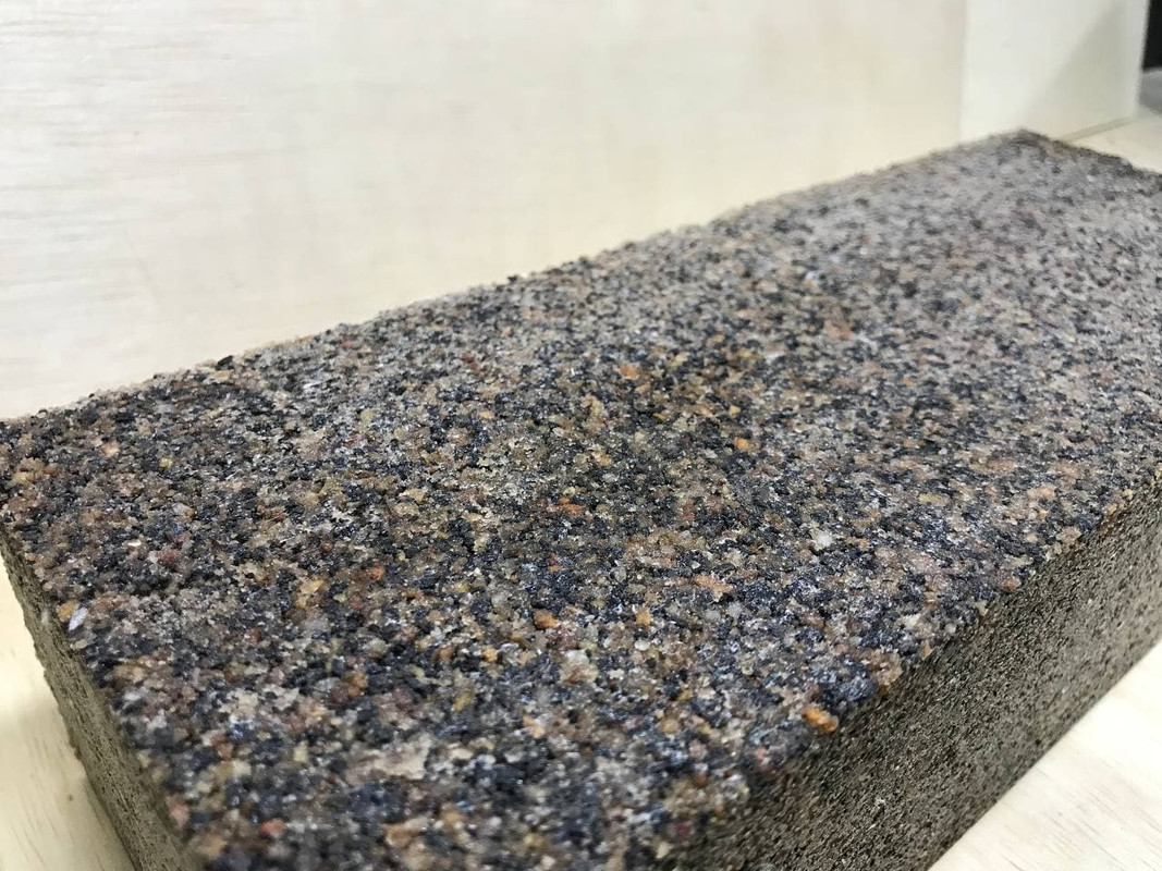

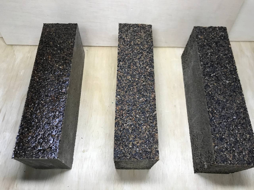

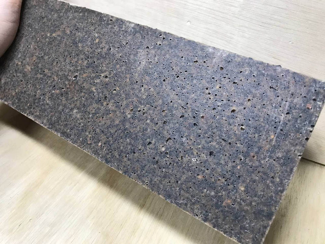

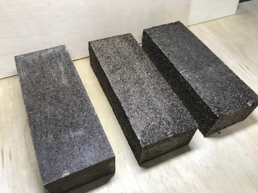

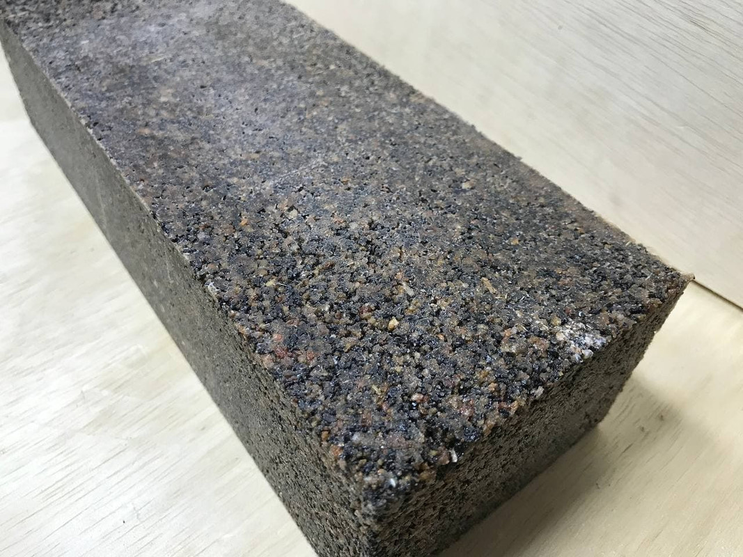

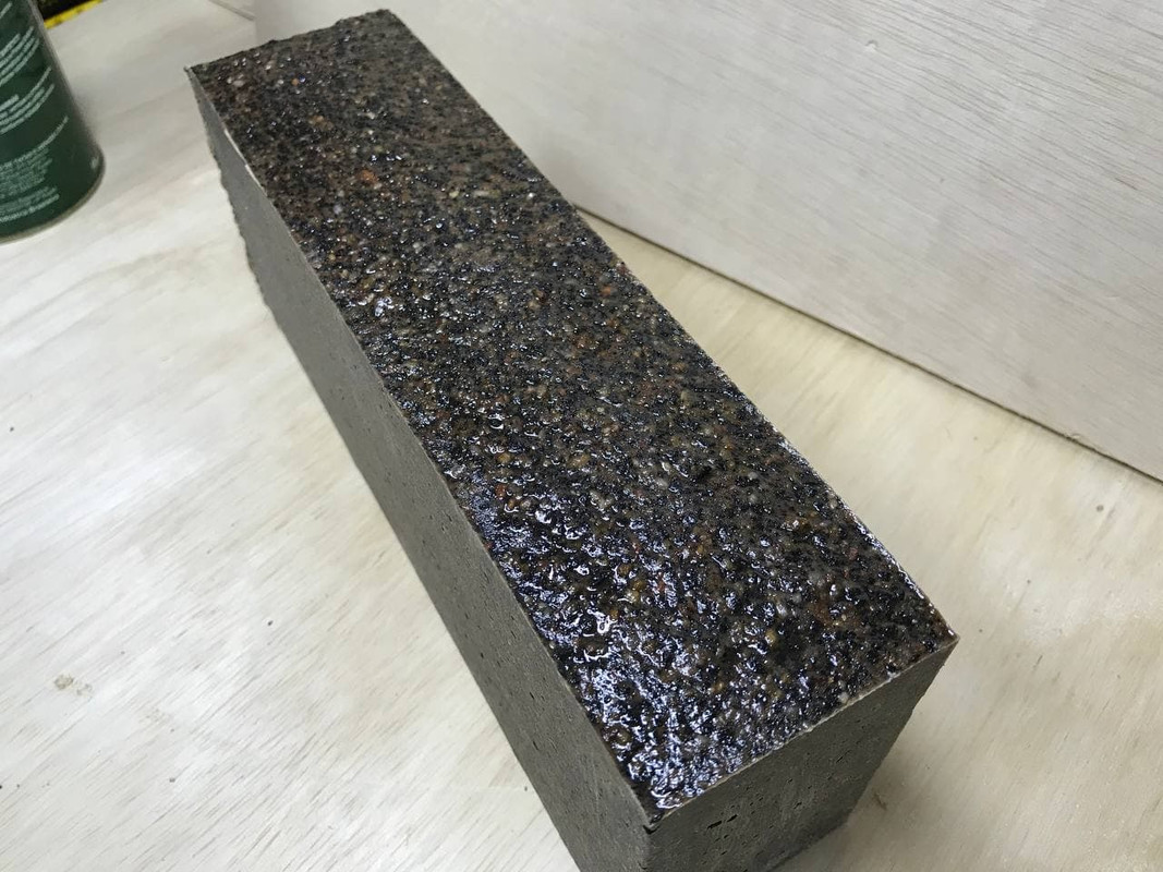

    And now the result of each test, already dry (more than 24 hours later):

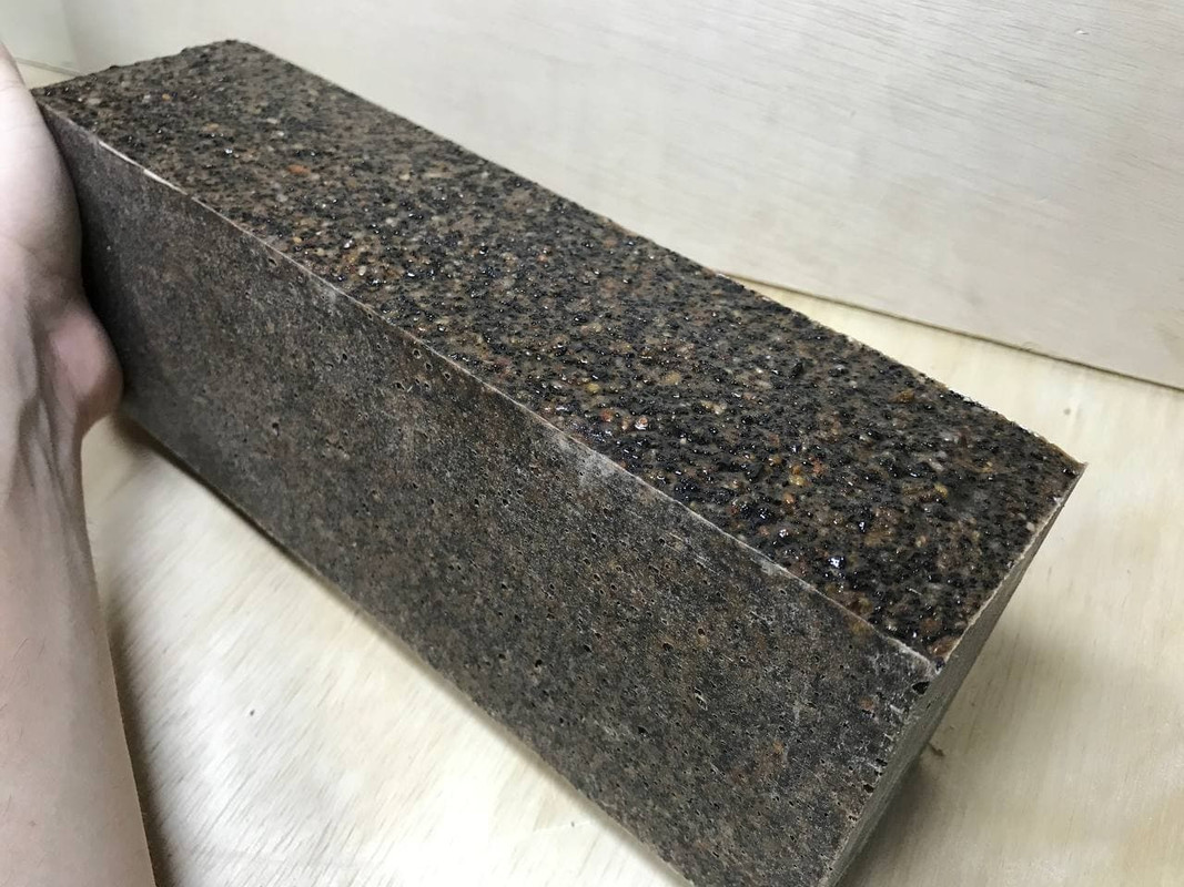

    TEST 1 - 12% epoxy

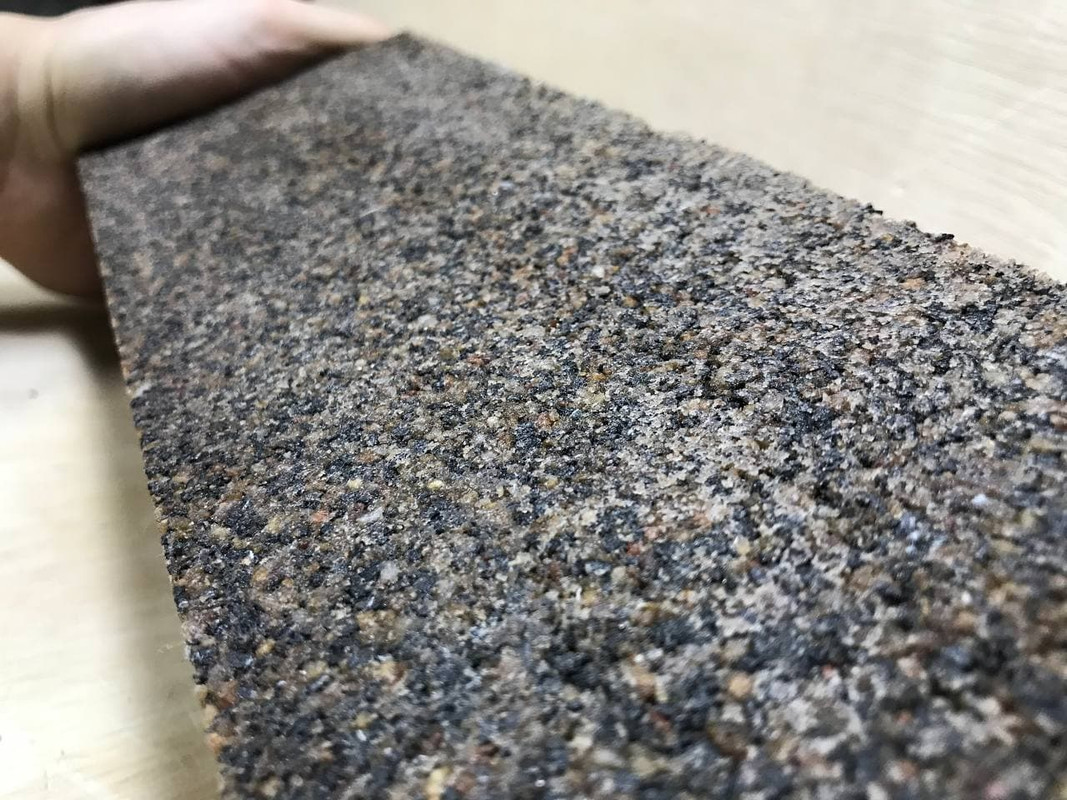

    TEST 2 - 10% epoxy

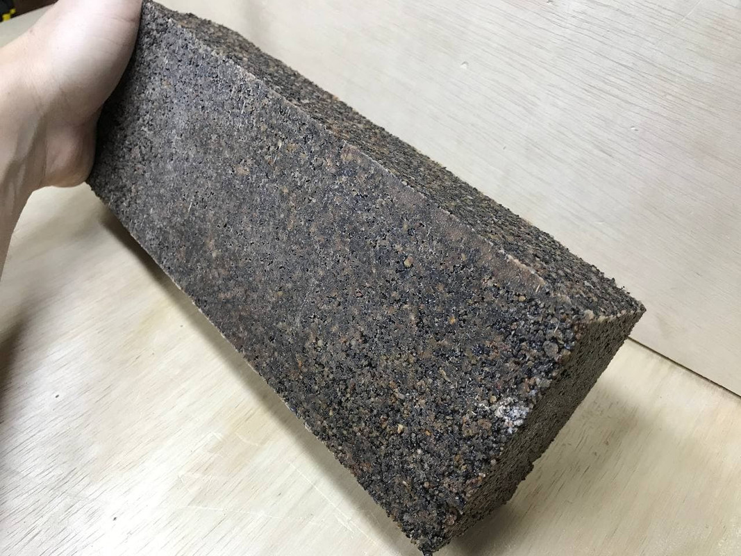

    TEST 3 - 8% epoxy

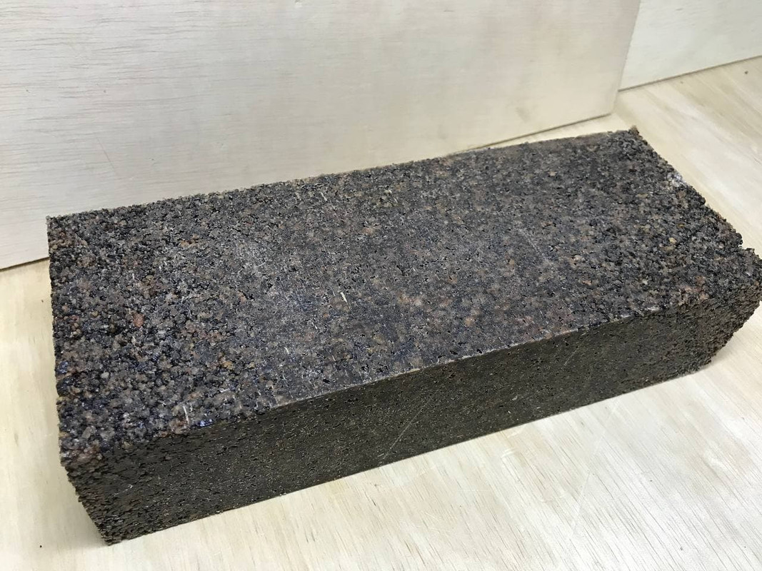

    from left to right, test 1 (12%), 2 (10%) and 3 (8%)
    I would like to hear your opinion, some must have done this several times and already have several experiences.
    It seems to me that Test 1 with 12% epoxy did better, the spaces on the surface may be the fault that I didn't vibrate the mold enough, makes sense?!
    I used a jigsaw without the blade, touched the base of the jigsaw in the mold and vibrated for about 5-10 minutes
    I put the epoxy granite by hand and kneaded it using my hands, maybe that could have been the problem, should I have used something to put more pressure on the epoxy granite and fill the spaces?
    For VMC, as the mold will be large, I intend to use a concrete vibrator.

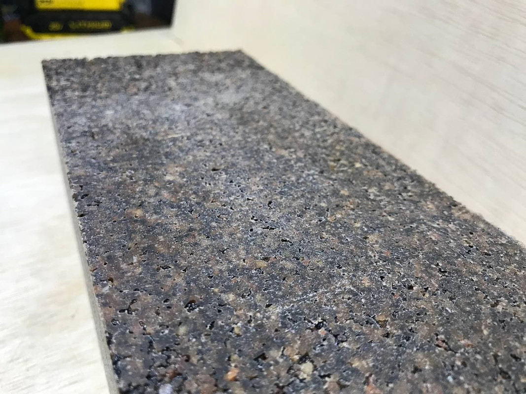

    If it weren't for the empty spaces (bubbles) on the surface of test 1, I believe it looks a lot like the result achieved by stef110 on the other topic:
  4. #4

    I don't think a bit of porosity matters generally.
    With porosity your modulus (stiffness) may be slightly lower than the same size section (WITH with the same epoxy concentration) with no porosity.
    Adding epoxy to fill the porosity will not improve your stiffness.
    Your tests look good.
    More epoxy makes the material easier to work / flow in a mold. You only need enough epoxy to stick the aggregate together and make it workable enough

    Why don't you test the stiffness of your test pieces?
    If you are worried about surface holes only, you can either do a specific mold coat first, or surface coat after demolding.

    Hi Vitali - To find the correct epoxy ratio for your mix you put the stone mix into a glass jar that you know the volume of or you do it on a scale so you know the weight of the mix. Then you add water until the volume is neatly topped up. The weight of the water is the weight of epoxy you need to add if the epoxy is close to 1000kg/m3 density. If denser then adjust the weight eg if the epoxy is 1200kg/m3 then you add 1000/1200= 830 gm of epoxy. Having a bit of air in the mix is OK depend on what you are aiming at. To get better surface finish paint on a layer of epoxy to the mould prior to adding the EG mix... Usually people add a bit less then this test defines. This is either to save some money or they are going off someone elses mix ratios.
    If you use a very thin epoxy vibration is not needed... it will saturate by itself... In fact if the epoxy is very thin you can dry stack the mould and pour the epoxy in and it will flow through the mix until it tops out the mould... Give that a try small scale... Regards Peter

    Hi Vitali - Here's a quick calculation showing what you got in the 12% mix by volume. Its unlikely you achieved more then 65% solid volume. The calc shows you got 74% solid by volume. This number neglects the air content so I'd expect you have a bit more air in there (9% by volume) then the water test ratio would recommend...
    0.44*0.09*1.2=0.048kg of air.... or 0.44*0.09=40 litres of air if you made a 1000kg batch.... Peter
    If you calculate your blocks density then this will give you an idea if these numbers are correct.... for instance in the numbers I used the density would be 2272kg/m3...

    my concern with the bubbles/spaces is not aesthetics (surface) but with the interior of the piece, if it happened on the surface, it must have happened internally, as you said it will affect the stiffness

    Hi Vitali - Epoxy is expensive everywhere and using less is a usual requirement to reduce cost. Weight ratios are useful for making product but not useful for understanding the engineering of the product. So understanding volume ratios is important. Lets call it solids and void or aggregate and matrix. You are making a composite material of solids and using epoxy to bind it all together. Two aspects to consider 1) achieving high solids volume ratio a) to minimise epoxy usage/cost and b) to maximise material stiffness. Epoxy is not stiff its E=3.5GPa whereas your sand and gravel (aggregate) is about 70GPa stiffness.
    Air equals porosity and mixing this sort of aggregate in epoxy its really difficult to not introduce air in the process. Especially if you use a cement mixer!! Plus if you use a laminating epoxy it is designed to be thick and not flow so it holds air really well. It won't "degas" by itself. Its something you have to live with. If you use an infusion epoxy or an epoxy for making river tables these degas well. I use a vacuum process to make this sort of thing so air is not in the mould when infused so very little porosity.
    Epoxy is used as it has minimal shrinkage and a long gel time. Other resins can be used if you understand them and can get them. Urethanes and PMMA are possible. Not sure if they are cheaper though. Polyester and vinylester resins shrink too much to use as machine parts. Portland cement shrinks and cracks over time and is therefore unsuitable for machine parts as well.
    Engineering - Sand and gravel have a low stiffness to start with and couple that with low volume ratios and low strain transfer ratios you potentially end up with a low modulus material. eg your sand is 70gpa your volume ratio is 65% and your round particles transfer strain at about 50% efficiency so your E=70*0.65*0.5= 23GPa. Aluminium is 70Gpa and steel is 200GPa. I suggest you look for CSA concrete grout. Not Portland cement but CSA grout. Its cheaper and stiffer then epoxy. Here's my cost breakdown on a project at the moment. Its the cheapest material, out of the bag you get 34GPa.... just add water. Look up ultra high performance concrete UHPC many machines are being made with it for 50 years... Below costs are in australian dollars..

    Epoxy is a low stiffness material by itself.
    Just adding more epoxy to fill the voids will not improve stiffness significantly.
    You only need enough epoxy to coat the aggregate (aggregate means the sand, gravel, stones, etc that you put in a mix with the binder. The binder you are using is epoxy). Higher epoxy mixes are generally easier to work with because they will be more liquid / flow better.
    You can have too little epoxy and end up not having it mixed through evenly. Mixing well is important.
    Use the thinnest (low viscosity) and slowest setting epoxy you can get
