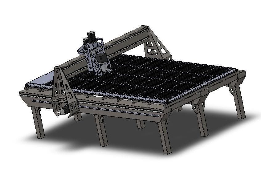

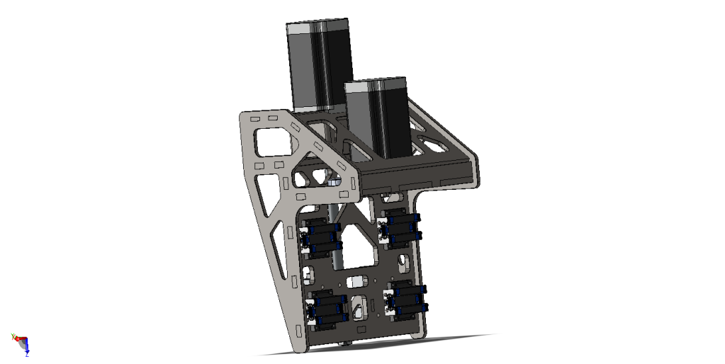

    Got more designed, and I think I'm ready to start buying parts/metal.
    Here's some pics of the Gantry and Z-Axis. I think it's pretty stout.
    What do you guys think?
    Overall travel of router is 54.3125" x 100" x 6.125"
    I'm using 25mm rails and blocks for the Y-Axis, 20mm Rails and Blocks for the X-Axis, and 20mm Rod and 5/8" Ballscrew for the Z-Axis
    The Gantry, with motors, should weight in at about 210lbs. I want to try and build this as solid as I can, because I plan on cutting Aluminum with it sometimes.
    I still don't know hoe to calculate the motors I need. I want 2 motors for the Y-Axis, 1 for the X-Axis, and 1 for the Z-Axis, all NEMA 34's.
    I will use the Gecko G540 Controller. What size Power Supply? Two 400watt be enough?
    The Gantry weighs in at like 210lbs. I will use the gear parts from CNC Router Parts. This includes the weight of the router, motors (1600 oz.), and Z-Axis and will run along a rack and pinion of 100" in length, Motors on both sides. So, with that info, what motor size (x2) will I need for the Y-Axis.
    The Z-axis will weigh in about 50 pounds (with motors and router) and will run along a rack and pinion of 66 inches. (That's with 1600 oz. Motors)
    I've tried to read up and locate the calculations to do this, but I just can't figure it out. Now I know that 1600 oz. motors are probably NOT what I'm needing, I just added that as the weight just in case, so Gantry and Z-Axis MAY be lighter.
    I don't know the speed IPM I need, or The Torque I need. Maybe others who have built similar dimensional tables can chime in here. I just want this table to cut efficiently and not chatter when I try and mill Aluminum.
    This table will primarily be for cutting wood and plastic, but occasionally I'd want to cut up to 1/2" thick aluminum Plate.
    I'll be using the 1.8° 200rev type Nema 34's
    I'll be using the 2:1 NEMA 34's Gears from CNC Routerparts, using the 20pitch Rack and Pinions. (I'm just going to buy the gear plate, gear pully, pinion, and belt assembly from them).
    The Ballscrew will probably be 10 lead, unless you guys think a 5 lead is better.
    The other thing also, I was thinking of using the big 3-1/4 horsepower router from Porter-Cable. Is there a circuit or something I can get for that where the Cam Software can control the speed? The router says 5 speed settings, so I'm guessing it can be modified to be variable speed. If it can, then maybe I need to go with the Bosch Router.
    As far as what I posted above on the Vaccuum system, I'm still searching that. That motor I posted is a 3-phase. Won't really work in a residential home. So I'm looking for another alternative.
    Hopefully these problems can be resolved, because I'm ready to start buying up the parts, now that the Solidworks designs are done.
    Thanks in advance Guys!

    I just want this table to cut efficiently and won't chatter when I try and mill Aluminum.
    That's more a function of rigidity than motor choice. I think the linear bearing mounted so high on the Z axis may will make it a bit too flexible.
    Imo, the G540 isn't powerful enough for Nema 34 motors. Better to use higher current motors and G201x's or G203V's.
    Also, I believe the G540 has a 7 amp fuse inside, so it can't draw more than 350 watts from a power supply (7 amps x 50 volts).
    You can use a Super PID to control the 7518, but you need to remove the stock speed control. www.SuperPID.com - Super-PID Closed-loop Router Speed Controller

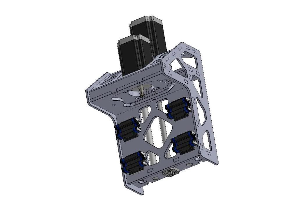

    hmm, okay
    The linear bearings are mounted to a 3/8" thick steel plate and then the sides to give it support are 1/4" thick.
    how else could I mount them? If I mount them lower, I'll lose Z-Travel. I plan to have a 6x6 solid maple (or other wood) by, say, 48" length on the table I plan on cutting flutes in using a round end mill bit. So, If I lower the Linear Bearings, It won't reach the table when I try and route oute 1/8" plastic.
    I tried doing a Linear Rail and Bearing system using Rack And Pinion. Where the Railes fit on the side where the router is, then the support of the rails are full length, but, I'd have to use rack and pinion to make that work.
    Anyway, thanks for the suggestions.
    Would maybe upgrading to 1/2" steel for the Linear Bearing mount or taking out the holes stiffin it up enough?

    mount the linear rails on the back of the spindle holder bracket you have going there and attach the bearings on the Y carriage.
    Not sure if I see how you can adjust the tension (gear mesh) on your Y axis.
    And yep you'll need 4 steppers and drivers

    OKay, Here's the new drawings for the Z-Axis. Is this what you were talking about?
    I can understand How it would be more stable when the router is up higher, but I don't really see any difference when it's dropped all the way down.

    you have been talking about 1600 oz steppers in past posts Way too big!Hopefully Gerry will chime in and explain.Taking a wild guess I would say 640 oz should be enough or the largest stepper to consider

    What material and thickness is the Z?

    The pieces that the motor, Rail Blocks, rails bolted to, and Bearing blocks sit on are 3/8" steel. So the sides, and that top angle piece are 1/4" just to keep it rigid.
