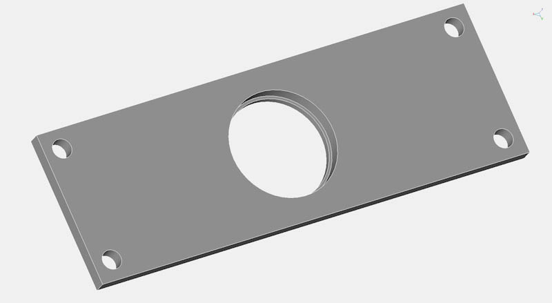

    Now the the mill is functional, I have been busy learning to make stuff with it. Currently I am working on making 4 lights for the front bumper of my truck.
    This is my first attempt to make a light entirely with cnc. It is designed to fit flush in the front Addictive Desert Design bumper on my ford Raptor truck. When I ordered the bumper, I had them make a custom plate so I could mount lights in the bumper itself. The lights will be cerakoted and each light is a triple xm-l board running task led driver. The body of the light is designed to fit tight in the bumper and transfer heat to the bumper as well as act as a heat sink.
    Rendering:
    Top:
    Bottom:
    Machined top:
    Bottom:
    Test fitting in the bumper:
    There will be 4 of these to fit in the cutouts on the bumper. Should be 10k + lumens with the flick of a switch.
    Video of the part being machined:
    I will post more after I make the back. The whole light will then be cerakoted and mounted.
    FYI, It took 1 hour to measure and draw the part in cad and 15 minutes to machine the top + 5 minutes to setup and cut and profile the bottom hole. I am really happy to be able to draw something out and actually see it take form. The best part was drawing it out in cad and then seeing the finished part fit perfect.
    Thanks for looking
