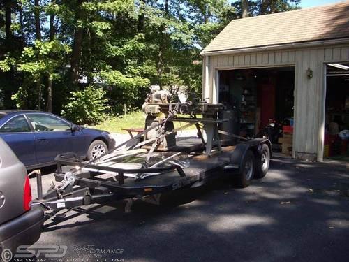

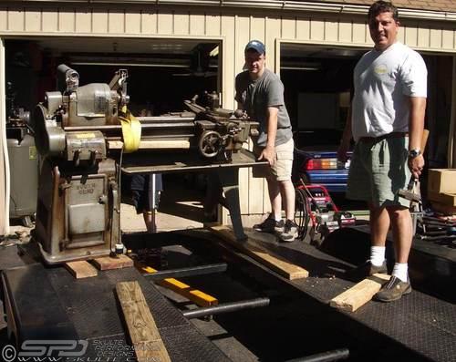

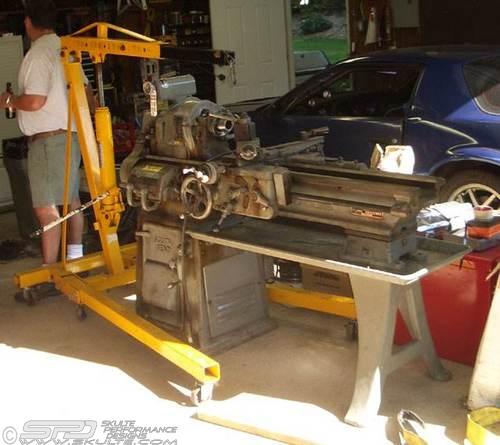

    Friday night I drove down to a friends, who teaches at the University of Delaware, and found a great deal on a lathe (a South Bend 13x40, CL0145B, barely used) they needed to get rid of. The next morning, Mike, Dave, and I went to the university, rolled the lathe on two dollies out of his lab, across two doorways, down a handicapped ramp, along a brick walkway, and finally lifted it onto the trailer with my engine crane. The drive home was uneventful, and I recruited my neighbors (who stupidly agreed!) to help unload it into the garage.
    We used the ratchet straps around the base and legs of the lathe to slide it back on the trailer. Once the straps were maxed out, we lifted it with the engine crane, drove the trailer forwards, and placed it at the end of the dovetail on the trailer. We kept the engine hoist in place as a safety, to prevent the lathe from possibly tipping. The block of wood under the leadscrew is to keep the straps lifting at the bed, from contacting and possibly bending the lead screw. There's a little gap there, and no contact.
    Then, we backed the trailer into the garage, so the little engine hoist wheels wouldn't have to make it over the 2" step at the garage threshold, lifted it off, drove the trailer out, and placed it down. Simple! A forklift would have made it much easier, but I don't have one, and this only took 2 hours.
