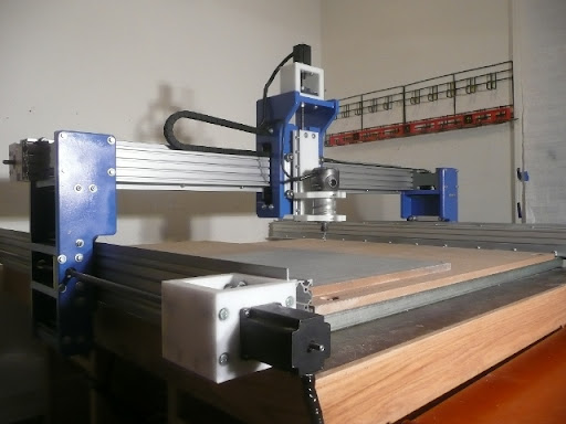

    Completed 4x4 Hybrid!
    Hey guys,
    It's been a while since I last updated this thread, but since my last post I was able to complete my build of Joes 4x4 Hybrid. I built the machine for my senior graduation project and I have to say I'm very proud of it and how it turned out. I'm extremely grateful and appreciative of everyone who has donated materials, advice, and knowledge to my build. I couldn't have done it without you guys!
    So heres an overview of the build:
    First I finished building the torsion box assembly table that I decided to use as the base for my machine. I liked the assembly table because it provides extra storage space and is very stable. It is made out of 3/4" oak plywood and an MDF torsion box that is wrapped in oak w/ a hardboard top.

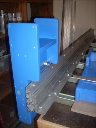

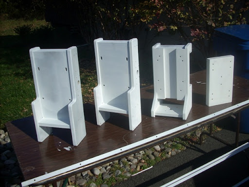

    After the table was completed I moved on to building the carriages for the machine. I cut out all the MDF parts on my schools CNC. I then glued together the carriages, sealed the joints with some filler, sanded them, and then primed them.
    I then painted them bright blue.
    After the carriages were completed I moved on to preparing the metal for the machine. I drilled, cleaned, primed, and painted the angle iron for the machine. With a simple fixture on the drill press this was very easy to do and didn't take much time at all. After everything was painted I was ready to start assembling the machine. First I mounted the strut channel and aluminum extrusions on to the base table. I made sure the Y-Axis rails were parallel to each other.
    I then fabricated the bearing pressure plates and attached them to the Y-Axis carriage. Next I mounted the carriage onto the rails and adjusted the bearings.
    I then mounted the X-Axis extrusion onto the two Y-Axis carriages. After that I had to attach the bearings to the X-Axis carriage. Then I mounted the carriage to the extrusion and adjusted the bearings. Next I fabricated the Z-Axis slide and installed it on the carriage.
    Next I attached the HDPE motor/bearing mounts to the aluminum extrusion.

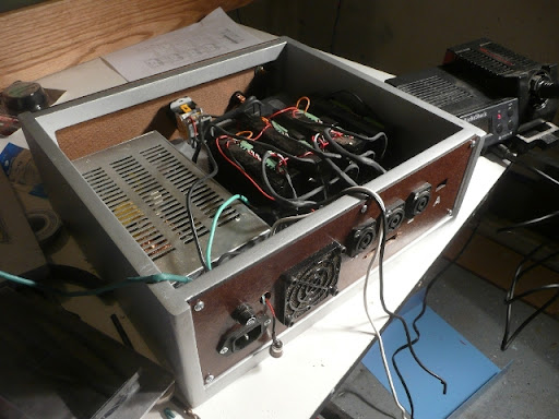

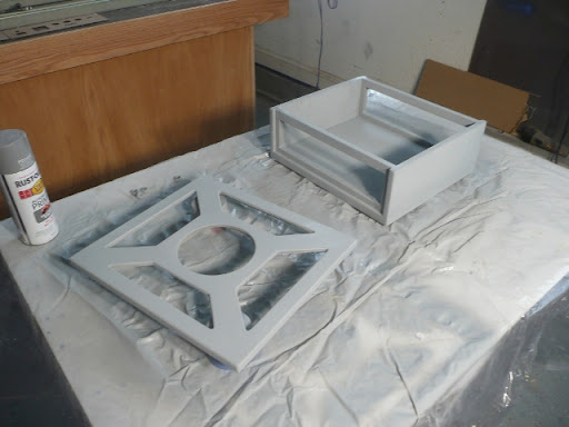

    After that I installed the leadscrews, leadnuts, and motors. Next I moved on to designing and fabricating a controller enclosure. I drew up the designs for it in Rhino CAD software.
    I then cut out the parts for it using my school's laser and CNC router.
    I then glued together the parts, applied bondo to the seams, and sanded it. Next I primed the enclosure and painted it an aluminum color with Rustoleum High Performance Enamel which is awesome spray paint because it drys super quickly.
    I then transfered the electronics from a 3-axis Keling controller and added a fourth driver for the fourth motor needed on the Hybrid. With a little soldering and some heatshrink I was able to get the controller put together pretty quickly. I wired in a blue LED fan too.
    After the controller was completed the only thing left to do was extend the motors and tune them. This didn't take too long and the motor tuning was very easy to do.
    So here are some pictures of the completed machine:

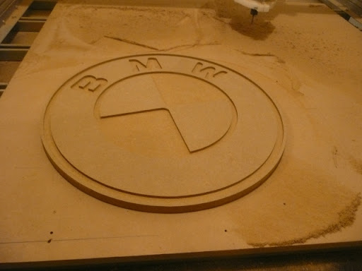

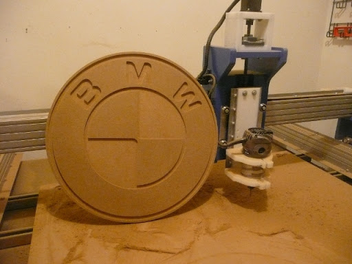

    Here are some pictures of it cutting a BMW logo. It's a simple 2D cut but it still proves the machine works. This machine works just as well, if not better, than my schools Techno-Isel CNC router. I am very pleased with the results.
    To anyone considering building a Joe's 4x4 Hybrid CNC: DO IT!!! I would highly recommend building the hybrid because it has arguably the best performance specifications of any DIY CNC on the market today. Also, it is very simple to build and there is great support available on the private users' forum. You won't regret building a Joe's 4x4 Hybrid: The plans are excellent, the build is exciting and fun, and it's an experience that I'm sure I will remember for the rest of my life. I'm only a senior in high school but I had no problem building this machine and hopefully soon I'll be using it to make some money for college! Thanks for taking interest in my build!
    Sincerely,
    Spencer
