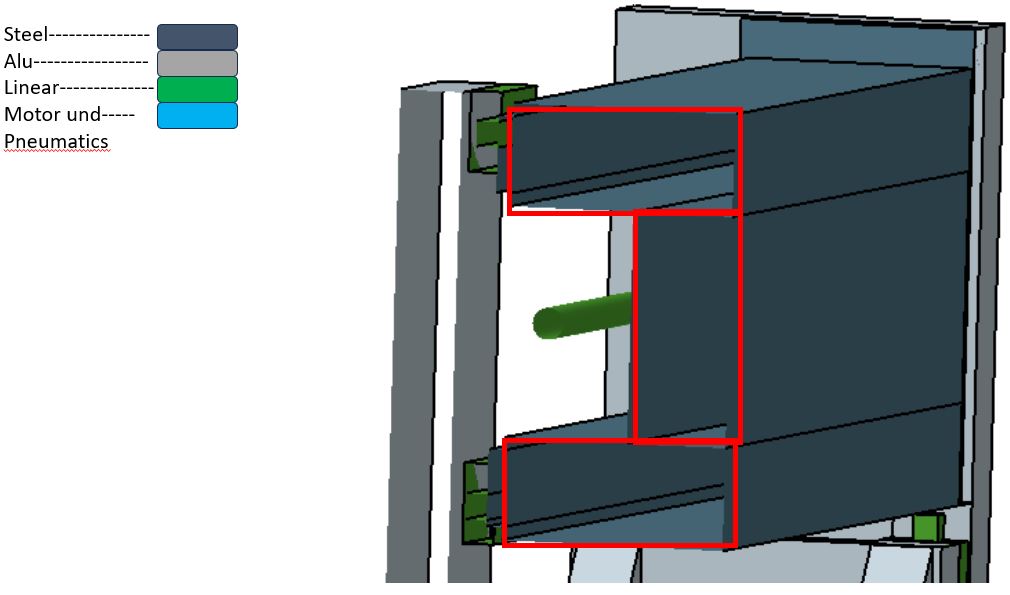

    Hi all,
    I´m planning to develope and make a cnc router and I have questions to some design topics.
    The concept I have has quit a big Z travel (>500mm) what makes it hard to get the mashine stiff enough on a conventional router design (X+Y and torsional for the Z axis). The space for the mashine is limited (router shall be used as a table if not in use and also storage room under the table is required). Router shall mainly be used for alu, wood and foam but I sure want to get it as rigid and accurate as possible. Working area as big as possible and in Z min 500mm.
    So I´m trying to solve this issue with a different Z travel concept. The Z travel is moved away from the gantry beam so that I can control the forces better. To reduce the issue with the additional weight the plan is to use pneumatic cylinders to compensate the weight in Z and strong enough AC servos to handle the aditional forces in X.
    There are also 4 linear rails for the X and Z axis and 2 rails for the Y axis. This will make the alignment of the axis quit tricky and hard work... but I am hoping solve that issue and so get the forces better under control(more connection points and distances between them to reduce the forces).
    The plan is to use filled (damping) steel tubes, WIG/TIG to weld them together and the Alu will all be made out of a huge 50mm thick Alu sheet (I have it so I try to integrate it into my concept to save some costs). To get some more stability and weight onto the table I planned to make a UHPC bed (only the alu working plate will be fixed to it).
    Alot of blabla so I made a quick and dirty concept of what I´m thinking about: see the attached screens (it´s really a rough first sketch!).
    Questions:
    1. Does the concept with the Z travel and pneumatic cylinder make sense?
    2. Is the aproach of reducing forces with the con of having to align more rails worth a try?
    3. The weight and forces on the X axis are high in motion. Do you think I can handle that from a mechanical
    standpoint (make table/bed heavier)?
    Please throw your darts and thought´s to this concept, it´s my first mashine and I appreciate (and need) input.
    Thanks!
    Sebastian
    Attached Thumbnails Attached Thumbnails motion.JPG   material.JPG   dimensions.JPG   x_axis.JPG

    Points given for innovation here, but I don't see this working too well. By lifting the whole gantry beam for each Z move, while the spindle is fixed in position, you lose the ability to descend into a cut any deeper than the tool stick-out plus the spindle nose allows. The clearance under the beam becomes a critical limiting factor. Say you're trying to carve something that looks like Mt. Everest. Cutting the peak would work okay, but as you descend down the slope, if the tool can't reach (and there's a limit to how long they can be, especially when cutting materials as hard as aluminum) the beam is going to bang into the summit as it tries to pass it. On a normal router, the spindle would be able to descend the slope to the limit of the Z travel, but on this one, most of that travel is useless.

    Hi Nord - Can't see your images or the links. use the go advanced feature and imbed files please. Now if I get your drift correctly you want to use twin rails on the axes. This does not work. Only one rail is needed. This is because square rails resists moments so the first rail in the load path does all the work. The next rail does not see much at all. If you have simulation or FEA you can prove this pretty quick. I have modelled it several times to come to this conclusion. Better off using bigger rails/cars to improve stiffness or better spacing to improve geometry.
    The 500mm Z needs to be considered carefully. You need extra long tools to take advantage of the length and depending on the part geometry it can backfire on you with side clearances. Plus the 500mm needs to be really really stiff and if the 500 is only used once or twice a year you have a poor machine for 99% of the year. I'd look at a 5 axis machine if this is really what you need then you can tilt the head to overcome the issues. Peter

    Hi Nord - A lifting gantry design. Think it through - if you have 500mm z and you have a 450mm high billet, how does the gantry get down to the bottom of the bowl? So you still have a 500mm Z cantilever? and a 450mm long tool. I once saw a 400mm tool in a machine get out of balance and bend and fly across the room., Very dangerous!! Peter
    if you need 500mm because the part is 500mm high but your only doing 100mm deep cuts or less to it then consider a pit vs a lifting gantry. Peter

    Hi Sebastion - Now I have seen your images I'll answer your Q's:
    1) In a word no. It will make the machine very costly for the purpose (which you need to explain better then "I want 500mm z") it has redundant rails and cars and a complex gantry to keep square and level. Due to ballscrews being slightly different they do wander over time due to this in-tolerance. This will take your gantry out of level over time.
    2) again in a word , Not worth a try. Since square rails oppose moments, having extra rails does not help. The first rail in the loadpath does most of the work. Very large machines (like size of houses machines) have double rails but this is so they can be assembled with stability not to improve or decrease the loadings
    3) A machine can always be made "strong" enough to do the job. The actual forces on cnc machines such as this are quite small. Even small carriages can support tonnes of weight... Machine rigidity & simplicity are the things to chase and that will give the machine its required strength.
    So its your first machine, good on you for trying . Firstly a good machine is made to a fulfil a purpose. If you try to design a general purpose machine the compromises are too big and you go round in circles and eventually end up with a machine that's crap (I've been there) or a machine that looks like the usual machines. The usual machines have been refined over a long time say the last 100 years to get where they are. They are deceptively simple, so simple, you say I can do better eg use twin rails for a design vs a single rail. So A) define what you want the machine to do as this will answer many of your Q's & give you a direction that will arise often in the design journey B) find a commercial muse machine that does what you want and contemplate why it is what it is. It will inform you of many things that will reduce your thinking stress and project time span...
    Regarding a mixed media build. I recommend you stay in one material universe. Mixing materials may get you into trouble with thermal expansion differences. eg steel expands 13um per degree vs aluminium at 27um and concrete about 13um...These sound small but they do make a difference in a machine and commercial machine builders go to long lengths for thermal stability and so should you. I'd forget about filling steel tubes with stuff, commercial machines do not do this and this forum has 1000's of discussions about this topic. My view is use a thicker tube, its then stiffer and easier to do things to in future and far cheaper... and banging parts with hammers and listening to the ring or soft ring does not really answer the question about the machines dynamic stiffness, its far more complex than that... Peter
    Hi Andrew, thnx.. yes the limiting factor for pocket´s / slopes is the gantry (issue with spindle and backplate is the same as in conventional concepts). In my use case (I´m targeting for 220mm) ther is no need for that and if I ever come in the situation that I want to handle that task I can attach a second adapter plate in the lengh / shape i need.
    I am planing to carv foam to shapes that are possible with this setup.
    The hight is needed for the "big" foam block´s that are going to be mashined from both sides but mainly it is going to be working under "normal" conditions. I am hoping to get around the confliction requirements with this concept. This mashine build is for hobbie use cases but I want to do the best I can.
    Thanks!
    Sebastian

    Hi Sabastian - Since your going to mainly cut foam I suggest you use a conventional long z axis, not the lifting gantry. I suggest that you design the spindle so it can be canted 45deg or even to horizontal. This means you can machine the left hand side with the tool leaned, this overcomes the collision angle issue. Then you manually cant to the other side and machine the right hand side. I did this on my first machine and it worked very well... You should consider a rotary platter and then you have a very good solution for this sort of task. The platter can be simply manually registered to four quadrants or can be under rotary axis control.. Peter

    Hi Peter, Thank you for all your great technical input! The point is that I was trying to combine conflicting directions for the mashine build but you are right. I will now slice the foam and glue them after mashining so I dont need that big Z travel. With all this input I have the direction I was looking for (even more clear than I was hoping to get )
    Hi Peter, yes I am going with a long Z axis now (something like 250mm / 300mm if i find a way that I feel comfortable with it). And again great input with the rotary platter, have to do a deep dive but I like it (gives me more possibilities in the foam than I was thinking about). I´m now going to make different design´s (gantry, vertical gantry support and z axis all steel and UHPC) hoping my specs are duable now. Run FEM to confirm what is the best direction for me to go.
    I will post the different concepts here bevor I´ll go to the FEM simulation (static).

    Hi Sebastion - My standard Z axis is 350mm. The z axis plate is made from two pieces of steel 3mm thick bent into a channel and mounted back to back. They are about 180mm wide and the flange is 50mm deep . It cuts aluminium easily. I'd expect something similar would go to 500mm and deal with timber and foam easily. The z axis is actually easy to get right, its the saddle that will take a lot of your time. Keep at it. I've attached images one of my routers called Franky for your info. Peter
    re: images I have always posted in cnczone for years and I hasn't given me any issues. Theres been lots of issues with Ind Arena twinning images into cnczone.
    This is the sort of machine you should consider - but have a rotary platter on the bed. Either permanent or removable.

    Hi Sebastian - Now you have a direction with the machine I also suggest you don't worry about a gantry. That's because with a platter you can get to all sides with the rotary so half the gantry motion (and footprint) is wasted. This means the machine is simpler as you use 3 axis vs 3+1 axis (plus the tilt and the rotary of course). Look at these two Mori's for instance. If you use the tilting spindle these would be simpler to build then a gantry machine. This then becomes a very versatile 5 axis machine. Peter
    as a side note - your original issue was trying to better arrange the machine to decrease the forces on the bearings / machine. These two configurations are called moving column machines. They solve the issue you describe as the tool forces are always (nearly) within the footprint of the bearings. With a gantry the spindle is offset forward of the gantry so side loads can never be within the bearing footprint so it will always have a secondary torsional component in the cut and machine. The two machines attached solve this issue neatly and only have the primary loads to deal with. Peter
