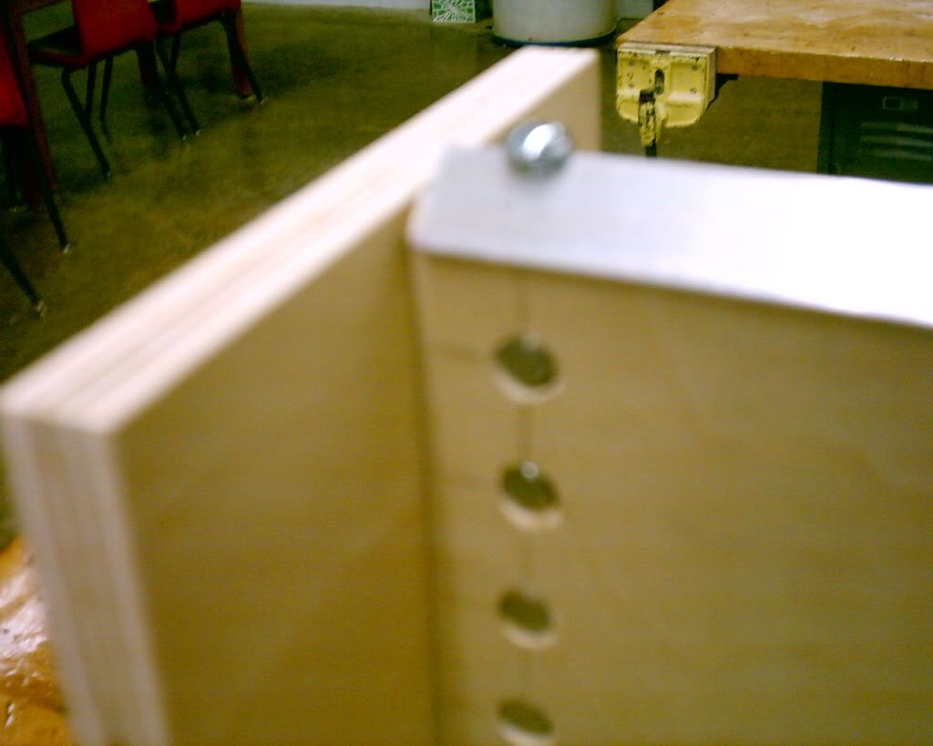

    I asked a lot of questions read a lot of threads and decided to go with the book build, I am going to take my time with it so bear with me. Any suggestions or comments (positive or negative) are welcome
    I went out and bought plywood instead of MDF and I ordered the Hardware kit. Went tot he local Lowes and purchased the angle aluminum and I began putting things in order.
    [IMG]Parts Bench[/IMG]
    Next step was to build the BRAs
    [IMG]Assembled BRAS[/IMG]
    Today I clamped my top and bottom together and drilled the 1/8 inch pilots and the 1/4 inch holes.
    Drilling 1/4 inch hole
    Next step is going to be the chamfering on the top and bottom.
    I did have a quick question. The drawing in the book shows 6 FHMS countersunk in the top to hold this together.
    The scres I have are only 1" butt he plan calls for 1 1/4"
    I do have 1 1/4" RHMS, but this would require a counterbore instead of a countersink. Am I missing some screws or do I use the RHMS, or do I REALLY countersink the FHMS and REALLY counterbore the 1/4- 20 nuts?
    Pardon my picture quality, I am using a Vivitar 3315, until I can talk the wife into letting me use the "good" camera at school here.

    5/29 More progress
    I was able to get more done today than I anticipated.
    I test fitted the 1/4-20 FHMS and was not happy with having to drill out more for the 1" length screw recommended, so I bought 1 1/2" replacements, but might switch to 1 1/4".
    I drilled ends and chamfered the sides.
    Top drilled and chamfered
    Next step was to cut out the legs and drill all the holes.
    Legs drilled
    I attached the legs. I made one mistake in drilling the bottom dowel locations, they were about 1/4" short but this will not affect performance.
    Legs attached
    Ended the day by drilling the rails, drilling the side location holes and installing the rails. The book recommended drilling 5/16" hole to give a little more wiggle room. This was probably a good idea.
    Rail
    All in all a very productive day

    Been a while since I posted progress or pictures, but I have been busy giving students final exams and correcting them.
    I was working on my machine, but just diodn't ahve time to post, so here is where everything stands so far:
    Started out the week with two mistakes:
    First when I drilled the Drive assembly (Part E) for the Gantry bottom my bolt location was off, not a lot but enough so that the bolts would not go through the holes.MY apologies for the poor picture quality.
    Part E error
    Next day made a new one of those.
    Then I followed taht up by having the motor mount holes out of alignment for the gantry sides. Every other hole was spot on.
    Gantry side error
    Made new ones of those and they lined up perfectly.
    Today I was able to get the entire gantry assembled and sliding.
    Table top and Y axis with the gantry side.
    Gantry sides bearings
    Gantry side and X axis rail.
    Front view of Machine.
    Front
    Back view
    Back
    I have discoved that I am missing some 3" bolts and about 25 or so 1/4" nuts, but it seems I do hafve extra cross dowels and 2"bolts.
    Does anyone think that using the 2" instead of the 3" will impair the machines strength and or accuracy?
