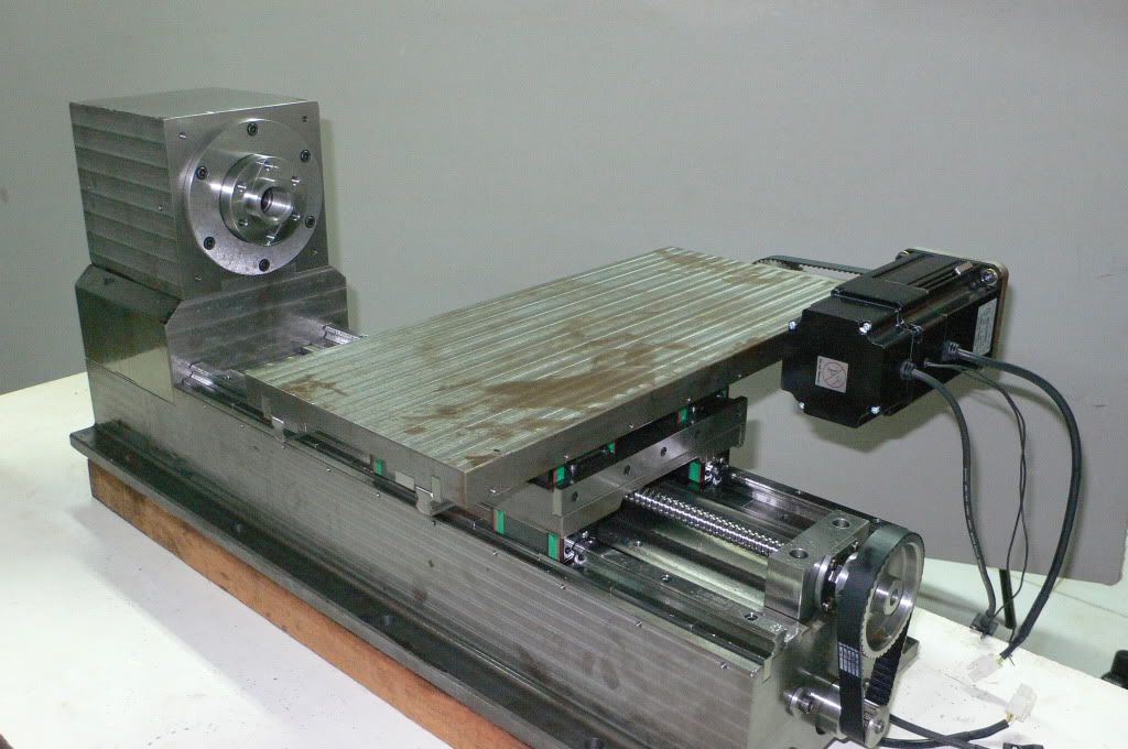

    I assembly mechanical parts already.
    I needed 4 month to finish this project.
    Now the most scary parts, electronics.

    Looks awesome man! How much does it weigh? What type of tool turret are you planning? Are you going to have a tailstock also?

    Very nice lathe. It will be interesting to see it making chips.
    I have a question. I noticed that the reference edge for the linear rails is a removable strip. Is there a particular reason you did it that way as opposed to simply machining an edge into the casting?

    Weight about 150kg.
    It will be vertical gang lathe without tailstock
    Bob,
    The reason for reference edge for the linear rails made from removable strip,
    I can adjust easily by grinding the hardened steel insert, instead fix cast iron.

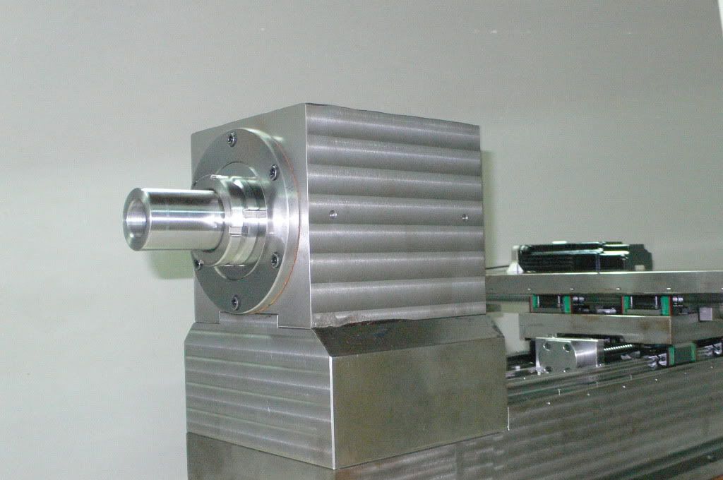

    Today I tested the spindle.
    Until 3000 rpm the spindle is smooth. but reaching 5000rpm, the spindle is hot after 5 minutes, then the spindle getting heavier to spin, even I put many oil already(I made oil input & output hole for each bearing). I think the spindle got thermal expansion(Spindle body made from cast iron, but the spindle itself made by steel).
    Still thinking to use water cooling on spindle body or change the plan to 3000 rpm.
    Any suggestion?
    :banana::banana::banana:

    Why you should go hi rpm for lathe? What motor RPM basically? If you go that hi, maybe use servo motor spindle like the one on cnc lathe.

    money king,
    water cooling is the best way. I just watercooled my 3A stepper drivers that were getting very hot. But after water cooling they run at room temperature.
    But the problem you can face with your spindle cooling is" the circulating water will get too hot in couple of hours".
    But for a lathe i guess 3000 rpm should be the limit, specially if it is a small lathe. Btw what you want to turn on 5000 rpm? the bearings will be ruined in months?
    I guess sticking to the lower rpms is better option for now. in the future if you are not satisfied with the performance you can upgrade to 5000.
    Actually, i am just waiting for your lathe to make chips. plz Do it fast. For water cooling, you may need a huge watertank for watercooling or a chiller system if you have couple of letres only of circulating water.
    any pics of the spindle? motor?

    another news, the bearings you are using are limited to 4500 rpm according to skf.
    http://www.skf.com/skf/productcatalo...=3&startnum=10
    check it out

    asuratman,
    because I need 5000 rpm to cut material to archive mirror finish.
    I bought motor 4 HP 2880 rpm at 50 Hz.
    jasminder,
    2 month ago I made chiller by using 2HP air conditioner outdoor unit and made a stainless steel water tank to cool down my miling spindle. This what I'm thinking to use on this machine. For the bearing, It live should be long, since max speed is 6000 rpm, and I'm confirm about alignment of the bearing, since I made the spindle body & spindle by 1 time setup grinding.
    But I'll make the lathe run first using 3000rpm and I'll upgrade next time.
