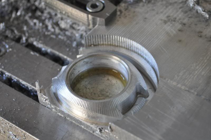

    Every Caseback was centered on the Beagle VMC 2814 prior to milling the threads ( M39x0.5)
    But, for the recessed Seconds Subdial i had to put in some manual work..
    and this week.. i finally started on making the cases:
    the Beagle handles this tough material great.. solid Carbide endmills do the trick, a smooth surface after milling so minimal finishing is required..saves me a lot of time..
    Also... the leather strap will be fitted with a Titanium Buckle, grade 5 of course, and it will be laser engraved with a logo as well..
