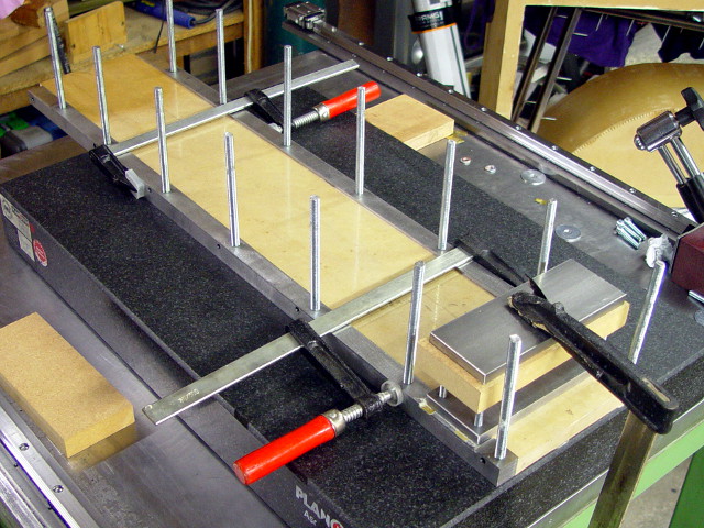

    Hi guys,
    I am currently building a gantry mill where the gantry will be constructed out of epoxy concrete (quartz in various grain sizes plus epoxy, so I can hardly call it 'granite'). The first real part was a subassembly for the gantry rails. I casted this part in two sessions on a granite surface plate:
    The epoxy concrete mixture used contains washed and kiln-dried quartz with grain sizes from 4mm down to 50um following Fullers curve with exponent 0.4 and 8-9% epoxy by weight. This resulted in the most dense mixture. 1% aminosilane was added to improve epoxy adhesion to quartz.
    I pushed the ground steel strips to the surface plate during the curing of the epoxy to keep them in the same plane. But not with much force (the surface plate isn't mine and I do not want to break it)
    And yesterday I took the part out of the mold:
    The whole idea behind using EC for the gantry was that i could use a surface plate as a reference, and cast the support around it.
    This did not work; the steel strips deformed quite badly into a 'bow' form. When put on the surface plate there is a gap of ca. 0,12mm between the plate and the strips at the ends.
    The only reason I can think of why this happened is shrinkage of the EC.
    How much is this stuff supposed to shrink anyway?

    Quote Originally Posted by DaBit View Post
    Very interesting experience!!
    Can you give some dimension? length? epoxy thickness? steel dimension?
    Thanks!
