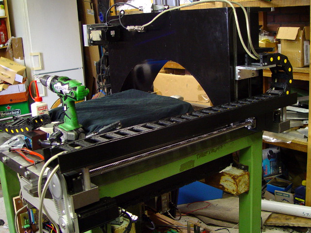

    Quote Originally Posted by aguskov View Post
    however, its toughness is a different story. Probably nothing new here but P/G is excellent in compression, OK in its shear strength and terrible in tension. It's also highly brittle and badly performs at perpendicular loads.
    One could say it behaves like stone
    P/G would make an excellent base, but I would not build an entire machine out of it. Well... I would if the structure is very carefully designed, load optimized, most likely mono-poured and pre tensioned.
    In reality it is not that bad. I agree that epoxy concrete is not the most suitable material for the moving members by itself, but it does allow a degree of freedom of form which may come in very handy and it is quite easy to build large cross section members with it. It also doesn't resonate so easily.
    Images say more than words. Recall my machine under construction with it's EC gantry. EC was chosen for freedom of form and the ability to cast on a surface plate:
    I also have a 'play around' video online: New mill; playing around running G-code - YouTube
    (sorry for the bad photographs and video)
    If I put one ballscrew in servolock, remove the other, and apply 40N to the other side of the gantry to push it out of square then this is the out-of-squareness that results (over a distance of ~750mm):
    That is not bad at all. Most gantries rock much more.
    'limited stiffness', 'bad in tension and bending', etc. are all very true, but also very well solvable by adjusting the design, and it's freedom of form allows optimizations that well surpass the superiority of for example steel for a hobby guy in his shed with limited tools.
    About the resonance: this is not a real test and more playing around, but this is what's happening when I hit the (partially constructed) steel Z-axis column with a hammer:
    Resonance is measured using a 5um linear scale (I'm using linear scales in the feedback loop)
    Doing the same with EC shows a flat line...
    The later would eventually shrink away from the rebar and it would become loose, even a little hurts a lot. That's lamination in a nutshell. I hear there are 0 shrinkage epoxies now, but are they truly 0 or just round up from 0.0-something.
    I noticed warping due to epoxy shrinkage, and I used as little as possible and a low shrinkage/low viscosity type.
    However, you could use the 'fiber reinforcement' tactic. I threw a lot of wood screws in the mix.
    The machine is not up and running yet, but all in all my measurement results are very promising...
    At some point you just have to stop thinking and start doing. Epecially in the <0,1mm area there is a difference between the virtual world and the real world.
  12. #4812
    Join Date
    Apr 2009
    Posts
    28
    Re: Epoxy-Granite machine bases (was Polymer concrete frame?)
    Very good work!!!
    I have a few questions:
    How heavy is the gantry?
    What is the power of the servo? Model?
    Pitch of ball screw and ratio of the belt pulley?
    Many thanks!
  13. #4813
    Join Date
    Jul 2013
    Posts
    27
    Gantry itself weights 80-90kg or so. That is based on the amount of raw materials used; I never weighted the finished gantry. Moving the gantry around is a 2-man job and the few times I had a second pair of hands available I rather used that extra pair for more useful things.
    Servo's are old previous century Omron AC types on analog controlled OMNUC-U drives (these are in fact rebranded Yaskawa Sigma I drives). I managed to trade 3 steppers+drives for these with closed wallet.
    I am running the drives in torque mode using LinuxCNC and Mesa 6i25+7i77 hardware to control them. I could not use velocity mode; I was unable to tune the velocity loop in the drive well enough; it was either a 'huge' following error or an instable motor. Bypassing the velocity loop in the servo drive and letting LinuxCNC handle all the PID stuff improved things a lot.
    I still have to fine-tune those loops BTW, but I have to straighten the screws, mount 1um resolution scales on the Y-axes and complete the Z-column before I can do so. Torque mode tuning is quite tricky.
    The Y axis/gantry is powered by 2x 400W motors running a 1:1.5 reduction to 10mm pitch ballscrews.
    The X-axis uses a 750W AC servo with 1:1 reduction, 10mm pitch ballscrew.
    Z uses a 5mm pitch ballscrew and a 4Nm stepper motor.
    All ballscrews are 16mm diameter and bought from Chai/linearmotionbearings2008. The X and Y screws are using a variant of fixed-fixed mounting to increase stiffness by a factor of 4. These 'skinny' screws reduce rotational inertia a lot, improving dynamics. Accelerating/decelerating the rotating mass is what uses power from the axis drive rmotors. Accelerating the linear moving mass uses less power than one would think, and the milling forces use almost no power from the axis drive motors at all (at least not with my HF spindle).
    And decent dynamics is what I was looking for. It is very well possible to put 15-24k rpm on a 8-12mm endmill in aluminium and produce a scary stream of chips, provided that you can keep up the feedrate.
    All three servo motors provide way, way more power than needed BTW. Since I am running the drives in torque mode I can see the amount of torque required and even with 1G acceleration and 20 meters/minute top speed they don't even get close to their nominal output torque, let alone their three-times-nominal peak rating. 100W motors would have been fine too.
    I see you are from Belgium. Here is a build thread in Dutch on the local CNC forum: ? Bekijk onderwerp - Wat was ookalweer het nadeel van graniet?
