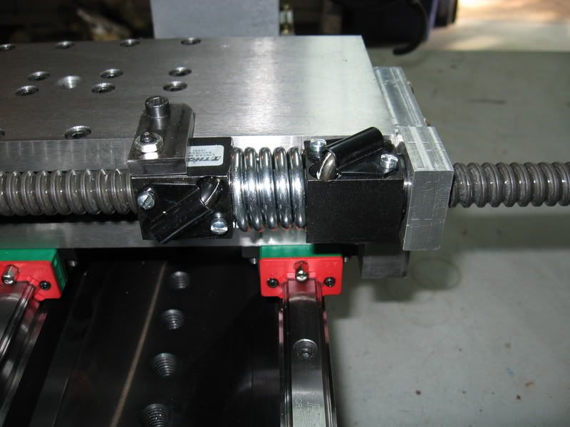

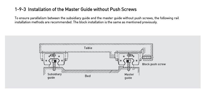

    A few new pics. The rails are mounted and now have formed the lathe bed "ways". I have to disagree with Ian's thought's that the headstock should be mounted first. It is a very long time consuming job to mount the rails and have them run truly straight. To try and do that at the same time as aligning the headstock would be a monumental task of tail chasing. The slightest torque or twist with these 15mm rails can throw them off .0005". IMHO you need to first establish the bed ways by precisely setting the rails which is quite a task to do it to a very low tolerance.
    I made a pusher block mounted to the carriage to act on the 2 linear blocks for the master rail. This will also increase rigidity. For the reference surface I tried using parallels and a long straight edge. But I was not satisfied with the method. Instead I setup the surface plate so it could be used as the reference straight edge to set the master rail.
    My max variance in carriage travel over 12" is ~.0002" but it's at ~.0001" for the first 10" away from the headstock. Now just how good the machine holds this tolerance will remain to be seen. But surfacing the rail risers made a big difference.
    Headstock alignment is roughed in right now. I still need to make push/pull screws. With just tapping to set it I have it set at .0005" out 8" from the chuck. Vertical is out .001" 5" from the chuck rising upwards. That I will leave alone as the effect on cutting is so small it is not of any concern.

    Willy, there is no encoder or sensor in any of the pictures I posted. The rear of the spindle was marked with a white tape strip and I hooked up my tach to measure spindle speeds to verify my belting setup.
    I will be using a proximity sensor to supply a index pulse to Mach3 for threading.
    This detail is taken from the Hiwin installation guide. There are several different methods that can be used to mount the rails and blocks and they are all outlined in the manual.
    I have a 1hp 3ph motor on my 250lb 9x20 and that is a lot of power for that light machine but I do still use the 6 speed belt drive.
    I would probably run such a big motor with very little reduction on this small spindle. Should work fine if you mount it remote or in a fashion where the heft won't distort things.
    Jesse, The mounting bolts for the rails are M4 x 16
    Here are some links to tech specs for these rails and blocks-
    http://www.automation4less.com/linhd3.htm
    Bottom of the page download "hiwinguideway.pdf" 94 page catalog with specs and mounting and installation methods.
    http://www.automation4less.com/linear.htm#pdfs

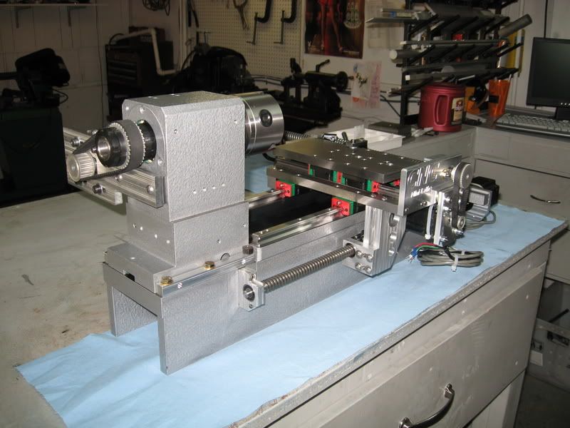

    Worked on the cnc lathe project today. Headstock aligned, cross slide aligned,
    crossfeed dual preloaded nut and stepper belt drive done. Very smooth and very rigid setup IMHO.
    Backlash should be under .0005" on the crossfeed. Won't know for sure until it's running.
    I have not taken any pics yet. A lot of this work is careful setup and alignment details that just eat up the time.
    Steve

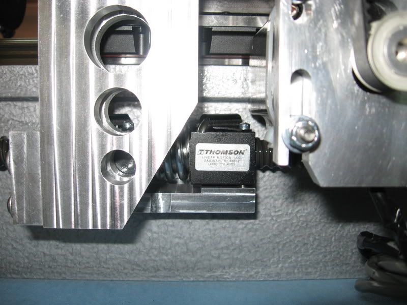

    Very close to making some trial runs
    Current status pics. Dual spring loaded nuts in each axis. Both nuts adjustable for anti rotation. Simplified the motor drive to direct to spindle after testing the old setup.
    I could test it out cut metal with it right now but will wait until the spindle index sensor and limit switches are installed. Tailstock will be after that.
    Steve
