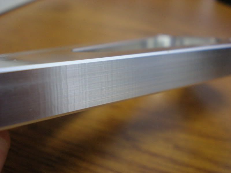

    *the problem is that straight X,Y,Z moves leave a perfect finish, as do interpolation and arcs. The problem is when I do a XY movement for angle like a 45*.

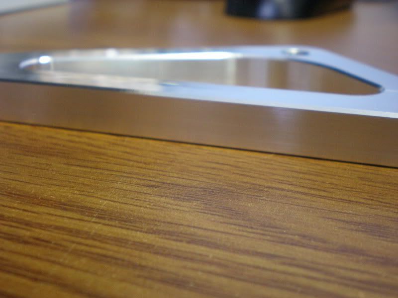

    Here is an example part, the bottom edge is is a straight x axis move, and the surface finish is great:

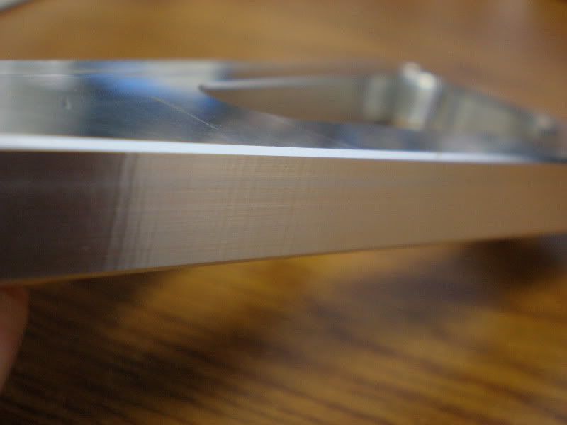

    Now the other two edges:
    The finish quality does not seem to change with feed rate or spindle speeds, I have tried from 10-70ipm and a wide variety of tooling and tool holders with no luck.
    Suggestions?

    How does the ID portion compare in the same angles... Compared to the Profile. Also are you hogging the material out on the 45 angles or is the part saw cut so you only have one side of cutter engaged. Are you performing a finish pass??

    ID and OD profile finishes are the same, yes I am taking finishing passes. There is some sort of motion control problem, I just don't know what.

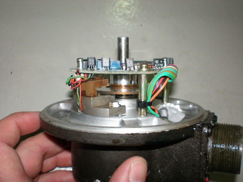

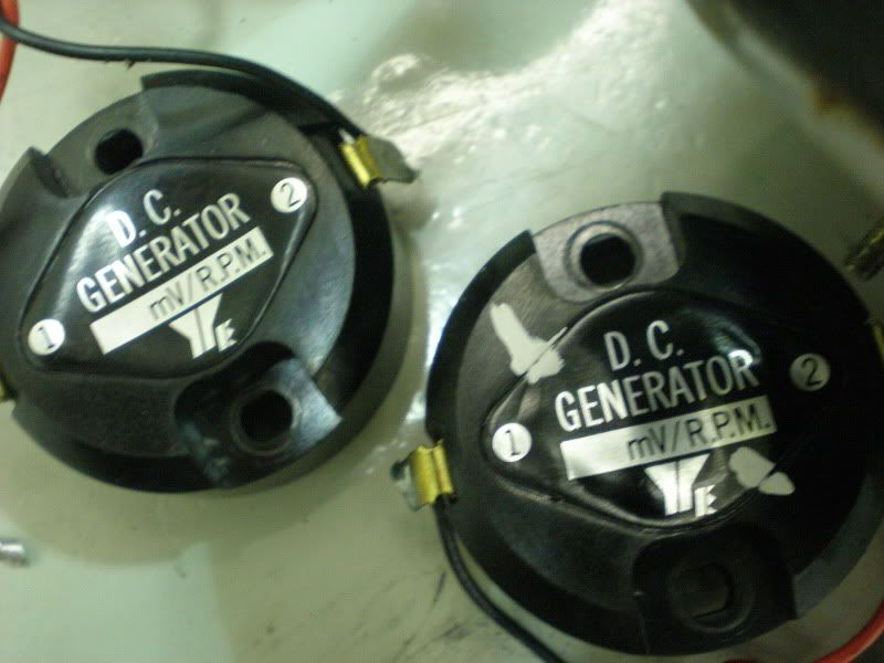

    I sure hope so! Thanks for all the help Chuck. What do you (and others) make of my encoder situation:
    This one is the replacement encoder that resides on the servo that had oil in it, which is not surprisingly the servo that had a lot of dust on the brushes. Where as the other servo's brushes were perfectly clean since they were checked last year.

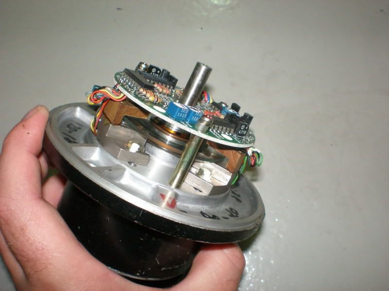

    You can see that this encoder is of a much different construction than the factory one which is pictured below. I was assured by the servo shop I bought this from that it would not be a problem. However when I installed this encoder the axis was going the wrong direction, so I flipped the encoder over and all was good.
    Here is the factory unit:

    Now I noticed that the brushes are offset in height, the color of the wires going to the positions match up, but the sticker that numbers the leads is different, does this have anything to do with me having to flip over the encoder on the aftermarket unit?
    Some advice would be great on this guys, this is all very new to me. Thanks

    Oh I almost forgot, there was also a small m6 washer stuck to the side of the generator on the aftermarket unit, would this be responsible for any problems?

    Looking at your pictures I would guess the problem is with your spindle and nothing to do with your linear axes at all. Worn or incorrect preload on the bearings would cause this type of surface finish. It is very difficult to diagnose these problems without expensive metrology equipment but I think its worth considering.

    If it were a problem with the spindle shouldn't I see some of this surface finish issues in arcs, circles, or straight moves?
    I will say the spindle is super quiet.
