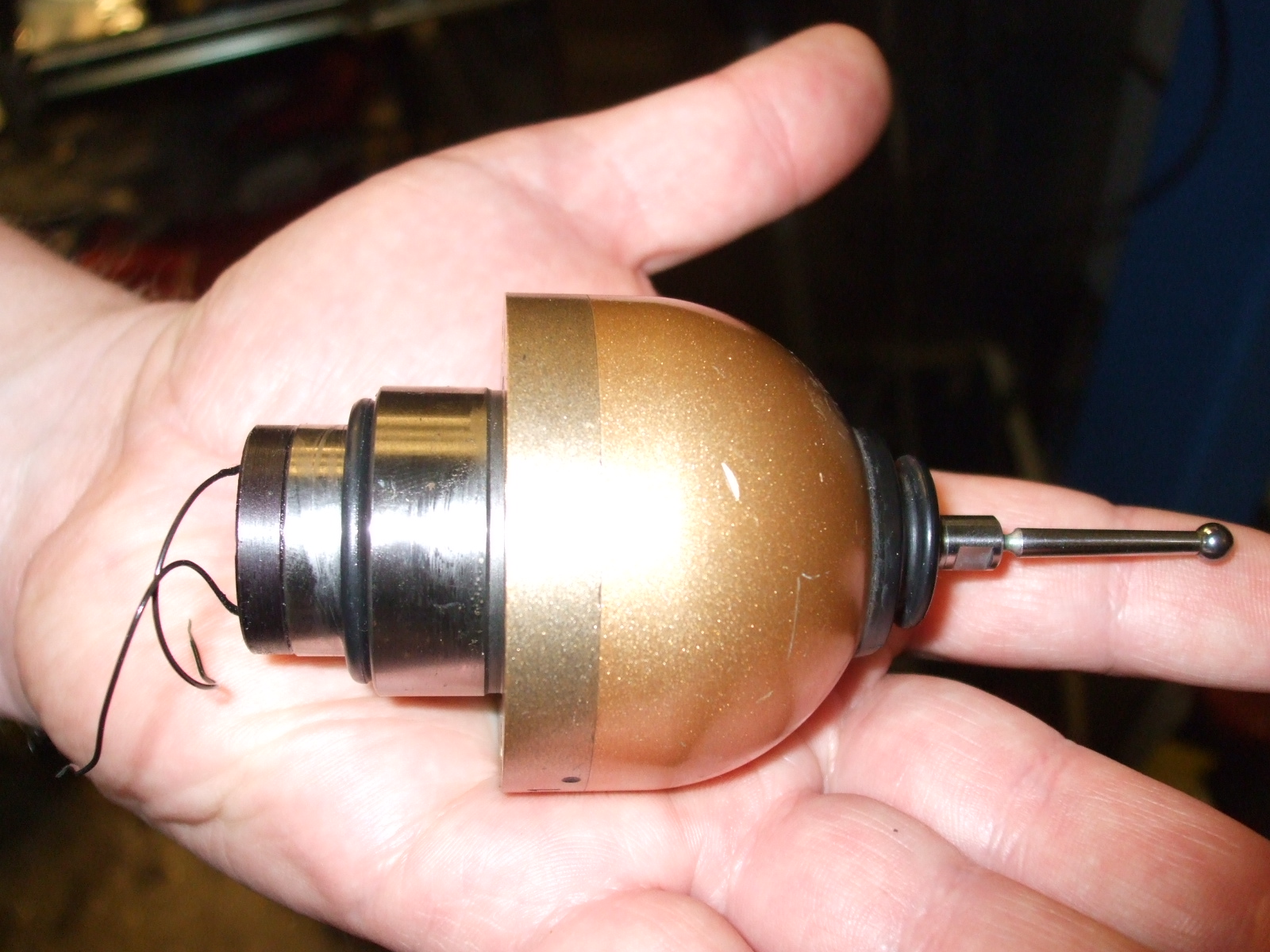

    This is the next thing to get hooked into emc...
    cannot wait (seems to be a renishaw knock off)
    sam
  18. #38
    Join Date
    Oct 2005
    Posts
    169
    This will be interesting!

  20. #40
    Join Date
    Oct 2005
    Posts
    169
    Nice. I have seen a lot of people probing in the machine with EMC2. Have you checked a ring gauge to check the accuracy? That would be very handy if it was a reliable check.:rainfro:
