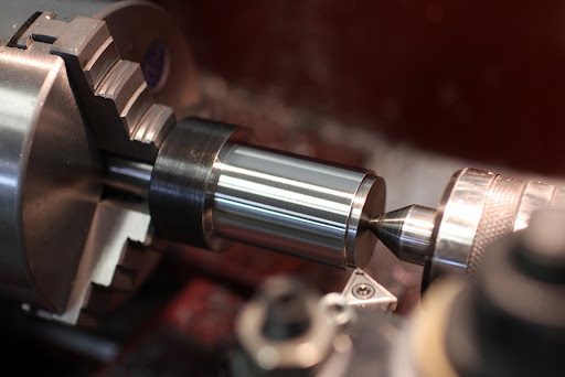

    On Don's recommendation I've gone ahead and turned my blank. I spent a few hours tuning my machine up and got to work. Pretty happy with the results and going to test it tomorrow. So far it looks like it has saved me a tool holder ($$) and having to buy a $130 arbor. Thanks for the idea Don !!!
    All done on a 9 x 20 lathe in about 2 hours, could have been faster but I wanted to knock this out in one shot. Only the blank was used for all material.
    The Process
    - I turned the blank to .75" diameter all the way until I had .640" thickness left on the TTS holders flange. Just incase I decide on a ATC later, I'll have the room to add a groove.
    - Then turned the flange locking nut on the front half of the blank to 0.4985" diameter at .3" in length, and also leaving .1" for the flange (now both pieces have the same diameter).
    - Tapped drilled .201"
    - Clearance drilled .25" at .46" depth
    - Parted the locking flange at 0.4" in length
    - Bored a 0.5" pocket in the TTS holder at .323" depth
    - 1/4-20 tapped the TTS inner 0.201" tap drill hole (use lots of fluid !!!)
    - inserted the locking flange and faced the outer side by .03"
    - Bored a .375" diameter pocket at .222" depth
    - Flipped the locking flange around, then very carefully sanded until it was a perfect fit.
    I was only able to take so many photos while doing this, some parts may jump.

    twocik: I see that you are using a 3jaw chuck to hold your arbor while machining. what kind of runnout do you see with the arbor mounted in the Tormach spindle? Also I find the Micro tap guide very handy for tapping in the lathe http://www.cartertools.com/fmpdtg.html
    Don
  10. #10
    Join Date
    Feb 2007
    Posts
    1041
    Just checked and surprisingly looks to be about .0002" - .0003" out from the inner bore. How close did you get ?
    Can't get better than that unless it was machined in the Tormach spindle. Good Job!

    Thanks, yea I spent a few hours tuning the beast! I spoke with a Tormach tech today and they have a TTS slitting saw coming out very soon. Something to look forward to, until then I'm going to buzz some parts. :wee:

    Quote Originally Posted by twocik View Post
    is that measurement taken once the tool is mounted in the tormach spindle? i would be really surprised if you only have two or three tenths of runout between the shank that goes in the r8 collet and the tool holding end if you flipped the part in a 3 jaw chuck while making it.
    By "tuning" do you mean adjusting the mounting for the three jaw chuck so that you have minimum runnout for a particular diameter?
  15. #15
    Join Date
    Feb 2007
    Posts
    1041
    "is that measurement taken once the tool is mounted in the tormach spindle? i would be really surprised if you only have two or three tenths of runout between the shank that goes in the r8 collet and the tool holding end if you flipped the part in a 3 jaw chuck while making it."
    Yes. No flipping, the blank was mounted the whole time until I was finished. The part I talk about being flipped is the locking flange that the 1/4" socket head screw passes thru.
    "By "tuning" do you mean adjusting the mounting for the three jaw chuck so that you have minimum runnout for a particular diameter?"
    Sorry guys It's not shown in the pics and forgot to mention that I turned the first few layers on the Tormach mounted in the spindle with a turning tool in my vise. I took off a few layers and then brought that to my lathe. Next I tested the blank in the 3 jaw chuck with my dial test indicator and started turning.

    [QUOTE=twocik; I took off a few layers and then brought that to my lathe. Next I tested the blank in the 3 jaw chuck with my dial test indicator and started turning.[/QUOTE]
    So you chucked the blank in the 3 jaw, turned it on your lathe and then checked the finished arbor in the Tormach spindle and runnout was < 0.0003" ?

    Don yes that's correct, I'll test it one more time just to make sure my eyes weren't going crossed being up that late and all.

    You did way better than I could with a standard three jaw chuck in the lathe. The only practical way I could have gotten <0.0003" runnout would have been to chuck the almost finished arbor in the Tormach spindle and machine the finial process in situ.
