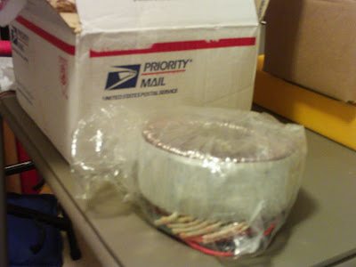

- Antek Transformer - Toroid Transformer (currently wired @ 24VDC) wasn't aware of Vrms at the time... I think i can rewire it for 48VDC, but my control board can't take more than 36VDC. Used this to make a powersupply with help from my EE friend.

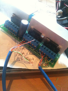

- Control Board - HobbyCNC 36VDC board/drivers only. Soldered this badboy up. Added .125" aluminum angle iron as heatsink for drivers.

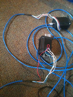

- 3 Keling 425 oz-in Steppers - Wired these in unipolar mode running at 2 amps. I'm concerned about power over lines because we used the unshielded RJ-45 cable i had (8x24AWG wire).

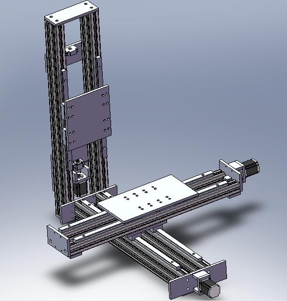

Due to the realization, I can't go any further without a solid plan, I started modeling everything I could. Here is just one axis I am working on modeling. (Work in progress)

I feel the calling to change to some shielded wire, and with higher gage. I'm not sure what is optimal yet, haven't dug into the equation for resistance based on diameter. Any vendor or product suggestions?
