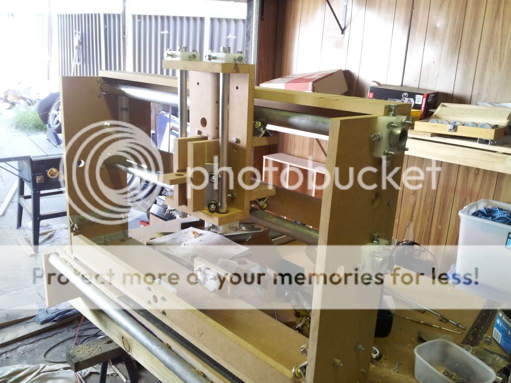

    Got my gantry sides done yesterday after 4 tries Was fighting with a way to mount them so I can measure the width of the bottom until I worked out a way to do it at midnight last night. Will take some pics today after I tidy up a bit.
    Craig - Apparently it can be done, I have seen it a couple of times somewhere on here. I'll use an offcut and grind it down to look like a tap and then try tapping a thread. Just trying to be cheap right now, if it doesn't work I'll splash out for dumpster nuts. The thread on mine is prefect, no marks at all. It even survived hanging out the window of my Ford wagon, 12ft just didn't fit inside the cabin. Tied it to my passenger side wing mirror for the 2 minute trip home
  6. #6
    Join Date
    Nov 2011
    Posts
    211
    So here is my weekend progress. Excuse the messy surrounds, professional at work and all that Just kidding....
    The gantry slides easily along the X-axis, I can push it with just a finger. All bearings are in contact with the pipe. I have included a pic of my X-axis trucks with their little aluminium spacers between the angle & the bearings. I found that this allowed a larger contact area on the pipe unlike what 2x 5/16 nuts would give.
    I have to finish up the base of the gantry and gett all the right size holes drilled for the lead screw. Right now there is just 1/8" holes to allow me to drill in the right place on the ends, that way I ensure all the holes will line up from end to end and through the gantry base. I cut the chopping board anti backlash nuts today to, I won't try and tap them until I know exactly how much acme screw I have over.
    The Y-axis is like a buildyourcnc Y-axis, at the moment it is only 1 piece of 18mm MDF but once I have the ali attached to the top and bottom I will sandwich the 18mm in-between 2 12mm pieces. That should strengthen it up somewhat.So once I have the gantry base all buttoned up I will move into the Y and Z axis and wing them as I have done with the X. So far that seems to have worked OK, hopefully it will continue that way

    So here's a pic of the gantry, it is now on the base while I check a few things. Will get more pics tomorrow.
