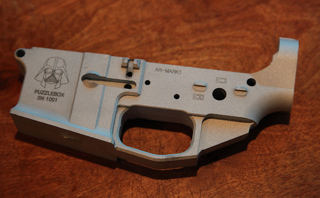

    Drivers side completed
    updated the blog again.. heres the drivers side all completed.

    How did you make the code for the Vader head?
    Looks great!!!!

    Quote Originally Posted by HLF Ordnance View Post
    Looks great!!!!
    Adobe Illustrator.. then imported into rhino just to align etc. Then i just exported to sprutcam and did 2d contour and selected em all. went 0.01 deep with a 60degree engraving bit.

    Quote Originally Posted by tbaker2500 View Post
    Very nice, man!
    How many different tools did you use?
    prob about 8 or so.
    mainly
    1/2" 2 flute for contour and flats.
    1/4" 2 flute for some of the deeper small pocketing
    1/8" 2 flute for the one small pocket.
    1/2" ball nose for 3d
    1/4" ball nose for 3d second pass
    1/8" ball nose for final 3d
    1/2" spot drill for locating holes and varios drill bits for the appropriate sizes.

    That's an impressive piece of work.
    I have also used sandblasting to remove tool marks but I never get it quite as uniform as that, especially in blind corners. It's very easy to over do it.

    Very nice work!
    It looks like the mag well is still solid. How are you planning on finishing it? Are you going to mill it or are those normally broached?

    Not quite sure yet
    I think im gonna drill the corners out and just try mill it.

    Some of the builds I see do just that. Drill the radius points then mill it out and file the tangent points till magazines fit right. If you can find somewhere to do it EDM is something that comes up pretty often.
