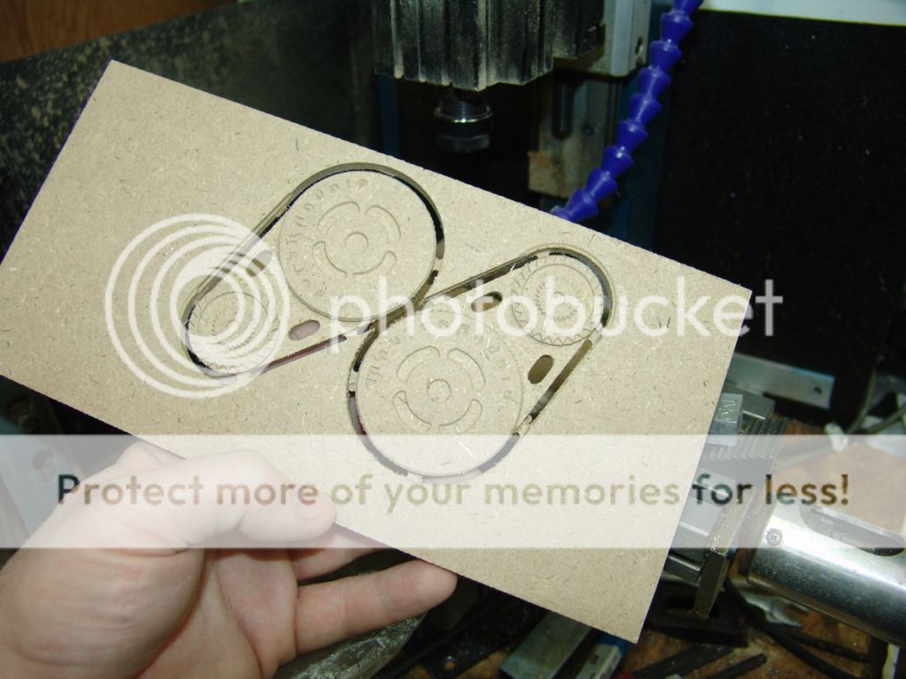

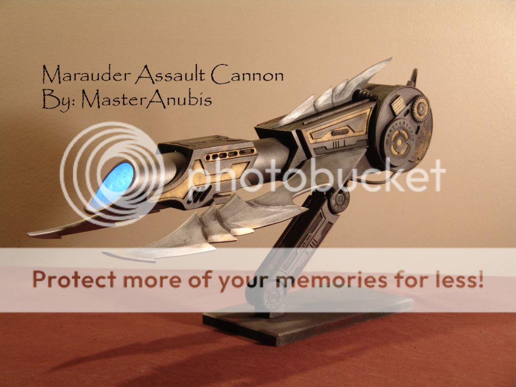

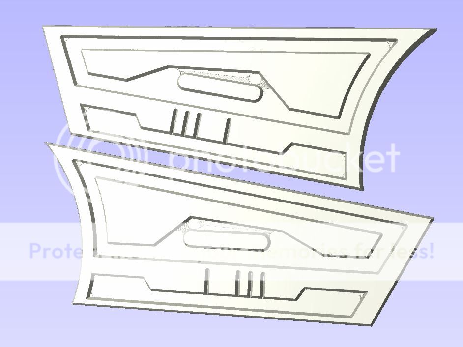

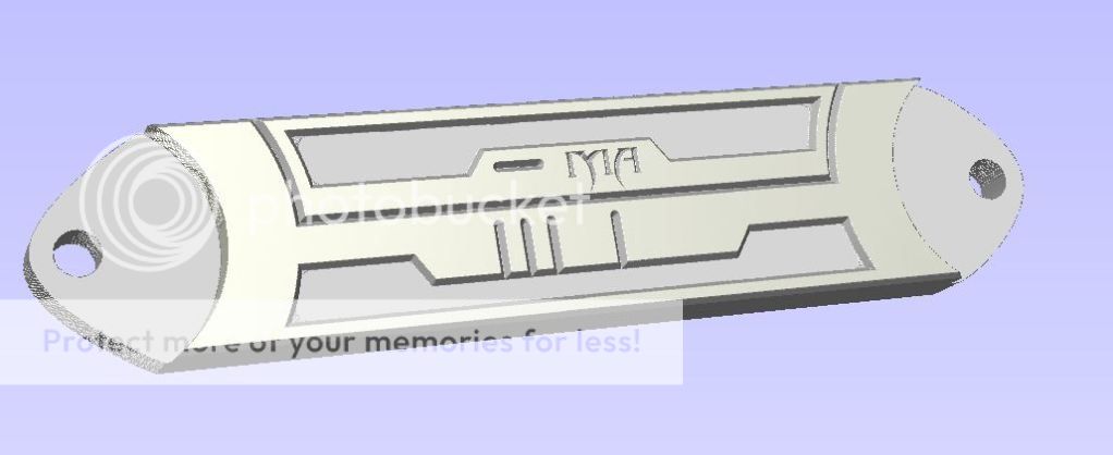

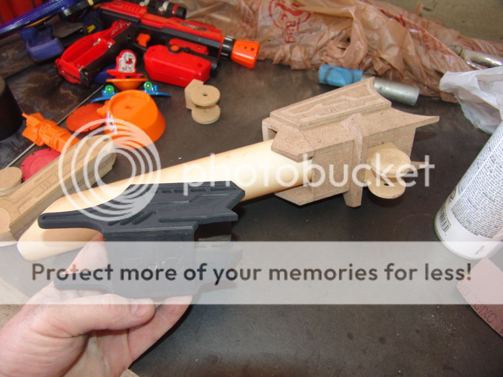

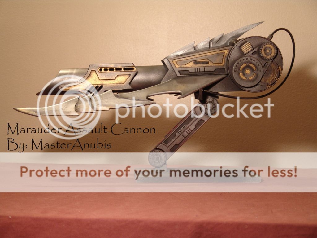

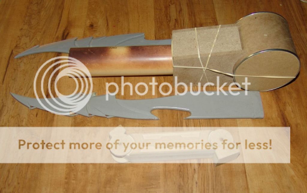

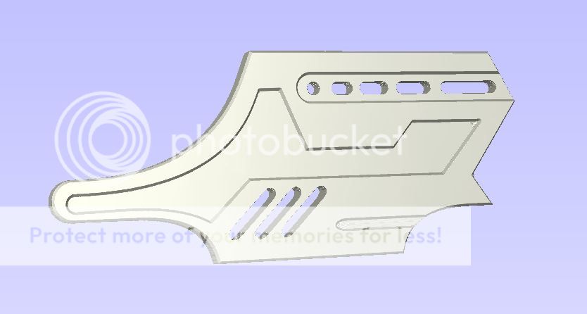

    This is a little pic heavy, but that's the point of this thread. Right?
    I add the tabs after I take the screenshot of the cutouts.
    This was for a Predator shoulder cannon competition on thehunterslair.com I entered. Everything I cut I did on my Taig MicroMill so I had to work withing the space constraints.

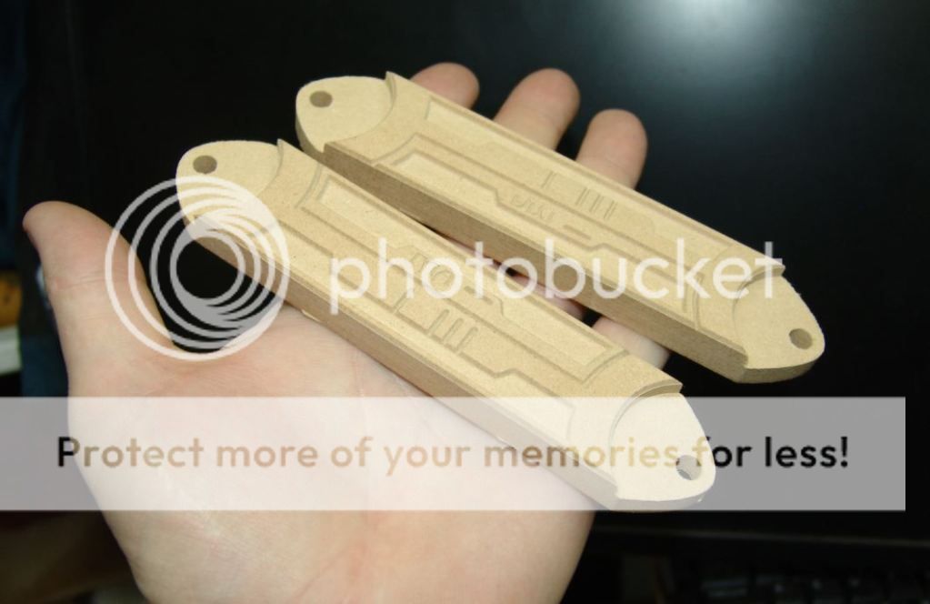

    The two outer peices of the arm. They sandwich another piece to get to final thickness.
    The disks to cover the can's end and the the box peices. At this piont the arm is 9 separate piece. When mounted it got 4 medalion covers over the dowels. The blades are cast from resin from my orginals that I had carved out of ABS.
    I'm really surprised how well MDF keep details. I used green scotchbrite pads to 'debur' the pieces. In the end I primered scotchbrited again and painted.
    I used a total of 31 separate pieces for this project. I cut a few more.

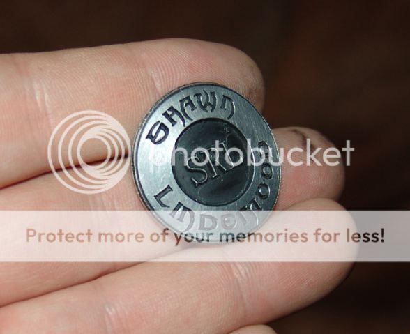

    on another note, this is a head tube badge for a mountain bike I cut to see if I could do it. I cut it out then bent it with a body dolly on a sand bag. Then painted it and used acetone to wipe it off.

    That Gun Looks awesome.

    Very nice work....
    You've got some great model making skill, the CNC stuff is just the icing on the cake. :-)

    Thanks guys. Yes the CNC has added more accuracy to things I build, that's for sure. I just got the demo of Aspire to see if I can get that to work for me. I haven't had time to try it.
    I forgot to mention that the end mills I use are a 1/8" 60 degree V-bit and a regular 1/8" end mill.
