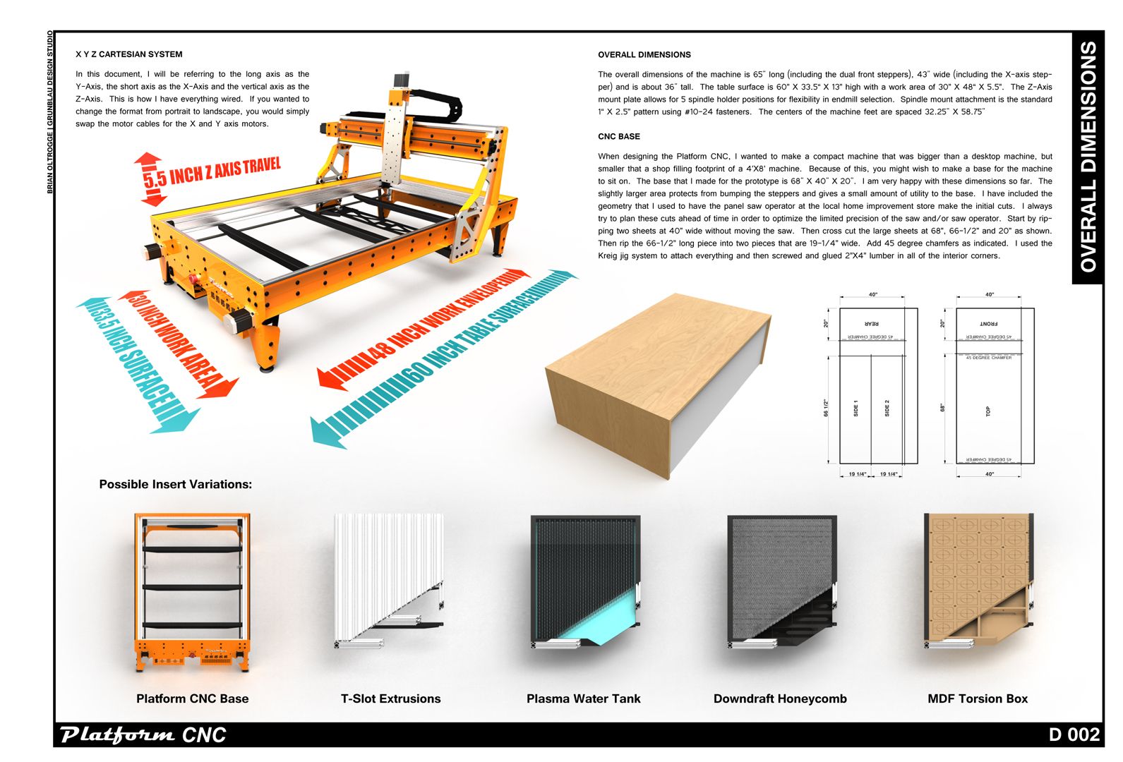

    I wish there was more time in the day! I have a couple new things to share in the next weeks, but if you emailed me, keep an eye out for an announcement for the next run of kits!
    Quote Originally Posted by gene8522 View Post
    Brian,
    I added my name to your next run of Platform. In the mean while would you have time to post a basic dimensions sketch of the Platform CNC. I.E. foot print, height of the table, overall table size, cutting area X,Y,Z? I have a Regenerative Vacuum Pump that should handle the Platform table size. Have you looked into using a vacuum table?
    Absolutely! I initially was developing my first insert as a vacuum table, then Makerfaire happened and I am currently just using bolts and double sided tape. You can see the vacuum top below on the torsion box. I have purchased t-slot inserts from Rockler and will likely go this route for my next insert. I am continuing to also develop the plasma table as well...
    Here are some overall dimensions for the machine from a page in the assembly document that I provide with the machine..
    (right-click, open image in new tab)
    The internal void space of the table is 30-1/2" wide X 57" long X 3.75" tall including the 3/4" thick top..
    Hope this helps!
    Brian

    Thanks Brian,
    Just one question...... How high is the top of the table from the bottom of the feet?
