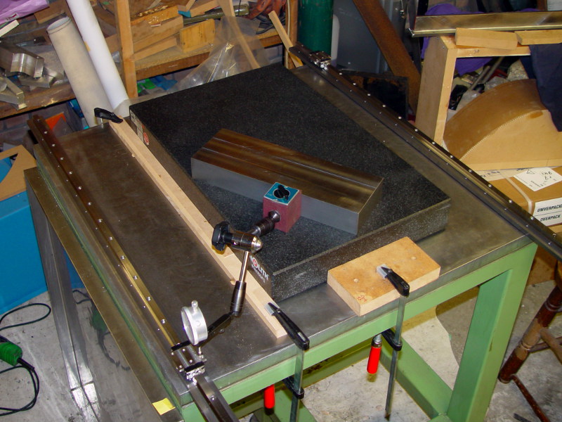

    Nice to see you using a surface plate to create a flat plane. The so called "negligible" shrinkage of epoxy appears to be working against you, that might explain the bow
    Did you set the screwed rods very tightly in the tapped holes at the back of the steel support rails? I suspect you did?
    Did the mould exotherm much and heat up? that might cause contraction on cooling?
    Looking at the images the you have achieved a very good finish what percentage of epoxy did you use by volume?
    I have cast on a surface plate before and it worked well using cast in tapped metal inserts to attach other parts to later. This should eliminate the differential shrinkage that appears to have bowed your rails as shown in the following link.
    The shrinkage seems to be the root cause. The 'bow' is also worse on the larger first cast (lighter part on the picture in post #4739), and less on the smaller remainder (darker part; I played a little with dye percentage).
    Hand-tight and then a little twist with a pair of pliers. Not extremely tight, but I did use some Loctite 2701 on the threads to make a very solid connection.
    No. The epoxy system used is very, very slow. But I did heat the mixture slightly on the top with ~35C air coming out of a modified hair dryer to keep temperatures above 20C. This is done because I was not able to get the room temperature up to above 15C.
    I suspect that I should not have done that....

    Some machine builders I have seen on the net using epoxy mineral cast frames bed the rails, rail supports and other parts in an epoxy grout as a secondary operation after the main casting has been made with threaded steel inserts placed ready for attachment of other parts later, than allowed to cure for a few days.
    This is a good method, particularly if you design in small jack screws to bear against the main casting and oppose the actual attachment cap screws to correct any small errors. They can be in the smaller parts or on the main frame itself
    Actually an old idea, My lathe a 30 years young VDF 21RO originally had a copy attachment. When I removed the attachment assembly all the parts had small grub screws to precisely jack everything into alignment against the main bed casting. I have seen it on other machines too.
    I like the way you placed the small surface plate on the machine base to slide you indicator around (your photo above in this post)
    So extending the jack screw idea the process is simple.
    1. Set the part up with jack screws and your measuring method. Then carefully remove (or use a pourable grout)
    2. you may need to make a dam around part to contain the epoxy grout. (Or better still shallow pockets in the casting to create a dam), the pockets do not have to be high accuracy.
    3. Pour or place the epoxy grout. and install the part
    4. Recheck the alignment before the epoxy grout sets!

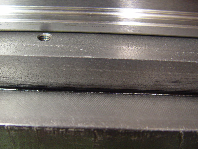

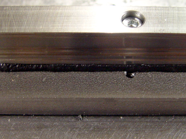

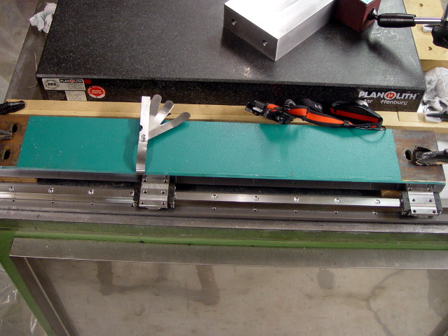

    I used that setscrew/jackscrew thing for the rails on the table:
    There are small rubber rings between the strips and the table surface to keep the filler injected between the parts away from the cap screws used for mounting the rails.
    Straightening the rails was done using a reliable flat ruler and a feeler gauge. I straightened measuring on the reference surface of the (preloaded) carriages. After all that is what must be straight:
    No need for eccentric discs; the mounting holes in the rails are slightly oversized so some adjustment is possible. +/- 0,15mm or so, which should be plenty.
    After levelling and straightening the rails a few times (things tend to pull slightly out of 'flat' after the first adjustment; a second session is needed to correct that), I filled the space between table and strips with an epoxy + quartz flour + 0,25-0,4mm aggregate. Also epoxy concrete, but without the larger aggregate.
    The 'master' rail was secured horizontally using a simple bead of EC:
    The mix used for this is very stiff and contains the absolute minimum of epoxy and maximum of sand (0,25-0,4mm). This makes a very stone-like mass which is fairly easy to break if I need to replace the rails for whatever reason.
    Note: the slave rail was not secured horizontally. That's not necessary if the gantry is stiff enough.

    I tried injecting the EC between the table and strips using a disposable syringe, but that does not work without designing in special features such as holes for injecting.
    You will have to mix up to a peanut butter like consistency to prevent the quartz filled epoxy from running out, and then it is too thick for a syringe and generally hard to force into a small (1,5-2mm) gap. The sand filler also tends to block the exit of the (20ml) syringe.
    What I did instead: I placed clear packing tape (an excellent release agent) on all the surfaces I didn't want any epoxy on. Then I put a large bead (10x10mm or so) of EC next to the strip, and used a piece of aluminium strip to force the EC bead into the gap by having the aluminium contact the table/strip and forcing the aluminium towards the gap. This is a messy job. You could also use a putty knife, but I preferred the longer (~500mm) aluminium strip since it prevents EC from oozing out and going everywhere at the sides.
    Repeat a few times until a royal amount of filled epoxy has exited the gap on the other side so you are fairly sure that there are little or no air pockets left. This method requires you to mix up much more EC than needed to fill the gap, but the minimum batch of epoxy I can accurately mix up is 65 grams. Combined with quartz flour and sand this results in a full disposable soup mug. Plenty to fill many gaps.
    Then it is mess cleaning time. As you probably noticed while working with EC, the stuff is fairly hard to wipe away. Paper towels etc. tend to smear the 'mud' around and leave grains of sand everywhere instead of absorbing it, Some acetone or thinner works, but I don't really want to use towels drenched in solvents near fresh epoxy. Some of it might end up in the fresh epoxy. But luckily 'fight fire with fire' also works with EC: you still do have a little neat epoxy in your first mixing cup since you are supposed to weight component A and B, mix in a cup, put the mixture in another cup, mix again, add pigment/fillers, and then use it. Put some of that clear epoxy from the first mixing cup on a paper towel, and use that to wipe the area around the gap clean. Then remove the packing tape, and voila, there is your shiny bead.
