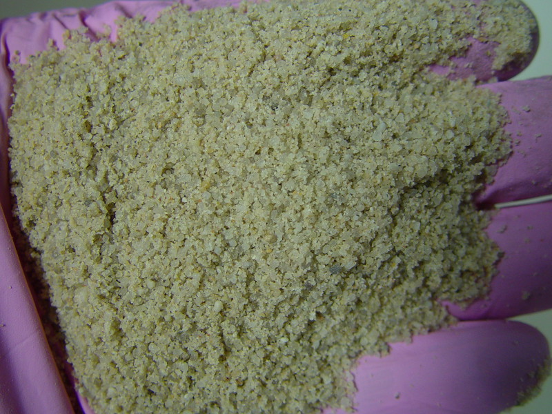

    Not that much luck with those very dry mixtures.
    Sorry for the lack of interesting pictures; working with epoxy and taking photographs does not combine well.
    Sorry for the nice pink gloves too; I get these for free (and yes, they are scented as well :drowning:)
    Mix 1:
    - 1/3 60 micron microballoons
    - 1/3 0,25-0,4mm sand
    - 1/3 0,8-1,4mm sand
    With 0,85% epoxy and 20 minutes of mixing the mixture behaved exactly like dry and looked like it came directly from the desert, except that the microballoons didn't dust out that much.
    I had to increase epoxy content to 2,25% by weight and do some _very_ thorough mixing before something started to happen:

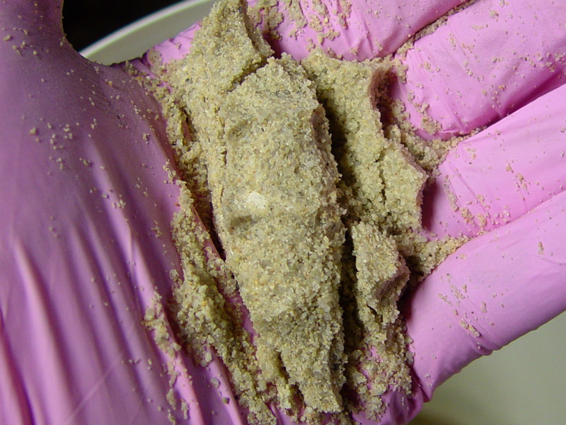

    When balling in the fist:
    Not quite there yet. I stopped adding more epoxy; that would go towards the mixtures I am already using.
    I did try to ram a sample though. Didn't work too well; hitting the mixture here made it rise there. Those microballoons act like ball bearings; I saw that behaviour before. But OK, we shall see how it turns out after curing.

    Preliminary conclusion is that I like ~8% by weight of epoxy much better. That is a zero-slump and still fairly dry mixture. You can make 'snowballs' out of that if you wish.
    A sidenote: the epoxy system I use is designed for laminating glass/aramid/carbon, is very thin when mixed (250mPa.s) and has hardly any 'tack'. Between the gloved fingers it feels more like a drop of engine oil than a glue.
    That certainly does not help when forming a ball in the fist, but it should not matter when rammed into a mold.

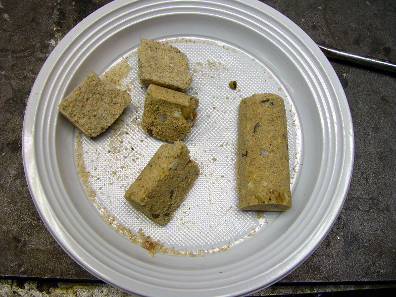

    I did not do the postcure; it would not have made a difference. The first two mixtures were very weak, only the last one with 2% epoxy and 40/60 gravel/sand is OK.
    It took some effort to destroy this small sample, but less than the wetter mixtures tested before.
    The sample is also porous. You can blow through it.
    I do have a larger sample. Will put that through post cure, and see how tough it is:

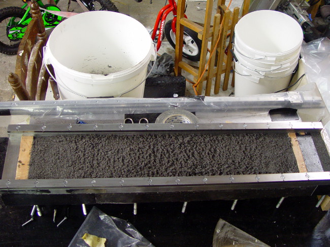

    A dry mixture in a real application. I decided I like dryer mixtures.
    Not sure about the amount of epoxy; I mixed until the mixture looked and felt right (it is slightly 'sluffy' then). It is somewhere around the 4% by weight mark.
    Aggregate mixture is 64% 0,25-0,4mm quartz and 36% 0,8-1,4mm quartz. Layer thickness is only 9mm, so no larger aggregate this time.
    When mixed thoroughly you can model sand castles with this mixture.
    Loosely spread out over the surface:
    After some hammering to compact it:
    This really looks pretty. Density is ~2150kg/m3. Not bad either.
    Closeup:
    Still a little too much epoxy. The sand sticks slightly to the piece of wood used to compact it and pulls out when moving the piece of wood. But this is not really a problem; it doesn't harm the surface finish.
    @Stonemason101: 8,5% by weight of epoxy gives me a quite muddy mixture which doesn't hammer well. So far I do like the lower resin contents. It does give a porous end result due to the voids between the grains not filled with epoxy, but on the other hand it is almost impossible that these mixtures shrink.
    For the final mold I will use a 8-10% mixture for the shell so it will flow more easily into voids, and a dryer mixture for the inside.

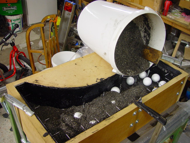

    Today I poured the gantry:
    (ehm, 'poured' is not exactly the right word...)
    Several layers. Bottom layer, thickness a millimeter or so, is a mix of hollow glass bubbles and epoxy. Enough epoxy to have it still flow. This will give a solid surface which is sandable if I need to.
    Layer above that: a wet mix with aggregate 4mm-0,25mm. 8% epoxy, maybe even more. I mixed until I liked the consistency. This layer must adhere to several parts, so that is why I used extra epoxy.
    Then, several layers of 4mm-0,25mm aggregate, a bit of quartz flour and 3% epoxy (30kg aggregate, 1kg epoxy). Not too much quartz flour; that tends to increase the epoxy need of the mixture.
    3% of epoxy given a mix which is very nice to hammer down. Which I did using a manual hammer and a piece of wood wrapped in packing tape by the way; more control over the process. You can see the low resin content; the mixture is just not as black as the rest even though there is still 2% pigment in the epoxy mix.
    The last layer is a little more wet once again; the shell takes most of the forces and I do not want to gamble there.
    Surface finish on the wet last layer is not that good. The wet stuff sticks to everything.
    The polystyrene balls are there to reduce weight; this will be a moving gantry. They are distributed as irregular as I could; in electronics regular structures are bad for resonances, in mechanics I don't think it is different.
    BTW: I used some reinforcement too. Saw the box with woodscrews on the workbench, and thought 'why not?'
    I also put in old pieces of EC tests. Sanded them with 80 grit and threw them in. It is the same stuff and otherwise I would just throw them away.
    And now, the hardest part: waiting....
