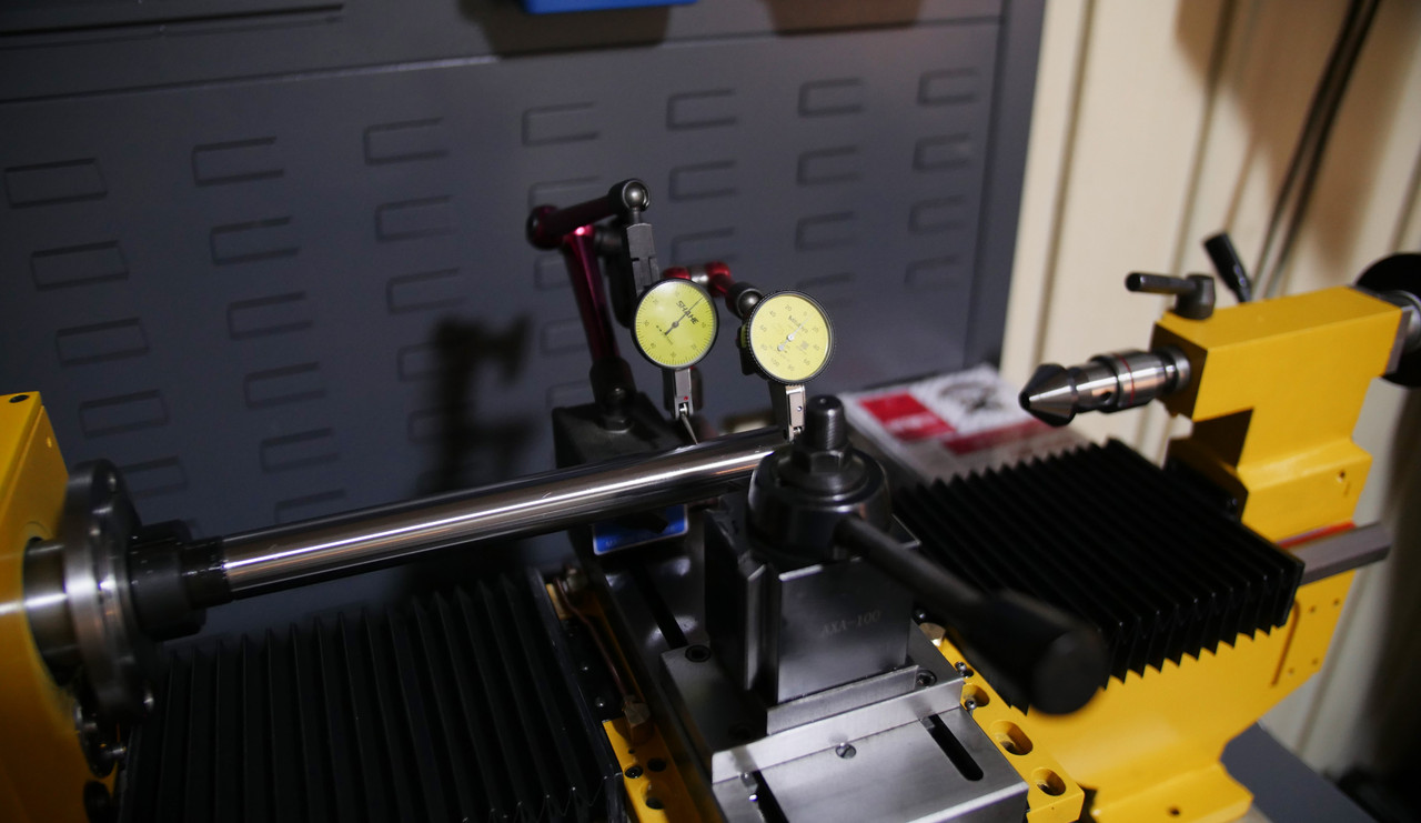

    I recently needed a part in 80mm length and just couldn't get it done without a nasty taper (twist). Between center revealed the equally nasty bent.
    And so I went ahead and purchased a pair of precision levels (0.02mm) and a MT3 precision grounded spindle test bar (0.005mm) of 250mm in length.
    To find out my C4 is severely shot and need complete overhauling of the bed ways.
    The good news is the spindle bearings are impeccable. No play in them when I pull/push on the chuck and the MT3 bore (measured TIR) is running true at 0.004mm, of which on itself is quite incredible and recomforting.

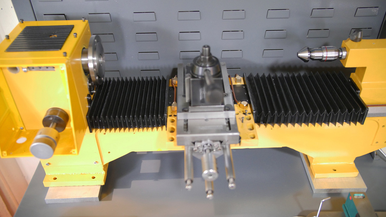

    Update:
    Success! I had the SIEG SC4's ways reground all around and I couldn't recommend it more to anyone who is looking for a benchtop machine-tool that mimic an industrial type accuracy & usefulness. I also had the saddle overhauled, although not a grinding job but a manual scraping procedure. The results/alignments are so stupidly straight and so can be ignored all together. However, that brings a whole other problem; how to maintain that and level the lathe properly that is (I'll update in another post to describe what I've done to mitigate that issue.
    Result (over 250mm):
    Vertical alignment = 0.004mm
    Horizontal alignment = 0.006mm

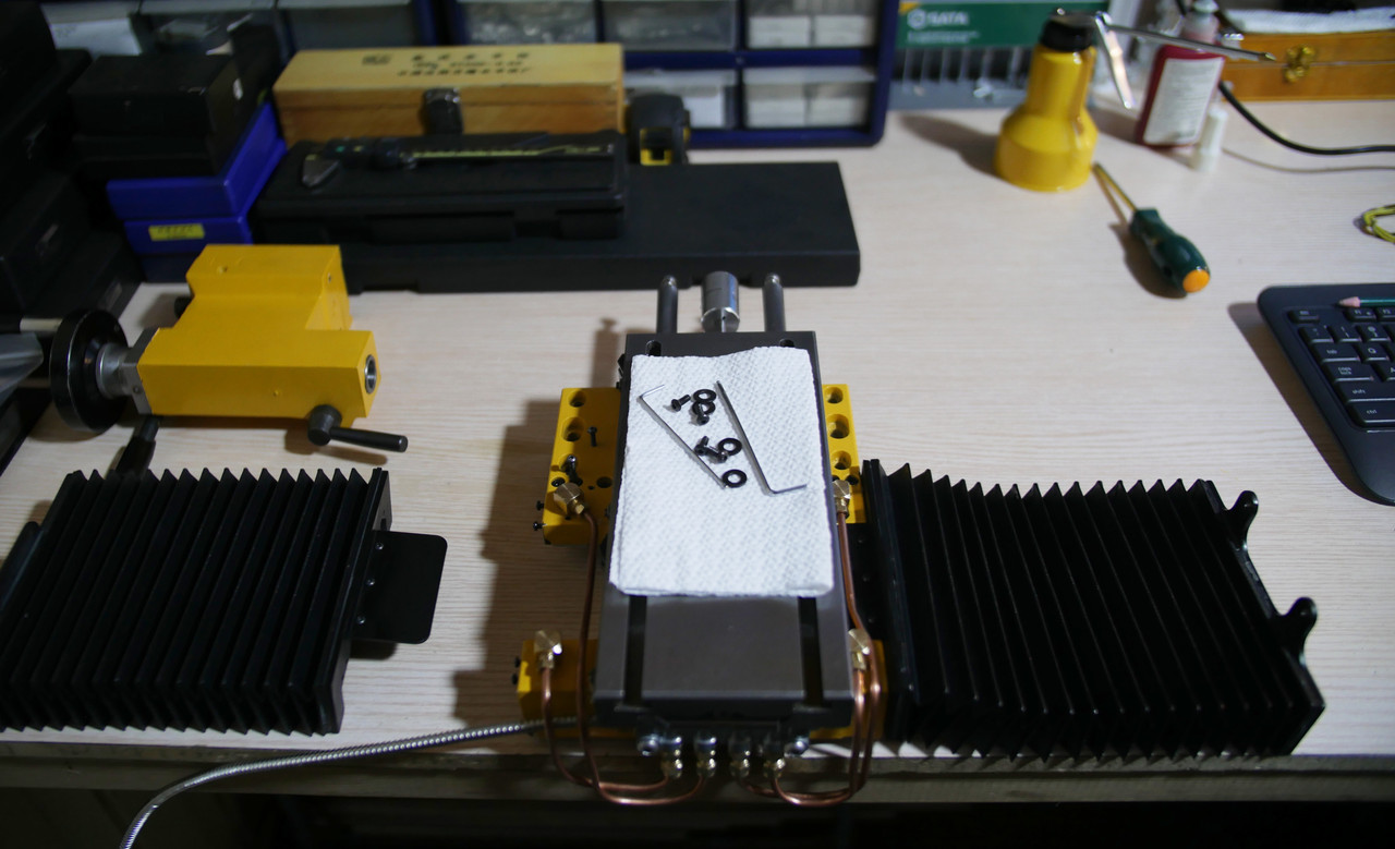

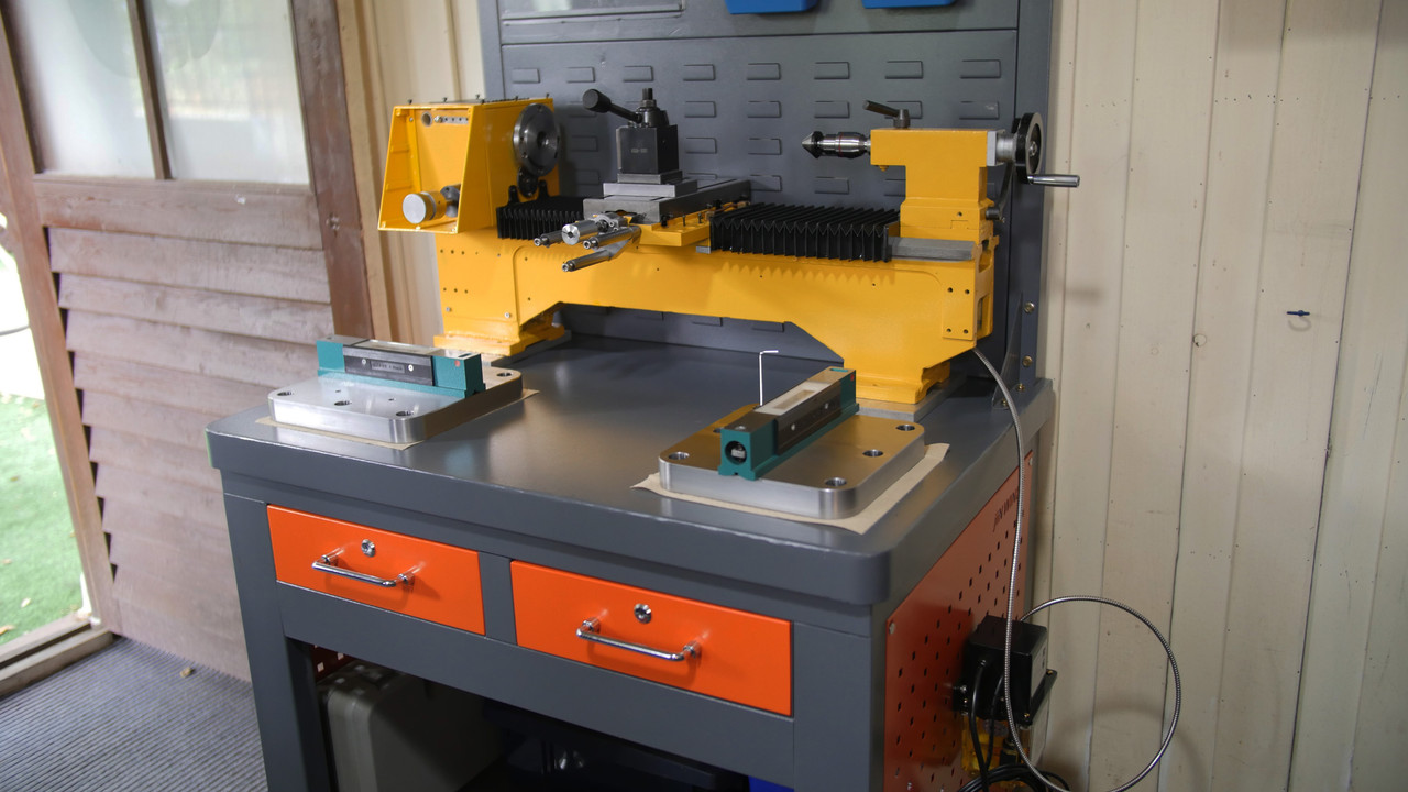

    And so now that I have (what I think) an amazing tool, time to add in efforts in getting this maintained longer term. First thing I did is to listen up to what the professionals have to say, and that is 1) adding an automatic oil system, 2) keeping the ways clean and 3) find a rigid surface for leveling and tracking the changes.
    The first challenge is pretty easy, there are already oil ports on the saddle that can be punched out and so I've re-used those ports and routed so oil lines. The second one required custom way covers to be outsourced, and the third one involved getting a dedicated workbench with a solid steel top with a thickness of 8mm (quite heavy furniture!).
    That heavy furniture didn't solved the leveling requirement though, and so I machined two plates out of 30mm thick steel. The plate has four leveling setscrews (precision fine threads/0.5mm) on the corners, and the inner holes in between those setscrews are for M8 bolts to secure the plate to the workbench. That way I can independently precision-level this lathe (head & tail), and keep track of it's movements with time.
    I'll update with a last post when the lathe is re-assembled and functional. Many of the parts are still off, hopefully I'll have time to finish this overhauling project this coming weekend.

    Attaching the precision leveling plate drawings for the SIEG SC4 footprint, in case someone else fancy giving his/her mini lathe a grinding overhaul. You'll obviously need a way to level this accurately and keep track of where it goes with time. The four leveling corners requires 0.5mm pitch thread (ball-end setscrews) for fine level-adjustment. Lastly I had mine precision ground but that's not a mandatory requirement, surface milling is sufficient.
    30mm thick steel (27'ish kg), this ain't going anywhere. Farewell silly cheap and destructive wood bench.
    All the best everyone.
