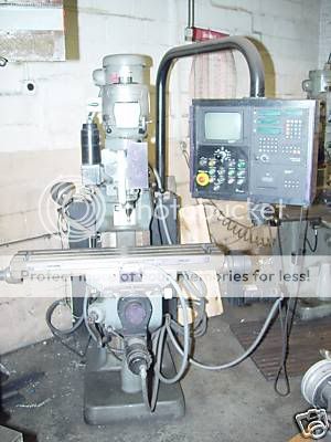

    I don't see much information on the Mesa 5i20-5i22 setup with emc2. This is one of the options I am looking at for a retrofit on my bridgeport mill. I will be replacing a heidenhain tnc 135. I have linear scales on XY and Z axis. I believe that I have stepper motors on all tree axises as well. I am not sure about encoders as the control is limited in it's capablities.

    My mill arrived today. The servo motors are Powertron controls servo Model 402CNSP0919. The linear scales for the spindle is a Heidenhain LS903.
    What a great day!!!!!!!!
    Here are some pictures of the equipment:
    Jim
  15. #15
    Join Date
    Apr 2005
    Posts
    1778
    That seems to answer the question, steppers or servos, doesn't it?

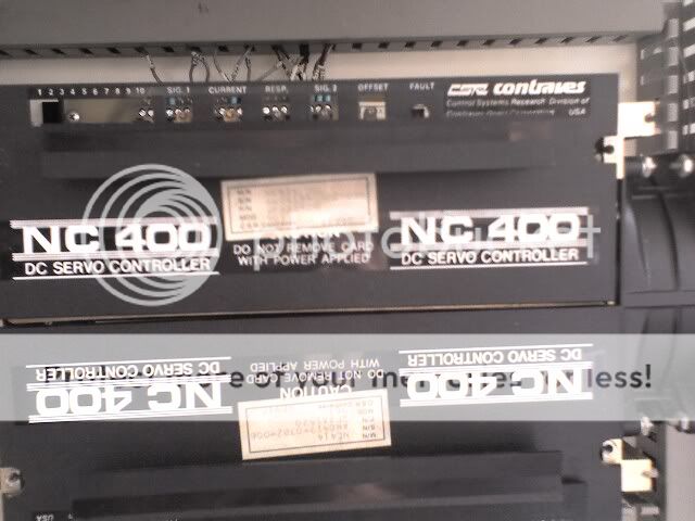

    one of the emc2 developers had this to say. (he has a bridgeport with nc400 drives that he hopes to convert to emc soon)
    cradek- skunkworks: yes, looks familiar
    cradek- they are velocity mode. I'm sure if
    cradek- we'd see a better picture of the motor we'd see a tach
    cradek- velocity mode + scales might just work as-is if tuned carefully
    cradek- you can see the screw terminals for the servo amp hookups. that's where to stick the mesa hardware... easy as pie.
    His comment about velocity mode amps and scales has to do with backlash. It is very hard to tune out (unless you get fancy) if there is backlash in the system with current mode amps. (just using scales as feedback to emc) But you have velocity mode amps that makes the whole system a bit more stable. (tach back to the drives) Atleast that is what we assume you have.

    Here are updated pictures of the motors and the servo boards.
    Jim
