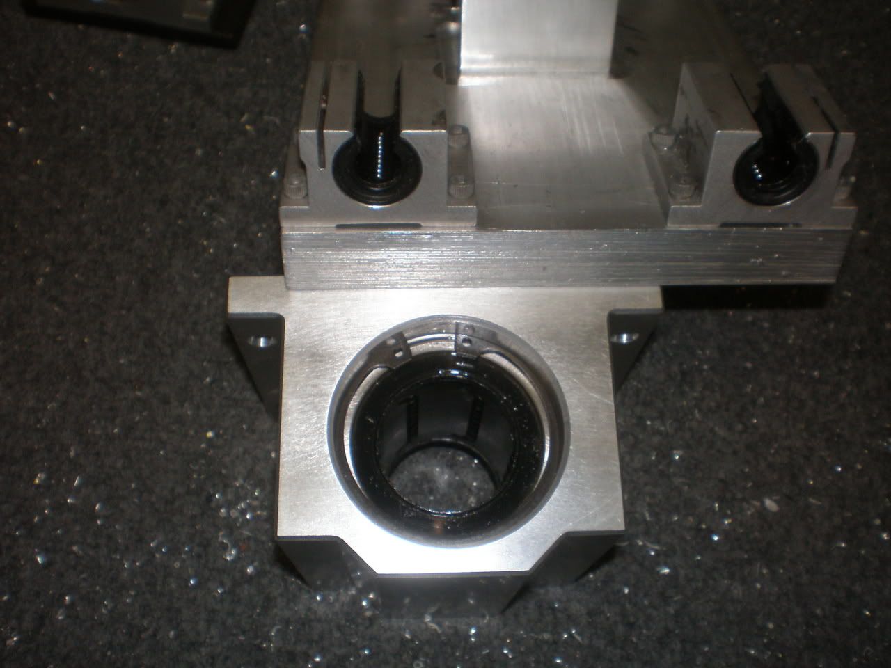

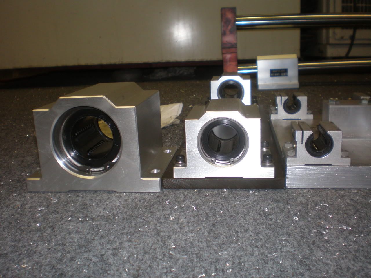

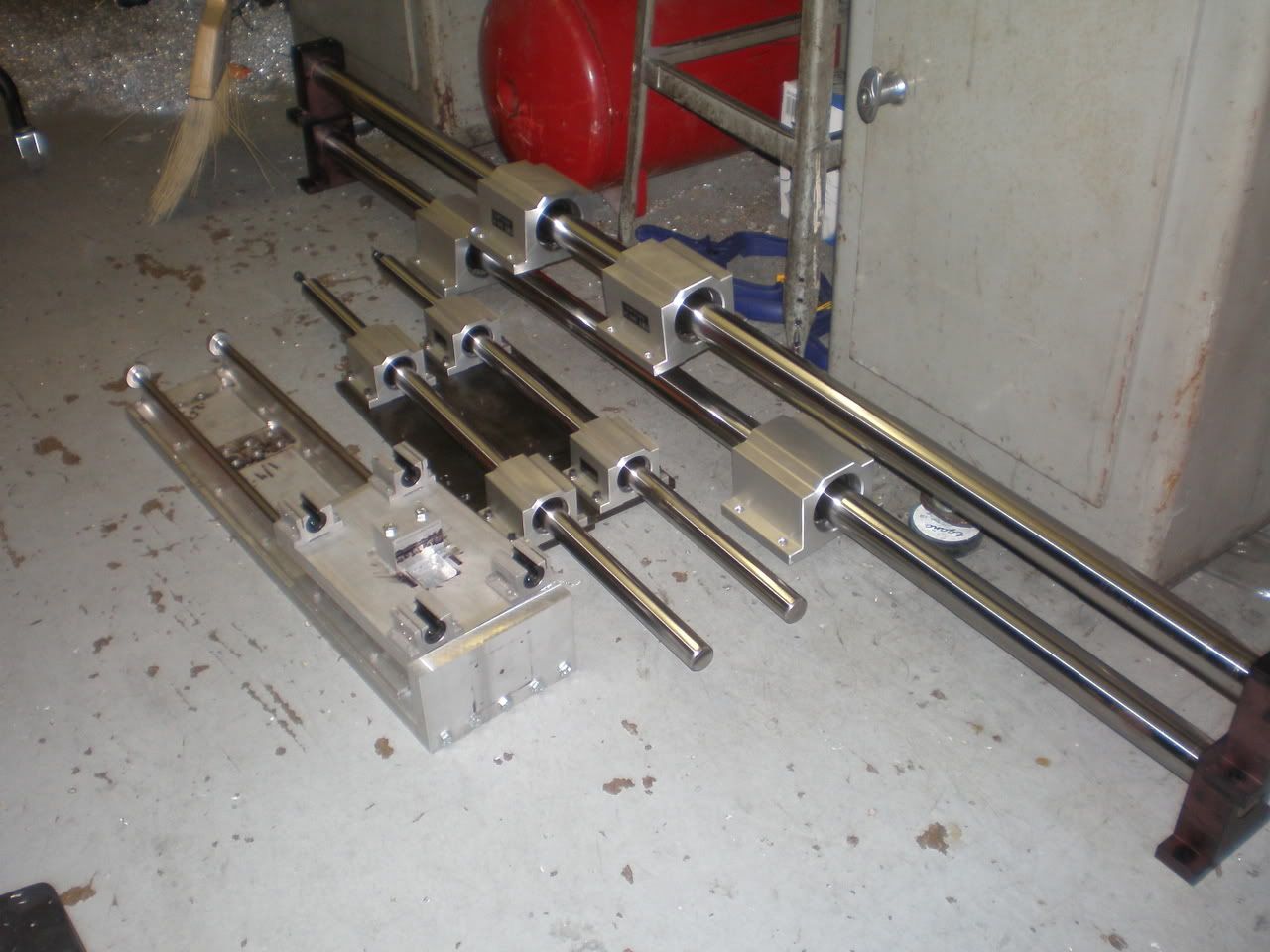

    1.5" unsupported linear rails.
    I picked up a pair of 1.5" NB linear rails 58" long.
    And 4 closed bearing blocks a while back for a great price.
    Now I am wanting to replace my semi supported 20mm rails with these larger ones.
    The unsupported distance is approximately 55" between the support blocks.
    I anticipate my gantry will weigh about 65 pounds complete.
    Does anyone have any experience with rails this large?
    If I can't use them unsupported then I will just have to forget about them and go back to the 20mm rails.
    But I really want to use them since the 20mm rails are being a pain to install straight.
    Here are some pictures to compare the 1.5" with my .5" z rails.
    The center ones are some 1" I got with the 1.5"
    Thanks,
    Joseph K.

    Static loading will cause the rails to flex downward about 8-10 thousandths when the carriage is in the center of its travel.

    Is that based on about 35 pounds at the center of each rail (70 for the pair)
    If so That doesn't sound very good.
    one option I was thinking about is to mount a bearing or wheel to the bottom of the bearing blocks.
    This would ride on the same face the rails are mounted to.
    And hopefully take out most of the sagging.
  7. #7
    Join Date
    May 2005
    Posts
    674
    My mistake, forgot to count two rails. The deflection is proportional to the weight, so with 35 pounds each rail (Z-axis assembly in the center of the gantry), deflection will be more like .004-.005. When the Z-axis assembly moves all the way to one side, one rail will deflect more than the other.
    I don't recommend adding a wheel to the bottom. First, your mounting surface is probably off by much more than .005". Second, it only compensates for deflection caused by gravity and does nothing for cutting forces.
