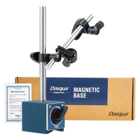

    Also what process do you use to tram your spindle head to your table?
    I just mount a DTI in the spindle and turn it, then tap the column towards the higher end. Trial and error. I use one of these to mount the DTI:
    http://lmscnc.com/3771
    You can also just make something to mount in a collet and hold the DTI. Maybe just use one of these bases with the magnet screwed off, and the shaft in a collet:
