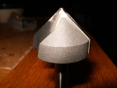

    Was excited to pick up my new Amana bits today at my local saw shop.
    On inspection I was immediately disappointed with the V bit. It's the 1in 90*, and I thought it would be a great replacement for my worn out Home Depot bit, the problem is it is not perfectly pointed at the tip.
    Forgive the ASCII art, and the photo will not show what I mean as well as I want, but the tip looks something like VV at the end. The result is 3/16" valley at the bottom of my V.. This means no square corners when V carving. My radius is limited to about 3/16, which is too much for me.

    The vbit was most likely dropped on its tip.

    As for 90 v carve, I found that even the cheap ones work pretty well on wood. I agree with the earlier poster, I bet the Amana v bit you got was dropped or something.
