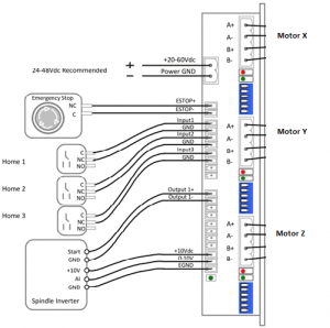

    Quote Originally Posted by Fastest1 View Post
    If it is a mechanical switch then whichever pair give you a closed circuit. Upon breaking contact Mach is triggered. Actually either way will work but this way if any wire breaks the system shuts down. Wired the other way, the machine just keeps going even if the switch goes bad. If it is an electrical switch then all 3 wires will be needed.
    "If the MX3660 is putting out 12v" Where are you measuring 12v? I suspect this circuit is 5v. If I understand this and your question correctly, you can use any voltage up to 24v. The higher voltage the more immune to noise the circuit will be. I believe the MX3660 or any controller is really just trying to detect the differential in voltages.
    They are the A60 from cnc4pc, 3 wire electrical switch. I guess They are a no go to power from the mx3660 given there is only 2 connections for each input (input# and GND).
    I measured the 12V at the connections on the mx3660 (Input 1 and GND) It even says 12V sourcing in the manual, Page 19. I tried to power one of the switches with a 5V wall plug PSU yesterday but still could not get a signal in mach. Not sure which switch I was using so that maybe some of the issue there.
    I think the next thing I'm going to try is putting the brown(+) and blue(-) on input 4's connectors and the black to input 1.
    Andrew

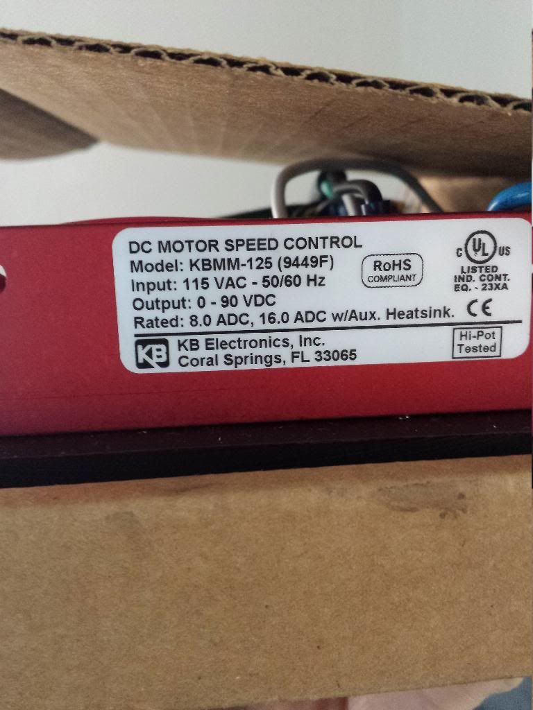

    Quote Originally Posted by lancut View Post
    Hi Andrew,
    On the first page you have posted pictures of your spindle motor/controller replacement. I was able to get the data from the picture of the treadmill motor label, and I presume this is the controller you went with > https://www.galco.com/buy/KB-Electro...MM-225D#bottom <. If so, did you try it to control the spindle by Mach3 or LinuxCNC successfully. Thanks.
    I got the same setup that Hoss is (maybe was?) using. so its a 1.75 hp continuous motor and a Kbmm-125 to control it with the 1.5 hp resister, (2) 25 amp fuses and the heatsink. He has all the links on his projects page. controller option #4
    Link
    As for mach control, I just started to really play with mach this last week. I may head to the basement once the kids are napping today to play with the spindle control settings. Still not sure if the MX3660 will supply the power or if I will need another PSU. Looking at the manual leads me to believe I will a 10V PSU as the kbmm-125 has no power output for this.
    Andrew

    Been doing some digging on how to connect my KBMM-125 to the MX3660. Since the Gecko G540 is a similar device thats where I started looking for info. After reading a few threads it looks like the G540 can be used to replace the potentiometer to control the KBMM-125. Since the wording seems simular in the two manuals (G540 & MX3660) I figured I'd give it a try.
    From the reading I gathered:
    • P1 is the +10VDC
    • P2 is 0-10V
    • P3 GND
    Went to go give it a whirl... nothing happens. Put the Potentiometer back on the KBMM-125 to test things out.
    I get:
    • P3 ~ P2 0V at WOT (volts go up as I slow it down)
    • P3 ~ P1 14V Constant
    So Either I'm missing something in the equation of wiring or its my mach setup. I have PWM checked and set to 50. Set the pulley to 1000 rpm max at a 1 ratio (My Belt drive is a 1:1 ratio and I read somewhere that 1000 is a good place to start for rpm setting)
    Theres got to be something in the potentiometer that makes it work, Or do I just have bad settings in Mach?
    Some day I hope to have the answers and not be the one always asking for help:tired:
