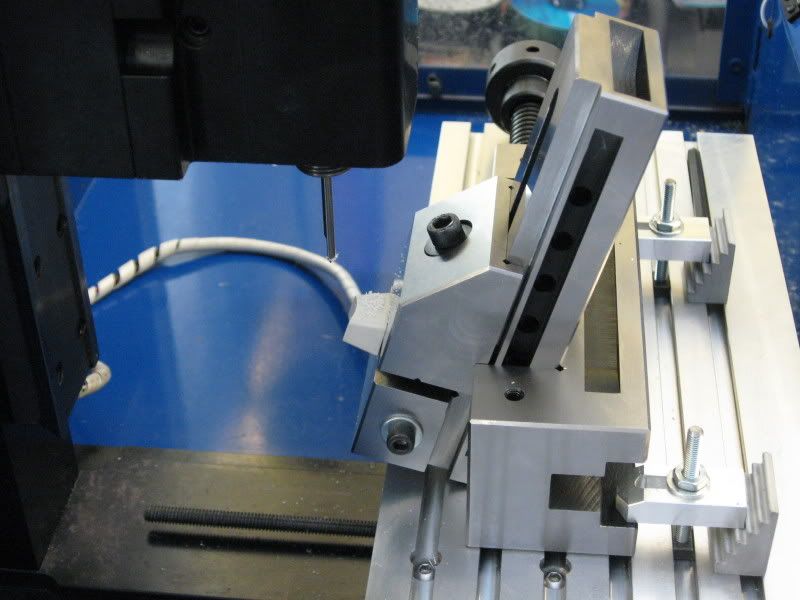

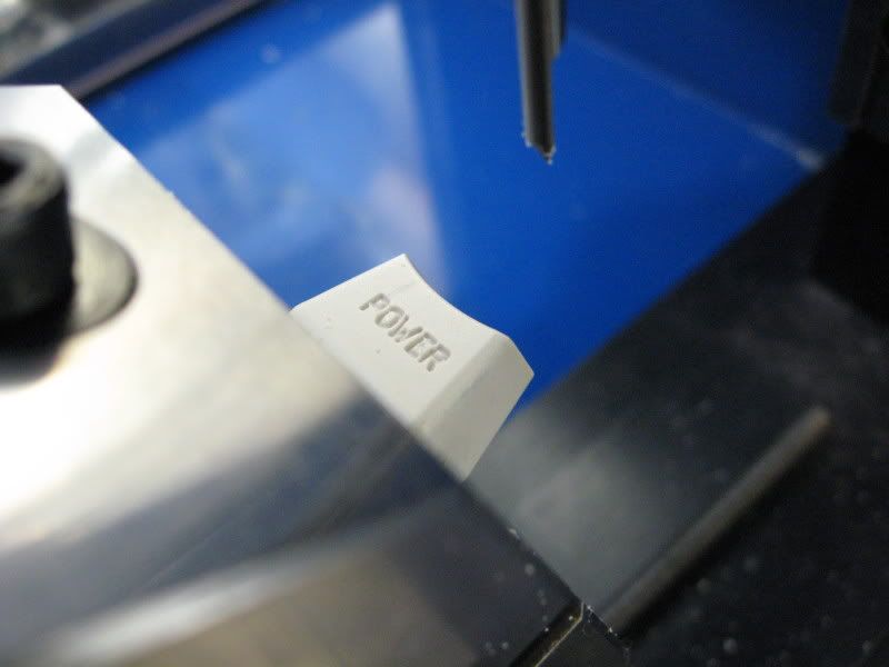

    Great tip, but I'm hoping for some key COMBINATION for homing...although, I suppose I could remove the Windows keys instead of the Home key, like I've currently done.
    Quote Originally Posted by cyclestart View Post
    Hey, my kind of user ! Makes what I'm about to suggest a little less embarrassing.
    Embarassing? Hey, I pulled off my keys and engraved them with the EMC function on their fronts!
    Filled in with differently-coloured crayons, they show up quite nicely.
